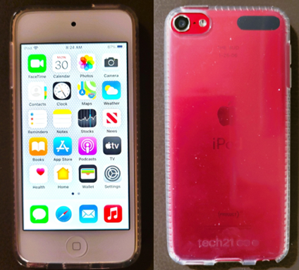

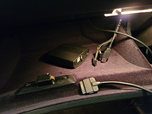

    An old Mediabridge Bluetooth unit and wire components. The big wide connector end is for my 2nd gen Ipod that holds plenty of music. It still works, it still has a life, but is a wire necessary unit to hook up to our household speakers if needed. But, the latest (Last Generation) Ipod takes that spot for the Bluetooth speakers to power the household sounds.
    Why? Well, the old unit used to sit in the glove box. Wires leading back to the radio. Then another wire came out to connect to the Ipod. But, you had to leave the glove box open and wire dangling. Or could reroute the wire under the dash and connect to your old Ipod.
    Jnaki
    All of that is moot, now. Not all Ipods have Bluetooth power. So a third gen Ipod started the Bluetooth revolution. Now, that the latest Ipod is no longer in production, it holds a ton of music and has the power of the latest powerful Iphone. But, if you have one or can get one, use it in conjunction with a new, Bluetooth radio head unit.
    It makes life easier. My newest Ipod and my wife’s Iphone have all of the music from our old music files. But, the odd thing is, we talk and drive, not listen to music when we are together. But, at least, it is wireless transfers...
    The Ipod sits in your hand wirelessly or in your p***enger’s hand for pure music if and when you want it. For teens, their Iphones all have Bluetooth and they can also hook up to the car’s radio head unit wirelessly. Keep them happy and learn a song or two. YRMV
    The last generation of Ipod Touch units from Apple. Free music, wirelessly without any h***les.

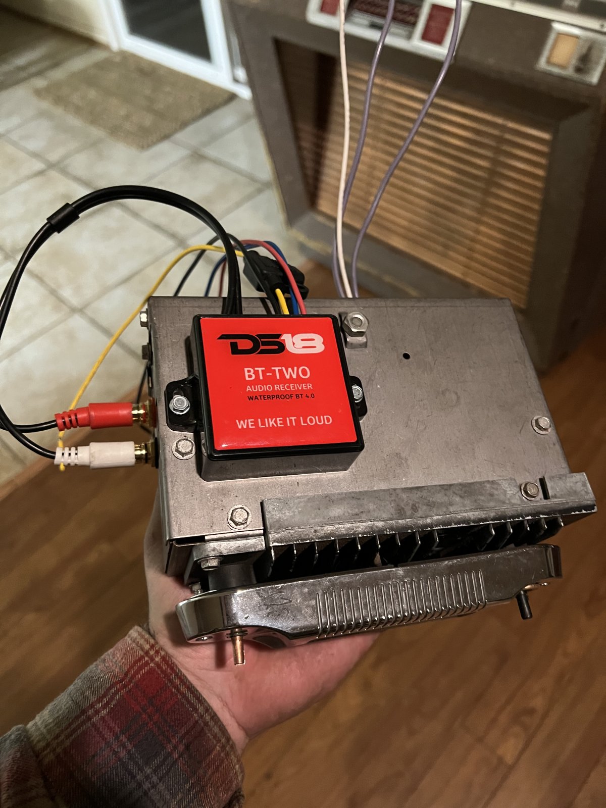

    So this is what I've come up with. It is still untested, but I don't see why it shouldn't work. As I've stated before, I know next to nothing about audio, so if someone more knowledgeable sees an issue, please let me know.
    My goal was to have the bluetooth version of the original post on this thread. I wanted a dash mounted volume knob, with bluetooth connectivity, and nothing modern on the dash.
    After my post #429 on this thread, @Woogeroo sent me this thread from the '67-'72 chevy truck forum.
    https://redirect.viglink.com/?format=go&jsonp=vglnk_167012101972910&key=3ddbb42d66675f20d3a5103dae5d4319&libId=lb8qwccx010025g1000DL4k0mbktm&loc=https://www.jalopyjournal.com/forum/conversations/radio-stuff.5647151/&v=1&out=https://67-72chevytrucks.com/vboard/showthread.php?t=229621&ref=https://www.jalopyjournal.com/forum/conversations/&***le=radio stuff | The H.A.M.B.&txt=https://67-72chevytrucks.com/vboard/showthread.php?t=229621
    I found this thread very interesting. He went through alot of work to do that and still had a modern faceplate visible in the truck which confused me, but I thought the basic idea was great, and was adaptable to what I wanted to do. I wanted to be able to avoid replacing all the guts in the potentiometers if possible, so I started looking around. I was able to locate a 1M ohm dual pot logarithmic potentiometer with an on/off switch.
    So, that saved me the time and trouble of degutting and regutting the pots.
    time to get to work.

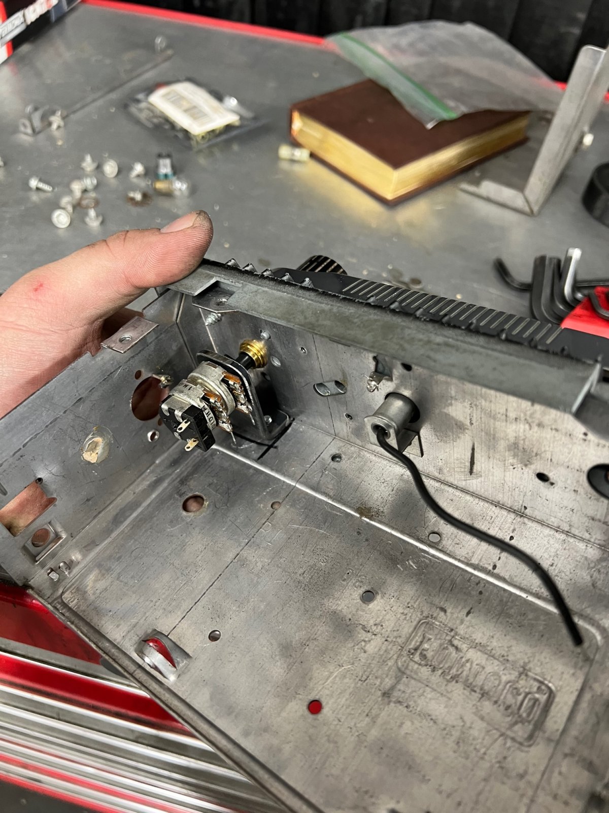

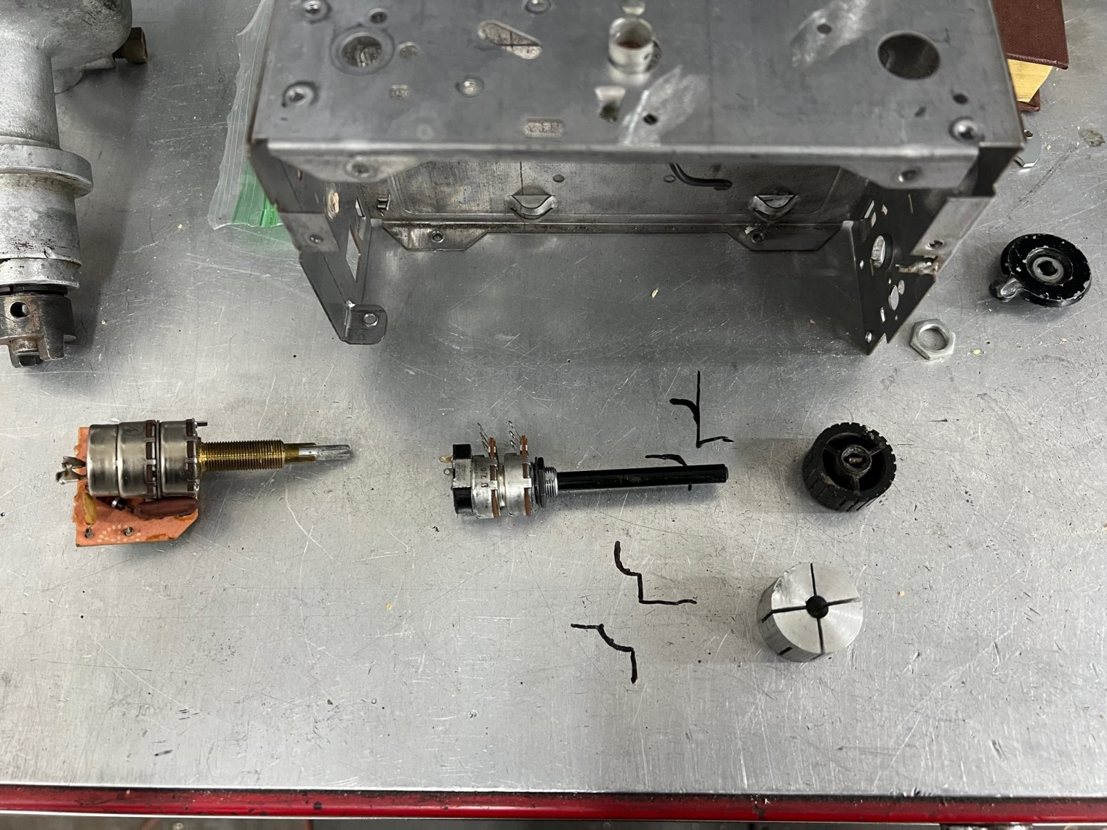

    I gutted the factory radio, and started taking measurements for fitting the factory knob to the new dual pot volume control.
    Here is the new pot on the right compared to the old on the left.

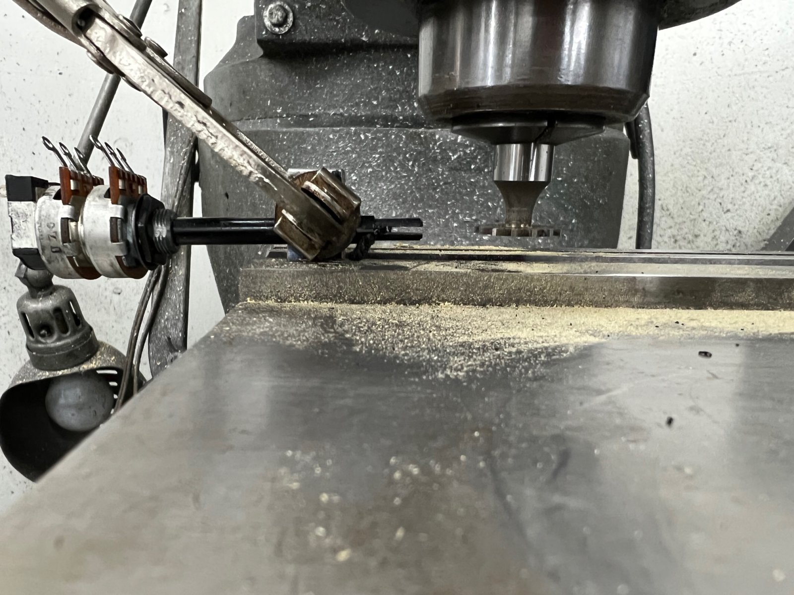

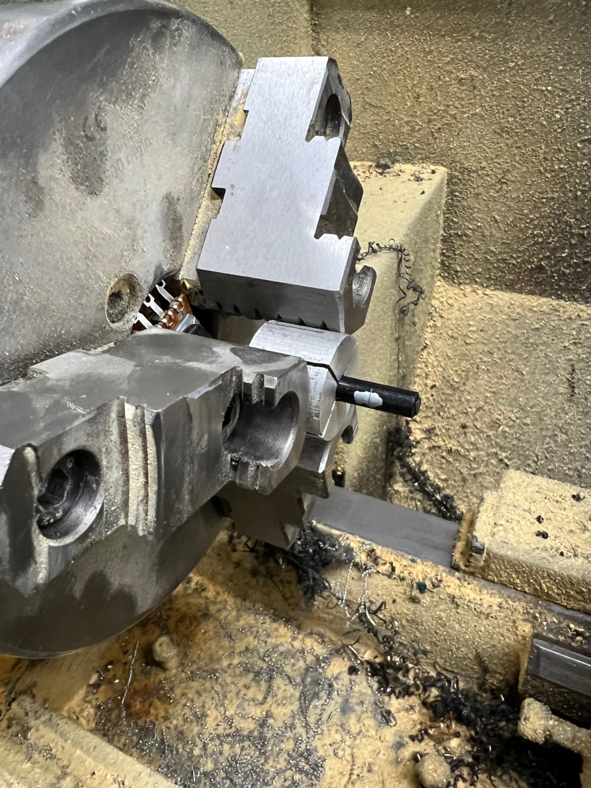

    I had to turn down the diameter of the new pot, so that was the first step.
    The hardest part of that was to make a cut through the center of the shaft to fit the knob and keep the knob from just spinning on the shaft. I was a little concerned that the new shaft is plastic and would be too weak, but the turning force is pretty effortless, so I think it'll be alright. I first just made the cut with a hacksaw blade, but it was way too narrow. I then remembered we had some key-way cutters. One happened to be the right width. So, I rigged something up to cut it. It was pretty a pretty sketchy set-up, but just for plastic, and worked out well.
    I checked knob fitment.

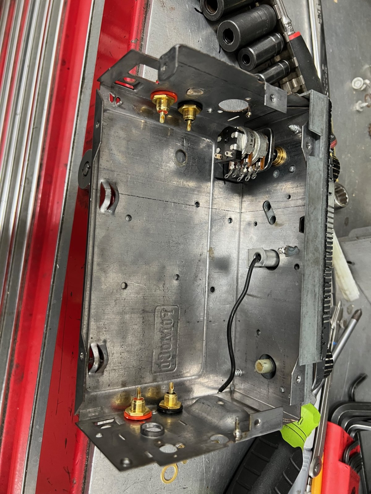

    Then I ***embled the radio to figure out where I needed to mount the new pot, and made a little "L" bracket to mount it.
    I then installed RCA's on either side of the radio case.
    I wired the pots between the RCA's, wired the power switch wires, and extended the light wire.
    (the purple wire was free. Haha)
    I then mounted the bluetooth receiver. I wanted to mount the receiver inside the case for a tidy package, but was concerned the case would interfere with signals, so I mounted it on the bottom of the case. (Obviously, that means this photo is with the radio upside down.)
    Plugged the bluetooth receiver into the one side of the radio, installed a grommet for the wires to come out of the case, ran the wires and ***embled the case. For the purple wires out of the case, one goes to power, and the other goes to red on the receiver. The white wire is the radio light. I will connect that to go on with gauge lights.
    Then, for the remaining receiver wires, yellow is constant power, black is ground, and blue is remote to turn on the amp.
    This is the complete radio. I made a modification for the adjustment behind the volume knob to be there too, so it will look like a completely factory radio, and even though it doesn't do anything, the tune knob still moves the indicator.
