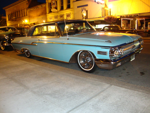

How much do you want to lower it? Like scrap metal 48 said, you can cut coils and install lowering blocks. Up front, you could also install Ford Granada spindles (1 to 1-1/2" drop + you gain disc brakes), aftermarket dropped spindles, or airbags. Out back, you can do a number of things, from just lowering blocks to a full 4-link airbag setup. You could also remove a leaf, add lowering blocks and 'helper' airbags. This is what I did on my '62 Galaxie. Lots of options! Malcolm
