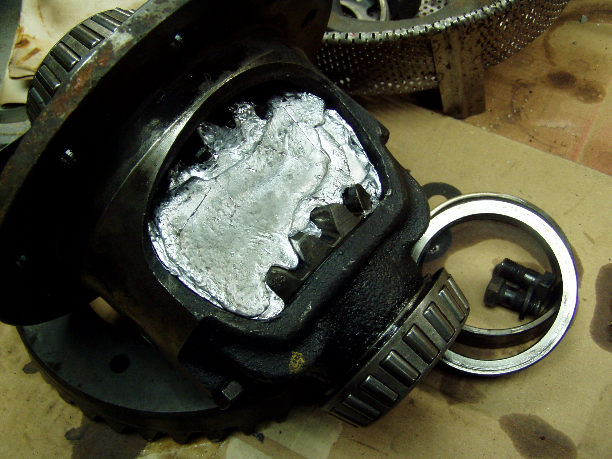

    A fellow on here would fill the carrier with lead, non destructive.

  24. saltflats
    Joined: Aug 14, 2007
    Posts: 13,699
    saltflats
    from Missouri
    Boneyard51, 427 sleeper and Budget36 like this.

    What the heck was used for that?

  27. saltflats
    Posts: 13,699
    saltflats
    from Missouri
    Poor man racing. ;)
    Boneyard51 likes this.
