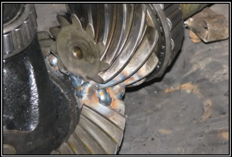

    I have done the extra shim behind side gear poor man posi on a 8.2 ten bolt, ford 9 inch and currently in my 63 pontiac which I have yet to drive. The 8.2 blew normal gear lube out of vent so i refilled with posi lube and all was good. Ran 12.50 with that for part of a season with no problems. Ford rear end went a few seasons running mid elevens with a sub 1.50 sixty foot by the time it started to slip I was tired of replacing 28 spline axles and could afford a spool and 35 spline axles. All were street driven so I thought I may as well try it with a big Pontiac

    Just remembered that shot peening the shim and the shim surface of side gear works as well so I've been told.

    Let’s lock this thread before we get any further down the rabbit hole of locked rears on the street. Yes, of course we are talking about street only here. I won’t argue on the internet. I’ll just tell you about my friend in high school that welded his spider gears, then went out and ruined a nice car, almost got himself and a carload of kids killed. Bad idea. End of story.

    Did this a couple of times. Just make sure to get ALL of the grease and oil out of the carrier before pouring molten lead into it. Wrap the carrier with a steel can or s**** of sheet metal, held on with hose clamps, remembering to leave one side open, warm it up to 350-400 degrees and melt a bunch of old school tire weights in a plumbers pot.
    Pour the molten lead into the carrier completely filling it up. Then go drink a couple cold ones and wait for everything to cool. If it's filled correctly it'll be locked up, but with a little cushioning effect.
    Not for the street IMHO but oval track or drag racing...

    That's from the early 70's. I don't have pictures. The lead is only in the carrier where the differential gears are. Oh and you have to keep the lead out of the side gears so the axles will slide in, unless you can figure out how to get the lead in with the rear all together. I did it to a 57 Chevy rear, and that's how I learned what happens if there's any grease or oil in the carrier...

  24. kids in high school usually can't drive very well, especially when not used to the car they are driving. A proper Locker, will behave completely differently to that of a welded diff. If done properly, welded gears aren't that dangerous, as long as you know what to expect.
