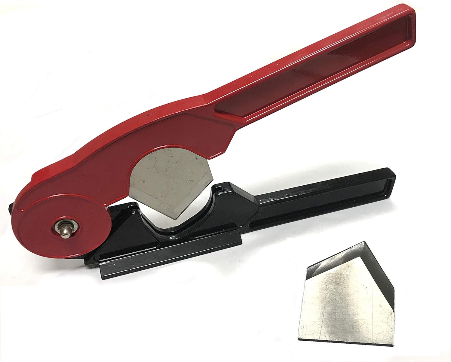

  6. I bought both of these used decades ago.
    Small hoses:
    Large ones:

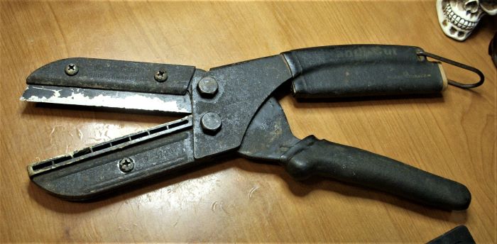

    I've got an old Craftsman Handi-Cut, with a very dull, nicked, original blade and a fresh spare in the handle, that I use for fuel/vac/PCV hose. I need to give it some love because as dull as it is, it's close but not quite square.
    But for big stuff like radiator hose, all I have is a Stanly knife and I have tended to get cuts that looked like a beaver chewed it off.

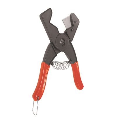

  17. Yup, a bandsaw works well. I use a razor type hose cutter for smaller diameter hose, but only up to about 1 inch.
