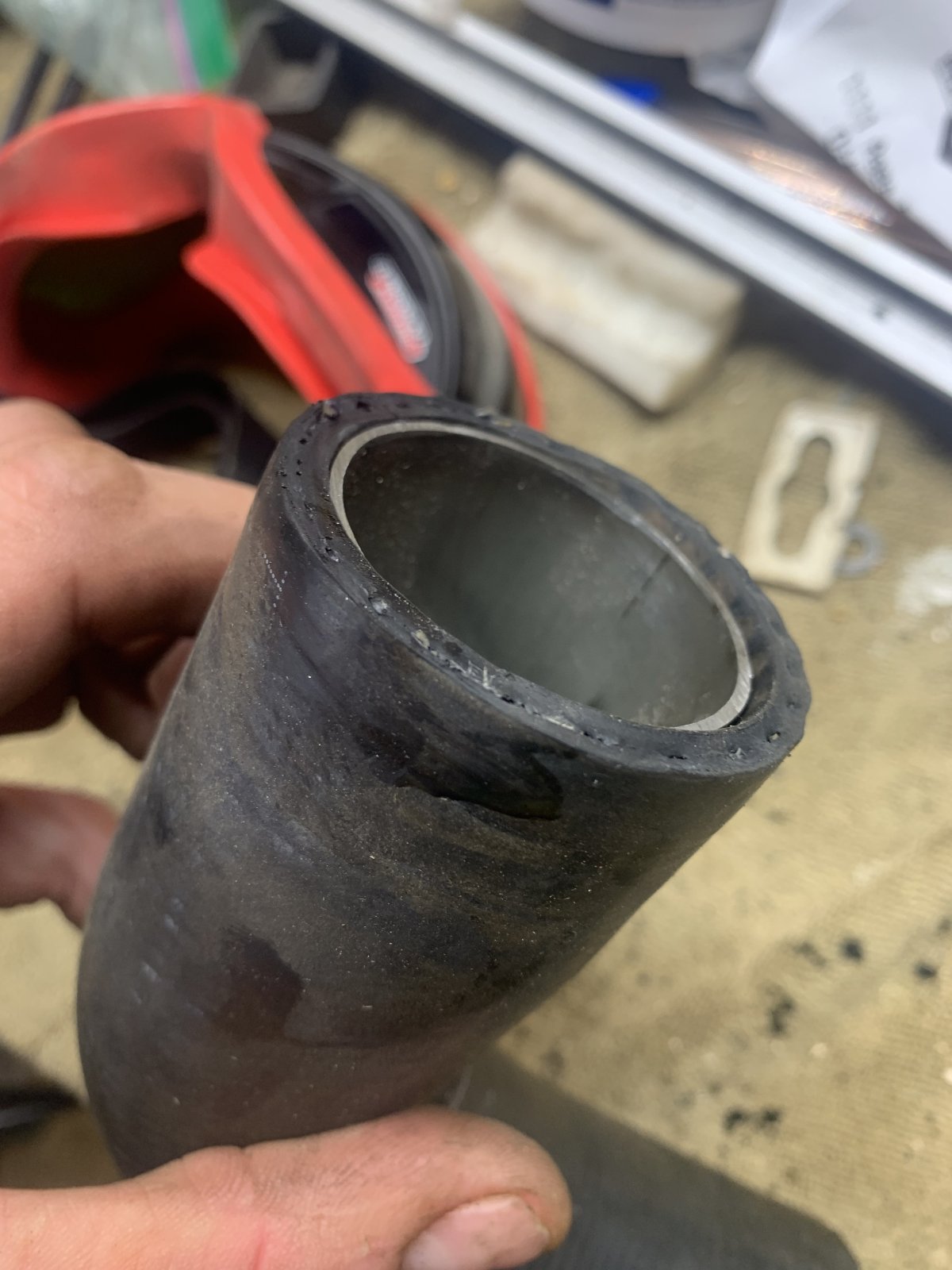

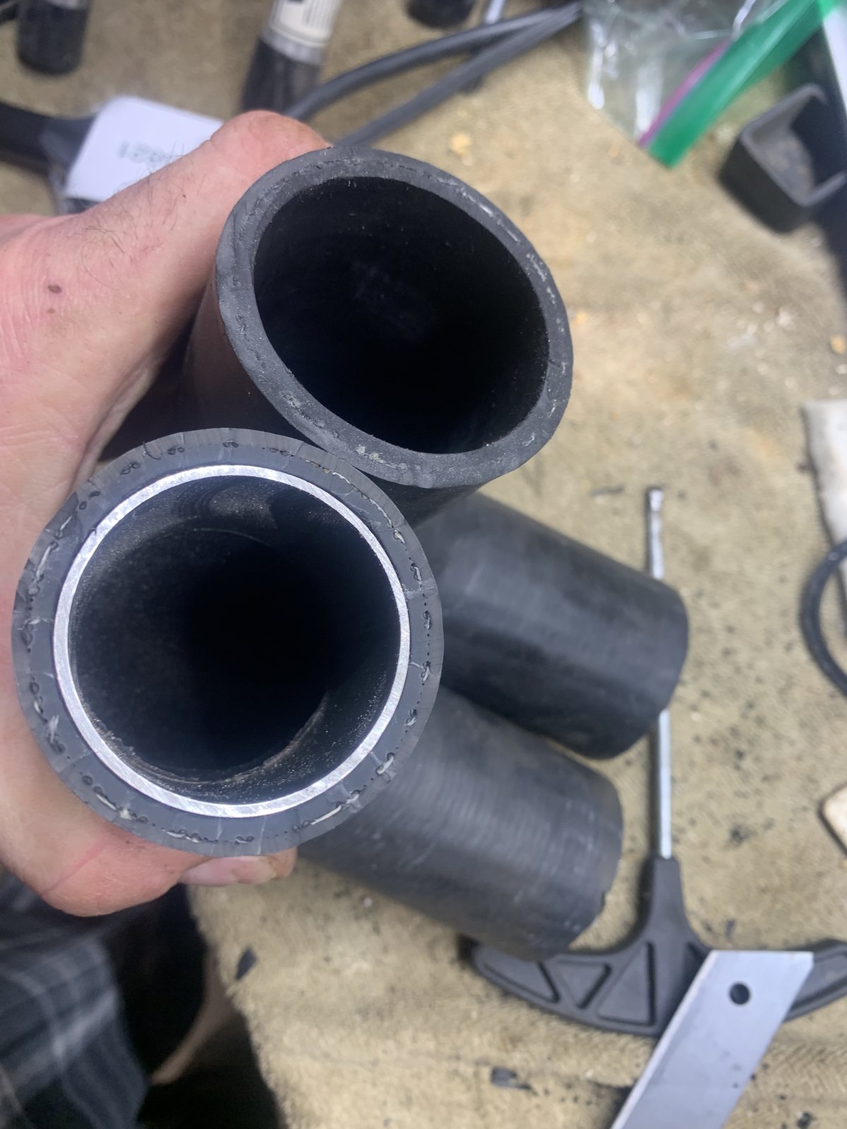

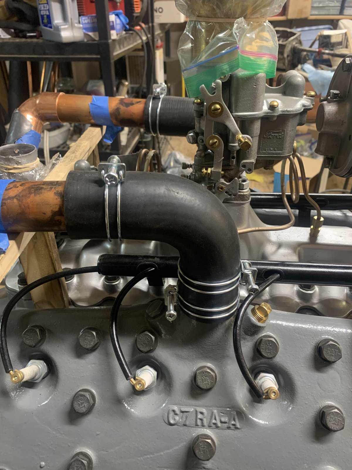

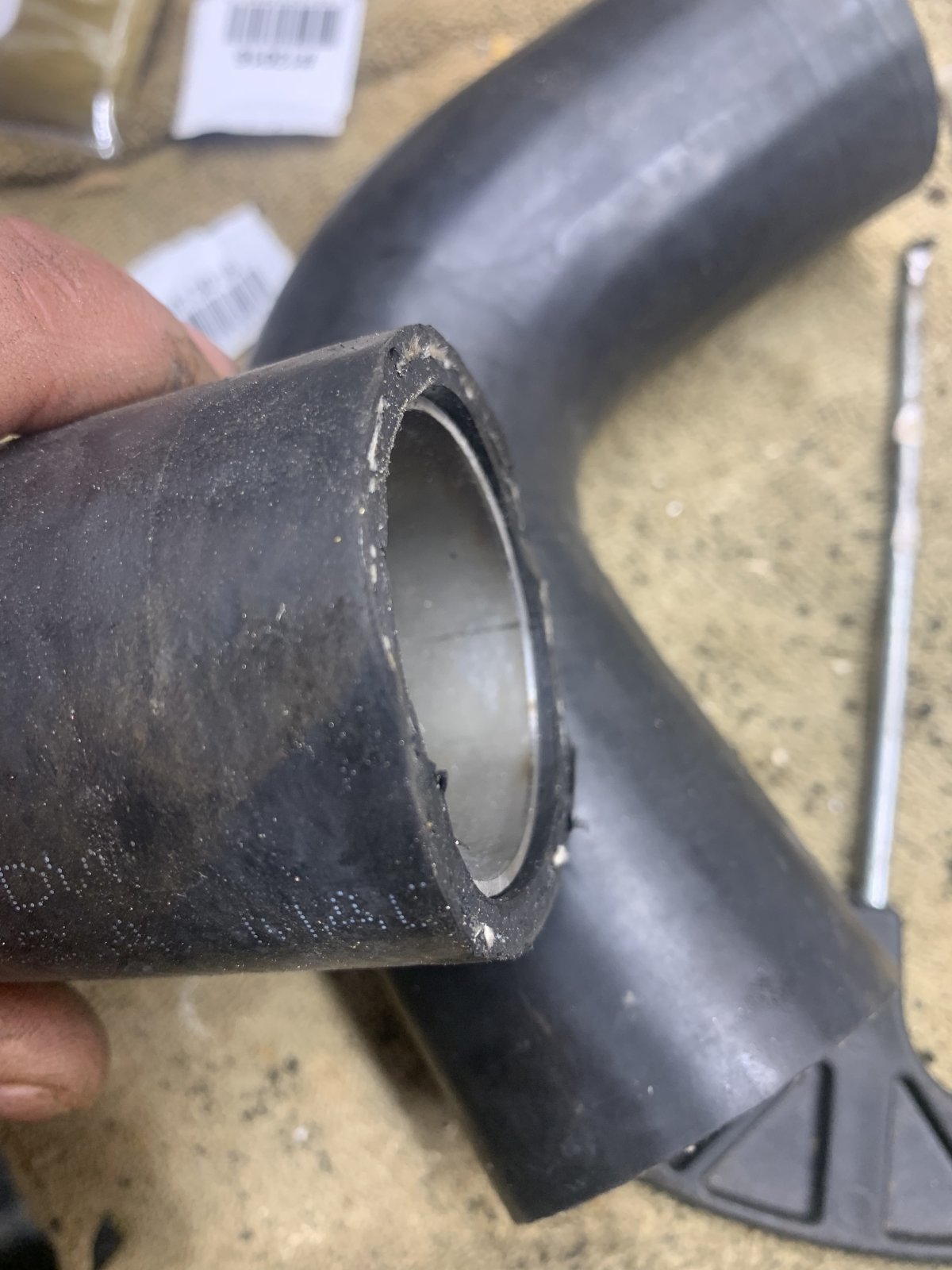

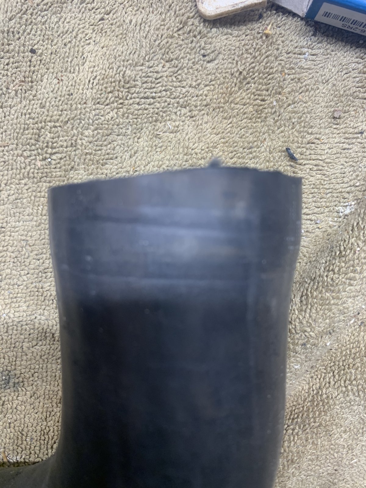

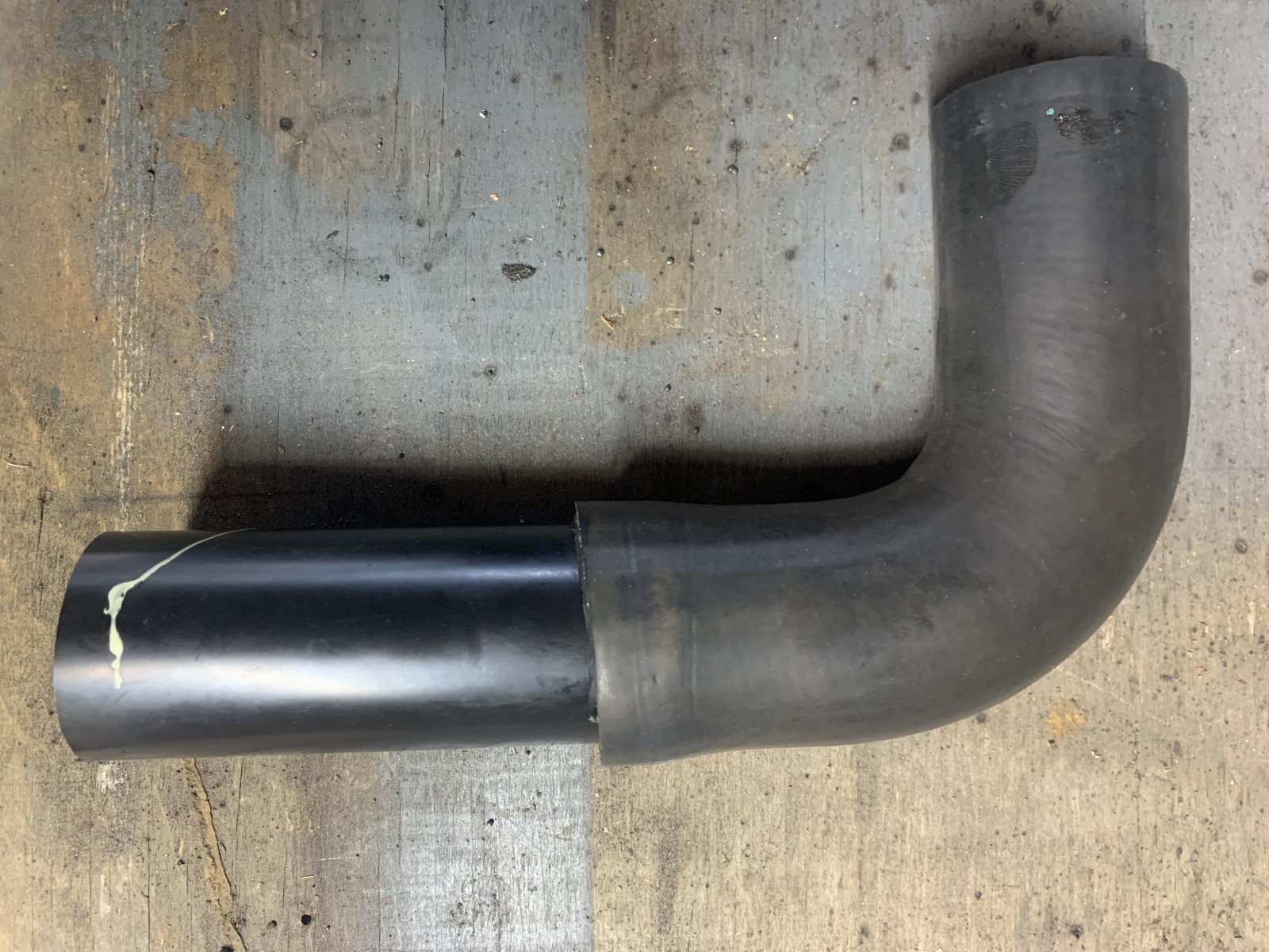

    Came across this thread yesterday after wondering how to cut snd trim some pieces of Gates 90 degree elbows for my speedster project. I actually came across the vid posted in this thread before finding this. Made me laugh. Of course all 5 of the elbows I purchased were different, and none of the ends were cut square. After reading some suggestions here, I tried cutting one with my Bosch mitre saw with a s**** piece of PVC stuck inside. Came out not too bad, but not perfect either in terms of being even or square, but good enough for 99% of regular stuff. However, for me with the never ending pursuit of the opposite of perfection is the enemy of good enough, I had to do better. So, again using some ideas I found here, I placed a s**** piece of SS tubing inside the elbow of the freshly made cut. It fit perfectly as opposed to the PVC pipe which was a little too big. I then used it as a guide to trim with an OLFA 1” blade. Now at least, it was almost perfect, but not quite. Next was sanding it on some 220 grit paper by hand, then I thought of using my 6” disc sander. The paper on the disc sander was pretty much done, so I didn’t care. All this was done with the SS tube still in place. Totally over the top with all this nonsense, but I wanted the elbows to match as best as possible on my flathead engine for aesthetic and for practical reasons.

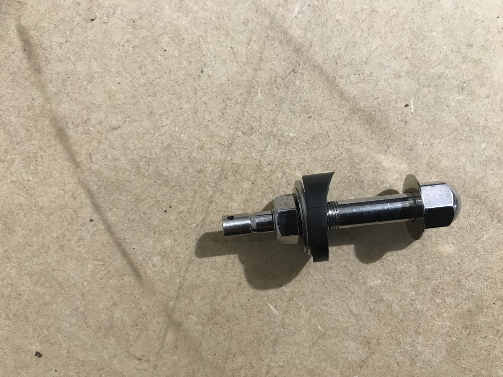

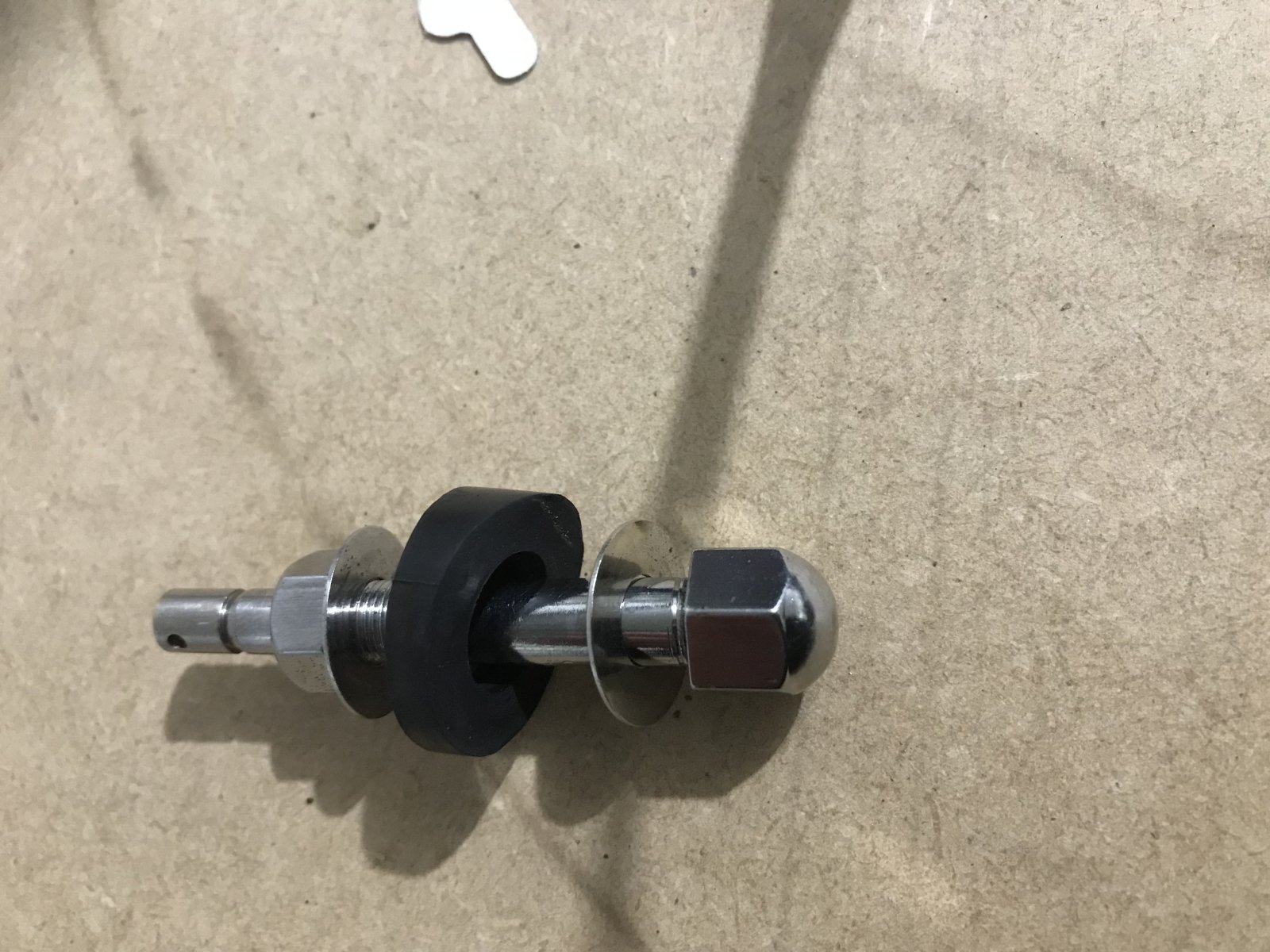

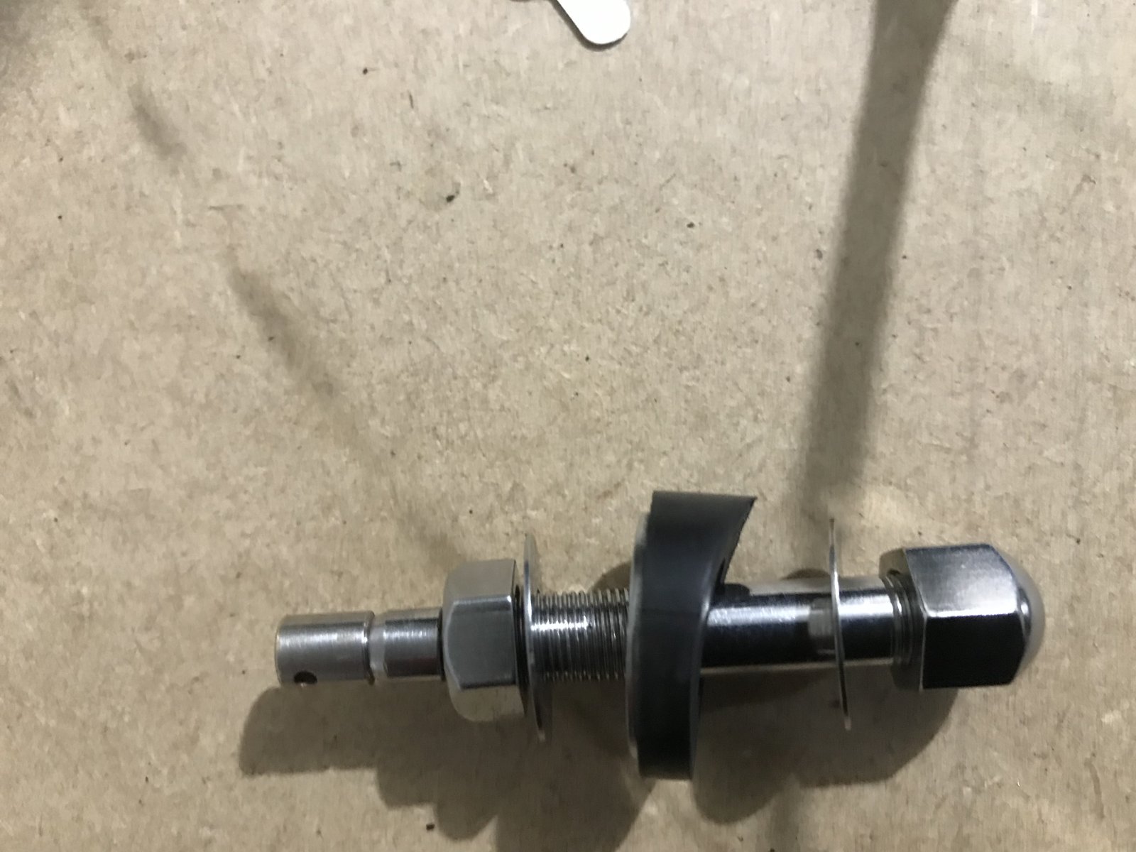

    I recently made some round rubber washers by using a leather punch for the hole and then placed the rubber between two steel washers and trimmed to the edge of the steel.

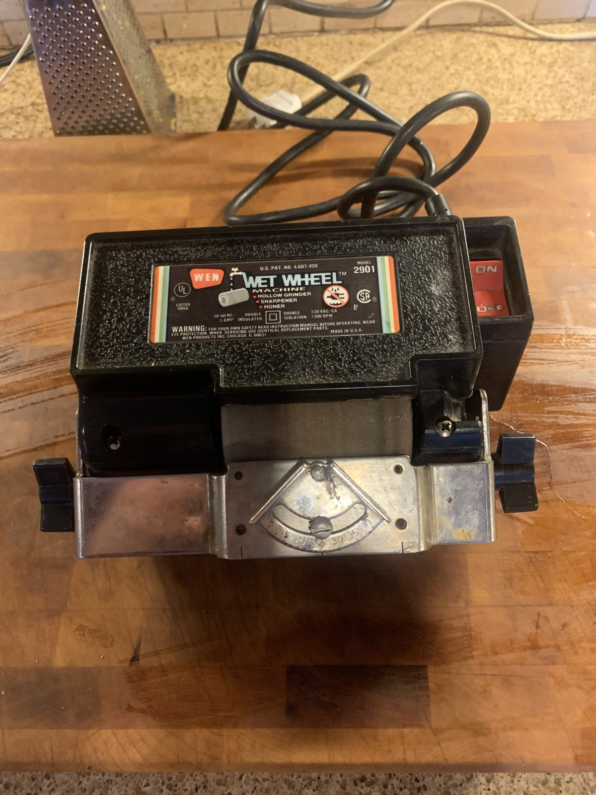

    I should have mentioned that I picked up this vintage WEN sharpening tool a month or two ago at Value Village for CAN$14. It was missing the foam wick, but I just cut some from an unused round foam paint brush I had lying around.
    It sharpens knives, scissors, and used utility blades like no bodies business. I took a few used OLFA blades which were essentially useless, and brought them back to life. Being as expensive as they are now (OLFA blades), I would suggest tracking one of these units down for anyone looking to keep things razor sharp.
