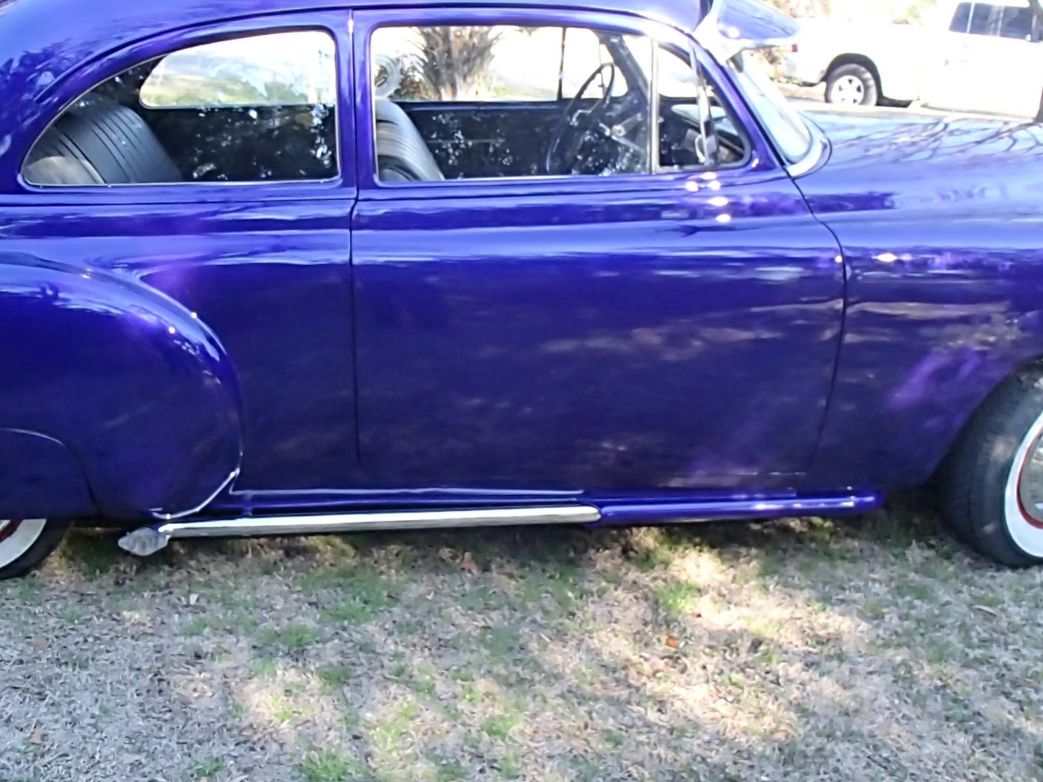

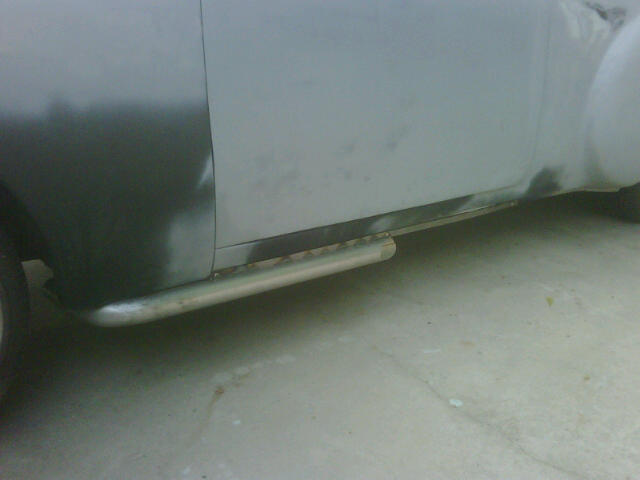

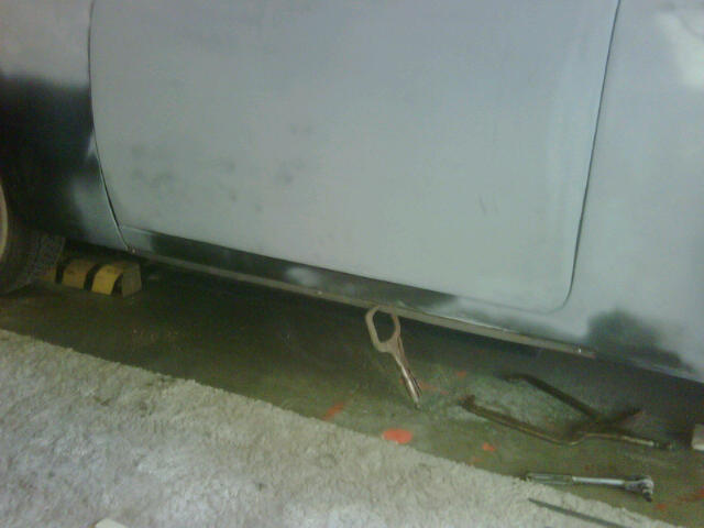

    Not sure if mine are liked or appreciaed?I did mine to get the look, but they are still removable on the 52. I have 2.5" tube bent in a 90 degree. I slash cut the pipe and welded round stock to the end and blended in. I did weld a tab at the front of the pipe so that it bolts to the inner front fender cross brace. I welded flat stock to the lakes pipe that runs the length of the rocker. I also flush welded (4) 1/4" bolts that hold the lakes pipes to the car and bolt through the bottom 1/2 body fold under the rocker. I then ordered the chrome lakes pipe, cut to length, the just slipped inside the Faux molded pipe.
