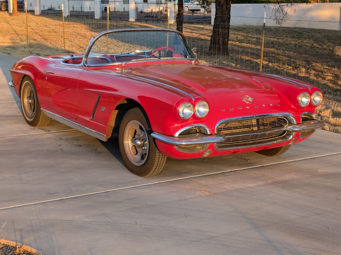

    Have you considered using different style wheels, front and back? Like we did in the old days, when we could only afford to buy two wheels at a time? For example, I have aluminum slots on the front of my Corvette, with Cragar G/Ts out back.
