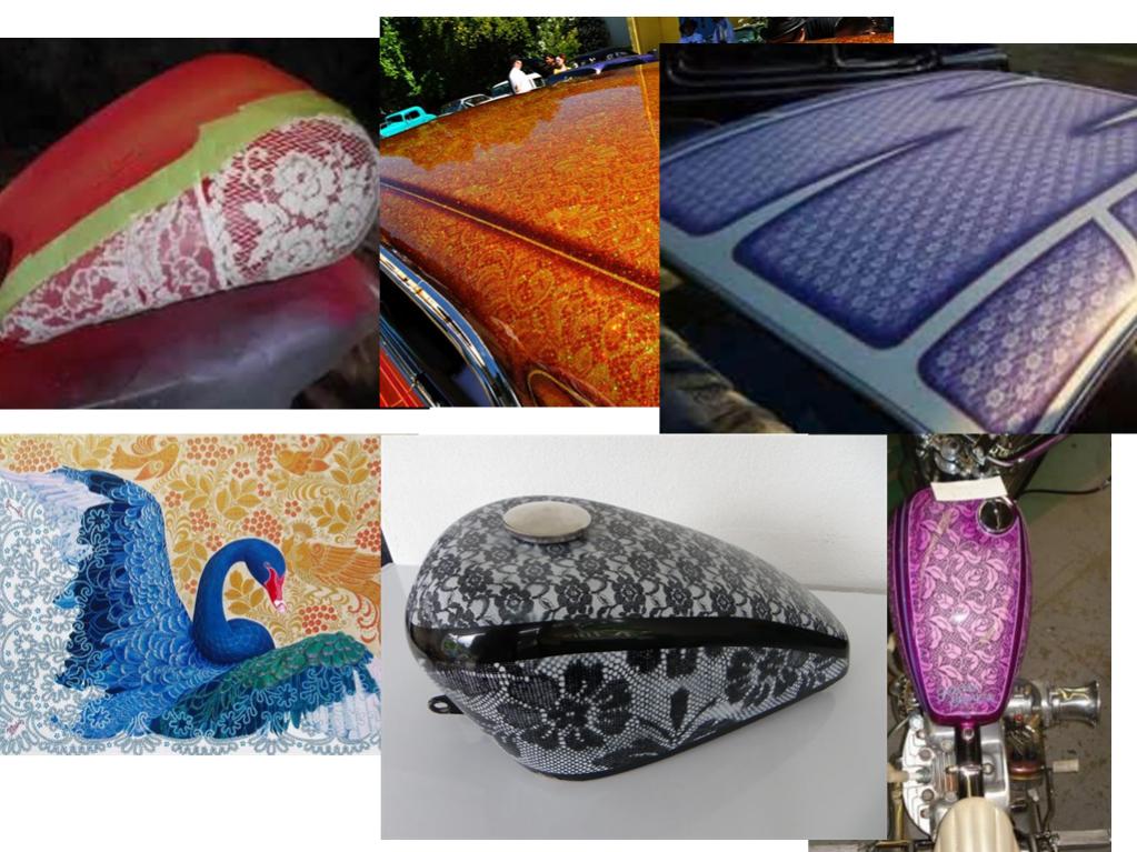

    I've just started lacing my car. I just went to the local material store and got lace curtains. Make sure the surface is clean.

    You can also find paper lace at party supply stores, ,I think I would like to use those if I was doing a car top or hood or trunk in panels ,Two Bike tanks I have done with good effect and results. Tnomoldw
