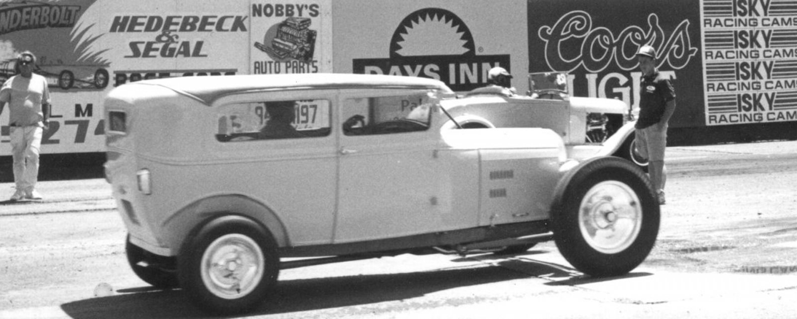

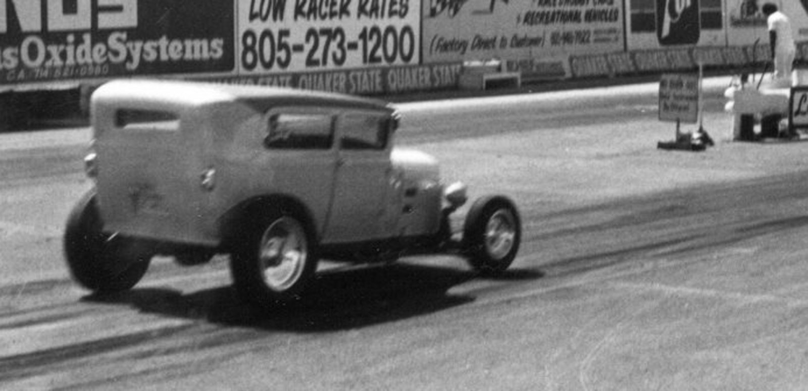

    2nd Run . . .
    (Your results may vary.)
    Plus it's hard to steer off the course with so much caster.

    I’m confused. Need more info.

    The tire change would lower the effective gear ratio quite a bit.

    They swapped the front short wheels & tires for the back's taller wheels and tires. This change improved the usability of the rear ends gearing.

    "So what were your times?"
    As I remember, we had good times back then.
    The sedan went from 18 to 17 with the powerful Buick V-6.
    (My licensed Street Roadster was my race car -- 210 plus at Bonneville.)

    Two things are happening here.
    The first - as - kevinrevin pointed out is the smaller tires on the rear give a better effective gear ratio to enable the engine to rev quicker. On my avatar car I switched from a 12 x 32 slick to a 10.5 x 28 rear slick and picked up .05 in the sixty foot and .10 in the eighth.
    The second thing is the larger tires on the front gives you a greater roll-out on the starting line beams which are 3 inches off the asphalt.
    The car is staged when the front leading edge of the front tire breaks the staged beam.
    The timer starts when the rear trailing edge or the front tire clears the stage beam.
    The more distance there is between the leading edge and the trailing edge the greater "running start" you get at starting the clocks. A bigger front tire yields a bigger running start.
