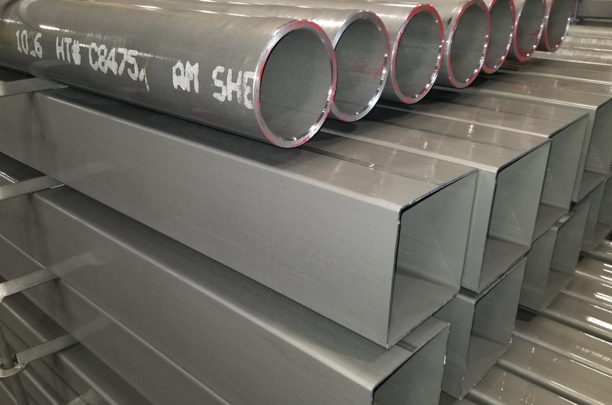

  13. Next time ,,,,
    Get the tubing “pickled and oiled” if you don’t want the mill scale.

  20. Pickled and oiled
    You could also ask for the material to be wheel abraded or shot blasted. That’s nice stuff too. - for the next time. Saves a lot of bullshit time consuming messy dusty potential dangerous acid adventures in your shop

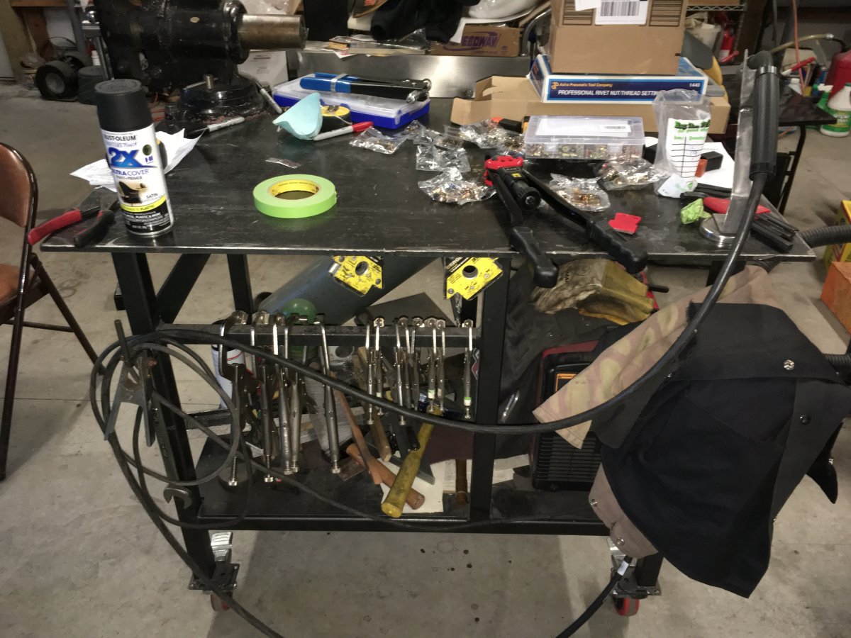

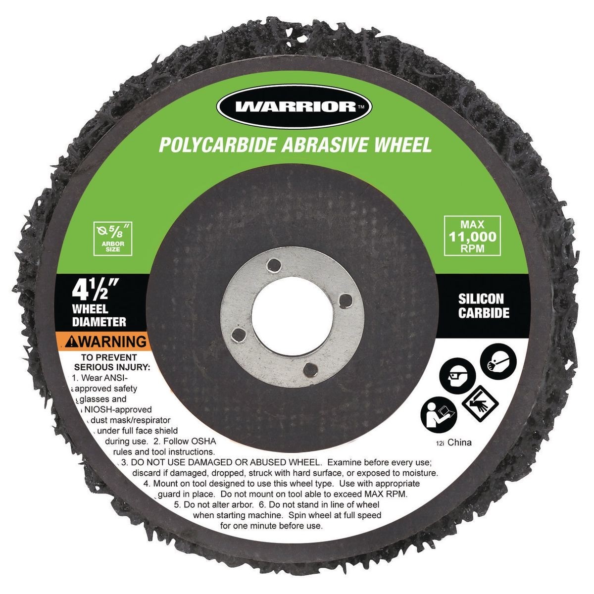

    For my welding table I left the mill scale on the top and ground the mill scale off the rest of the structure and painted it (not the top). I used a polycarbonate disk to remove the mill scale - it works great for that and it doesn’t eat into the metal like a flap wheel will. I painted it with Rustoleum hammer finish paint.
    Looks great, works great. Try it.
