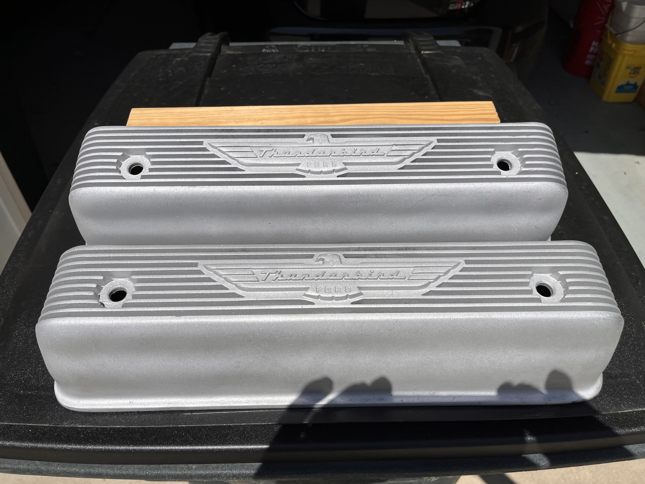

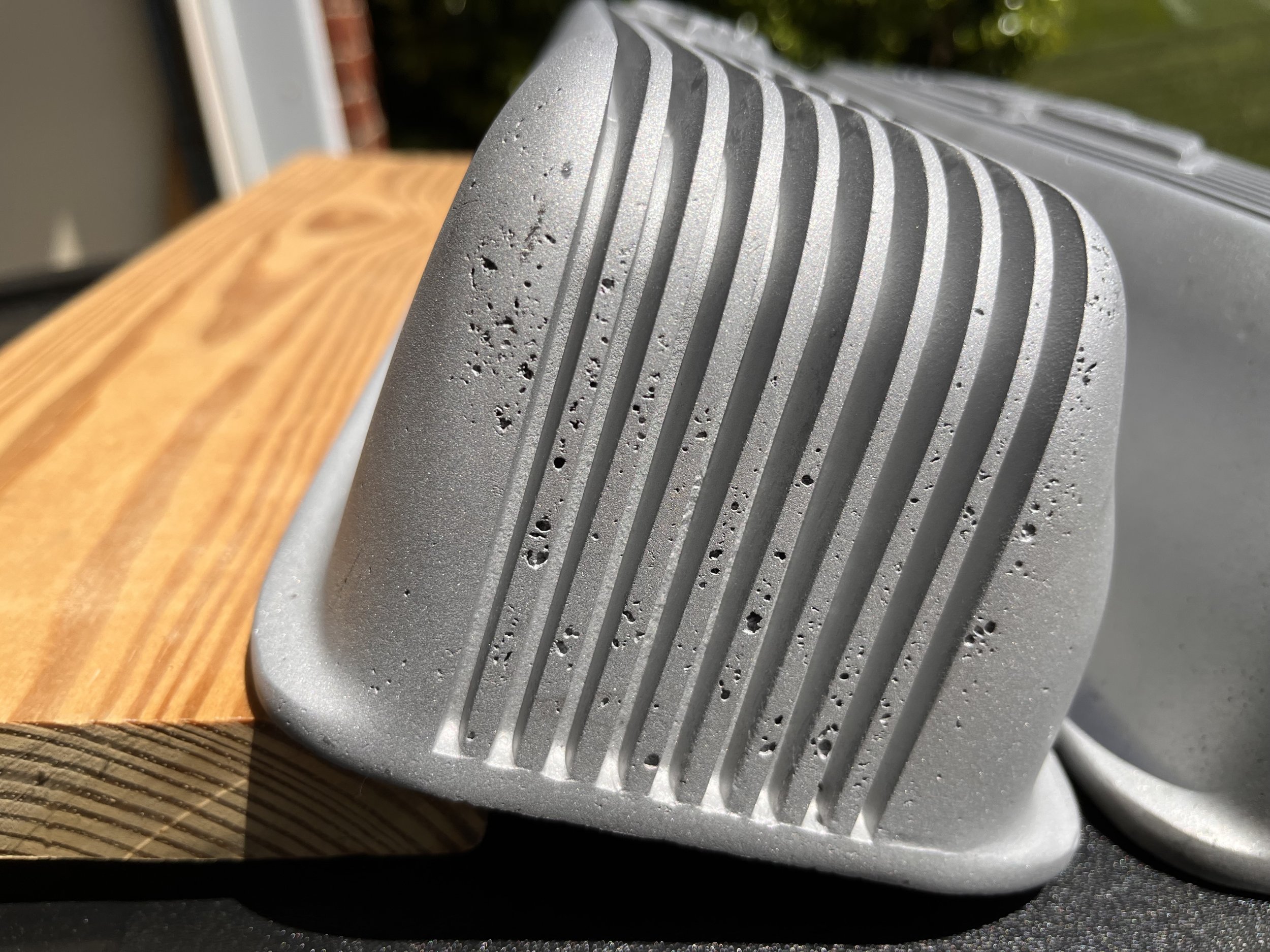

    I have a pair of original ‘55 T-Bird valve covers. I had them bead blasted prior to polishing. They came back with some pin holes that I need to get rid of before starting to polish them. What’s the best way to proceed?

    There’s no getting rid of those oxidation pits that deep or numerous without serious material removal. Deep.
    I’d polish those as is and call it a day.
    What level of polishing are you aiming for?
    Some shiny or show polished?

    Those pits are caused by what is known in the casting world as "sand inclusion". As the molten metal is traveling across the mold it picks up loose sand and it ends up at the far end of the cavity where it has nowhere to go.

    I think the pits on the ribs will go away with enough sanding. Most of the pits on the corners will also come out. It just comes down to how much effort you want to put into them. I have cleaned up many of my own castings this way however some pits get bigger the more you sand.

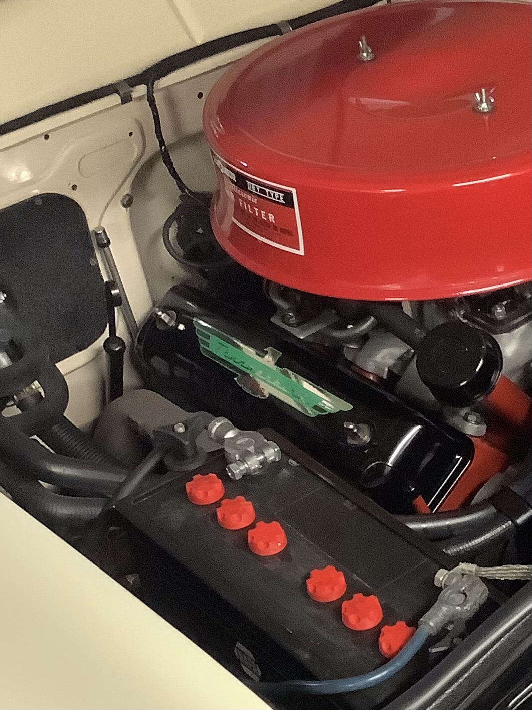

    Sign of the times in 1955. Fords motto how many, how fast, lowest cost…I had an original set on our 56 Victoria and replaced them with stamped steel with Thunderbird only decals not available on any full sized cars or trucks. (if you bought a T-Bird without the dressup kit). IMG_0361.jpeg
