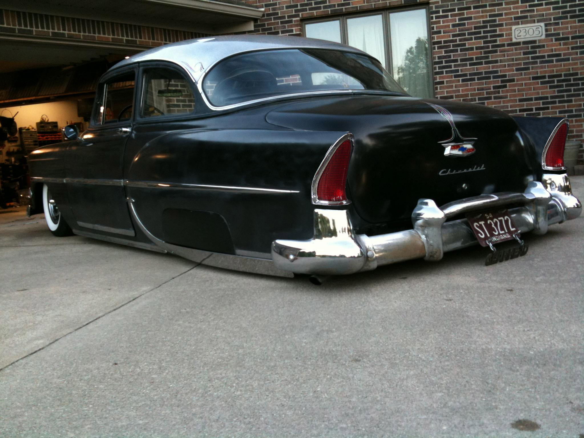

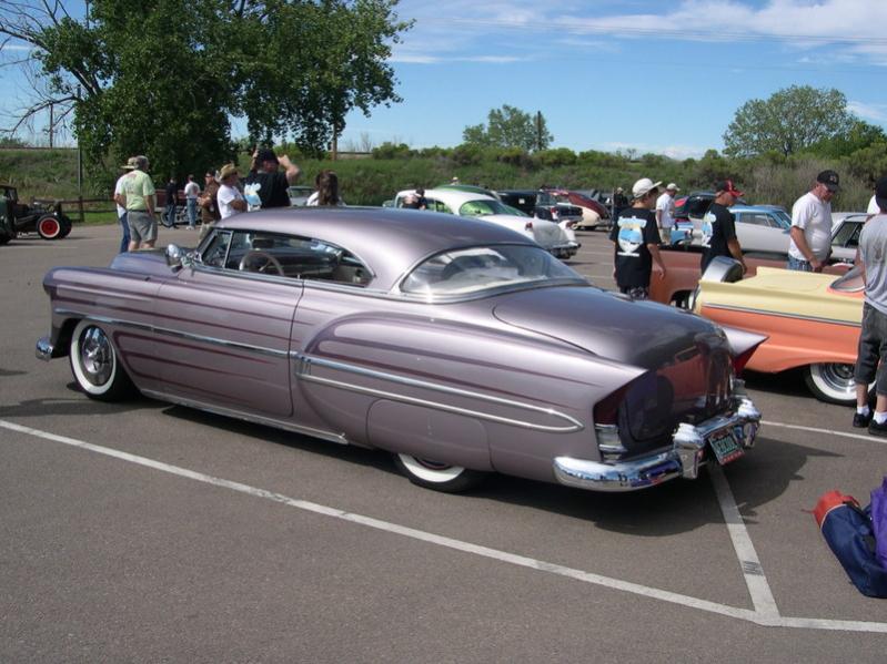

Like Bob Scott said this was a pretty common conversion. Old custom car rags used to publish how to's all the time. To me the best jobs are the ones without the chrome bezels. Here are just a few photos of the results:

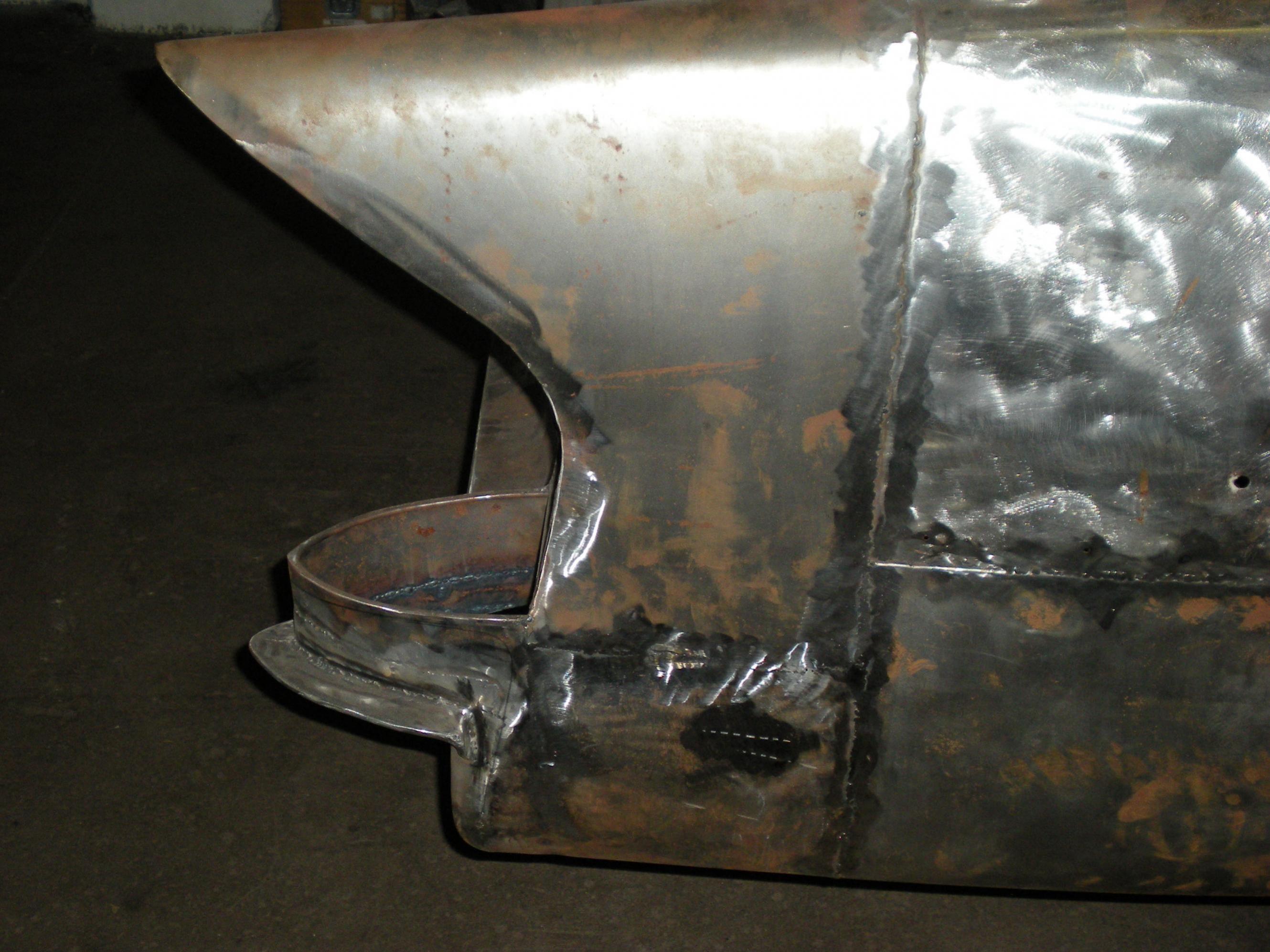

This is what I did too. Make a rod frame around the shape of the light. Figure out where this flows into the quarter the best and skin it with sheetmetal. Here are a couple of pics of the sheetmetal over the skeleton, I do not have any pics of the rod before skinning it.

I used 3/16 round stock and built frames for the tail lights. I bent it all by hand, and clamped it to the back of the tail light bezels and tacked it. Then after I got the form I wanted i finished the welding. I then added sheet metal for mounting purposes to the bezel. Cut my rear fenders back, the used round stock to get the shape and countour I was looking for and hung my frames from the fenders. Then simple sheet metal over the round stock. Hardest part was rebuilding the bottom of the fender under the tail light housing so it didn't look funny.
