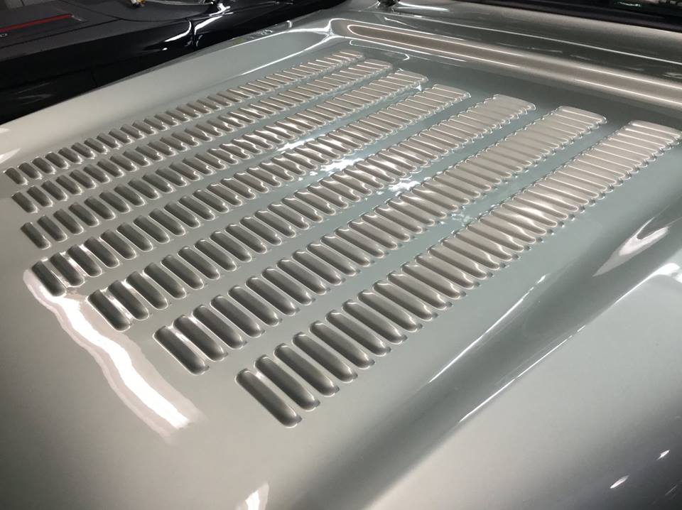

    I know, louvers are not for everyone. Another thing I did was putting heat wrap on the head pipes from the exhaust manifolds to the mufflers.
    lothiandon1940 and rockable like this.
