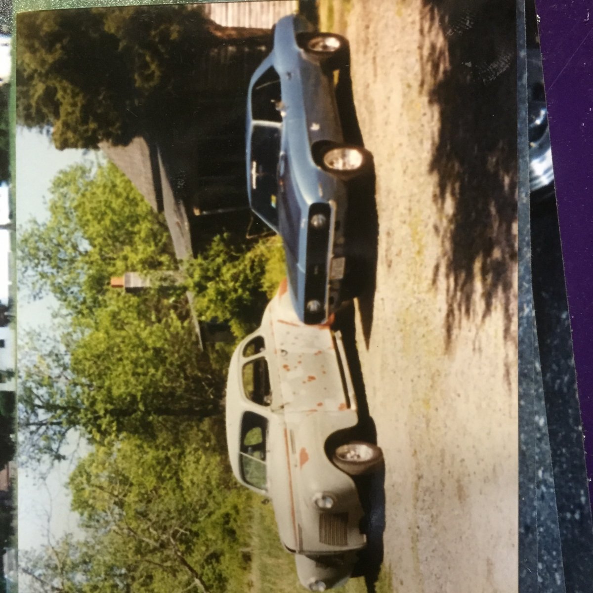

    70343F64-DF88-4CD2-8594-2CE25EE52EE7.jpeg This is a 40 , we ran a 4 core cross flow Mechanical fan, no Shroud for 30 years in va , Experimented with different pulley combinations solve the problem, with inner fenders. stock fire wall,
    Maybe playing with timing.
