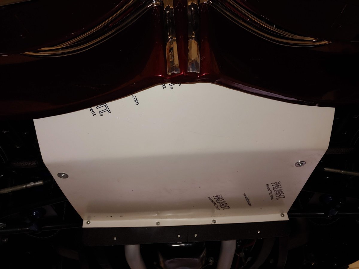

    You and I are on the same thought train. I fabricated a plastic under tray that will block the air and turbulence under the front from going up in front of the engine. It terminates at the air dam and should work well to improve the flow out of the engine compartment.....hopefully. I will paint it black if it stays. 0511191153.jpg

    That makes more sense and addresses the biggest concern I had in your choice of position for your air dam. You lose the advantage of pushing air up into the rad but it should at least improve draw through the rad.

    You built the lower air dam to draw air out of the engine bay. There is no picture of the top of the rad. So the question is there an upper grill air deflector to stop the air from going up over the rad into the engine bay? The upper air deflector holds the high pressure in front of the rad for better cooling. One thought a**** many.

    Ok. It finally got hot here and I tested every idea I had to no avail. I tried with and without air dam, inner fenders, etc. In desperation, I called Champion yesterday. George said that since it will actually cool down when sitting still and get hot while running at speed, he was convinced that it was an airflow problem. He suggested removing my shroud.
    Today, I did just that and Shazam!, the temperatures went down. My design was apparently restricting airflow at speed. At 91 degrees today, it stayed right on 180 for 2 30 minute drives. It also stayed cool while idling with the A.C. on.
    So, a fully enclosed shroud is not always a good idea, especially with an electric fan. A shroud that incorporates flaps is probably the best design but my radiator is only 18 x 18.5, so there is minimal room for flaps. Turned out that the 16" Spal fan I had moves enough air to keep it cool sitting still without the shroud.
    Thanks for all the ideas and tips, everybody.

    Pics of the shroud?

    Agreed. You probably wouldn't need any flaps if it was deep enough, so the air flow from the corners could go towards the fan opening unrestricted.
