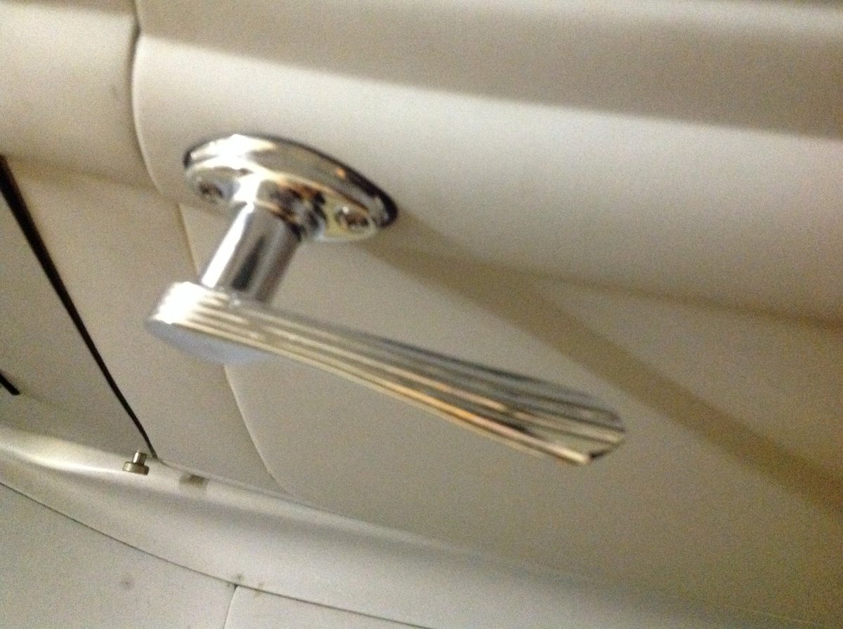

  3. Suthunman
    Joined: Jun 28, 2015
    Posts: 115
    Suthunman
    image.jpg This is not my actual handle. What I have are identical to this and the pitting is about the same.

    image.jpeg After researching options, powder coating and rechroming seemed to be the logical choices. Emailed pics of the handles to several places. Had 3 reply, 2 powder coaters and one chrome shop. The chrome shop quoted the same price as the lowest powder coater. Seemed to be a no brainer and shipped them to the chrome shop. $150 total was the quote.
    Got a call a couple of days later. There was going to be an extra charge for separating the bezels from the handles themselves. The pitting was worse than they thought by looking at the pic and it was going to cost a little more than they had quoted. There was a crack in one of the bezels that needed repaired, at an extra charge. They had a locksmith that could make a key for me, extra charge of course. All totaled $275. I said do it. Took about 2 months but when I got them back, I was pleased.
