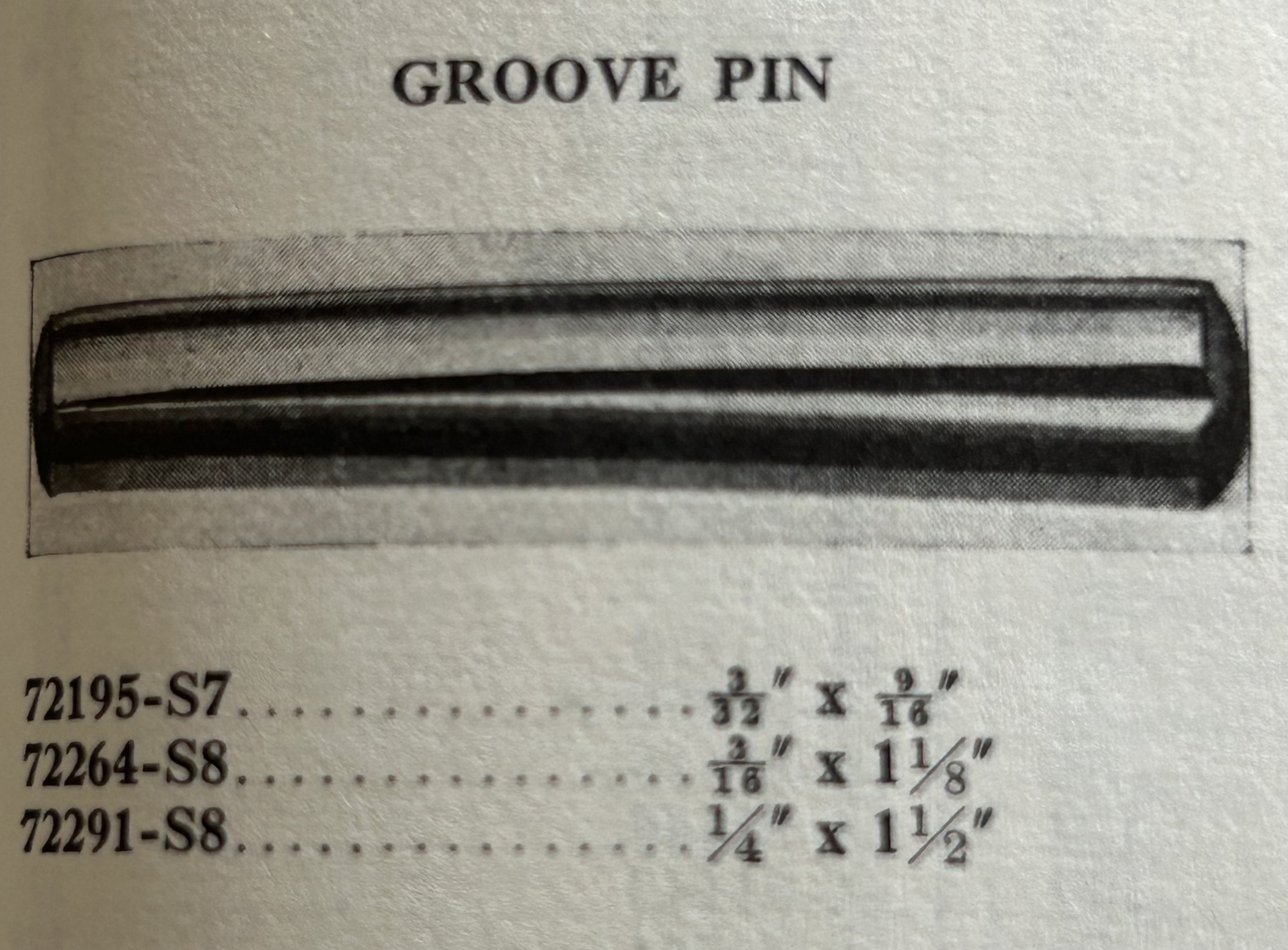

    Somewhere under all that dirt and grime I believe there is a roll pin that keeps the shaft from moving out of its mount. You need to remove it before the shaft will come out.

    The later, removable bracket for the pedals used this pin to retain the pedal shaft. Notice the taper of the pin.

    That is exactly what the pin looks like that I just found per BJR's response. Its in the shaft boss on the extra K member leg. Thank you guys.

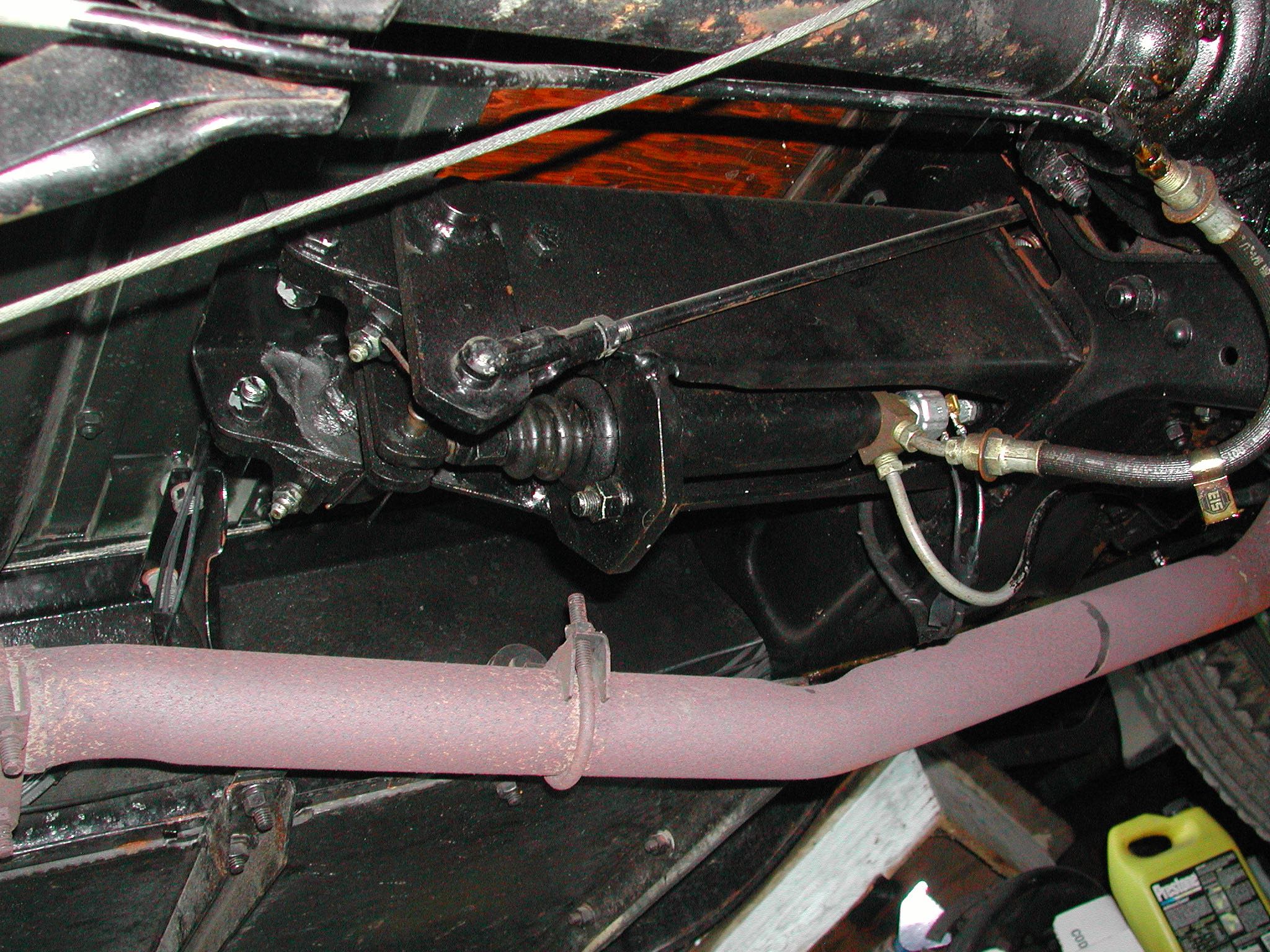

  7. I have been into '32's since I got my AVATAR in 1969. I have had several and read a lot about them. That is a pedal ***embly I have never seen. What is the serial number on your truck? Put a couple of "**" at the end if you are concerned about showing it. Attached are a couple of photos of the brake master cylinder mount, the relocated battery and the original hole in the floorboard being used to fill the master cylinder on my AVATAR, it might give you a few ideas. My conversion uses the original pedal ***embly bolted to the K member.
    Charlie Stephens
