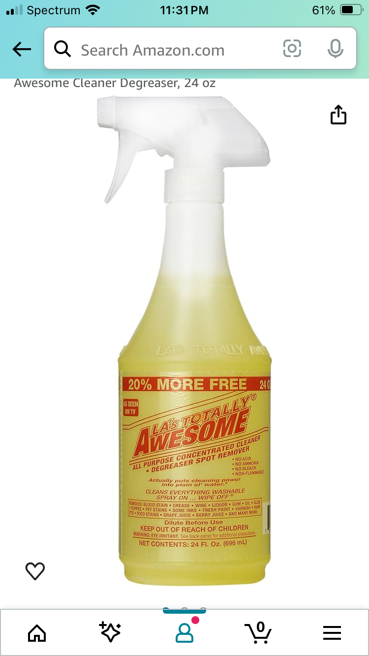

  7. Petejoe
    Joined: Nov 27, 2002
    Posts: 12,538
    Petejoe
    from Zoar, Ohio
    Don’t laugh. This stuff is cheap and I’ve seen it do miracles.

    I'm with you, Petejoe, ...got it at the former Dollar Store(s), all I had at the time to use so decided to give it
    a try...it works great on all sorts of stuff. Never would have believed it.
    Petejoe, winduptoy and mad mikey like this.
