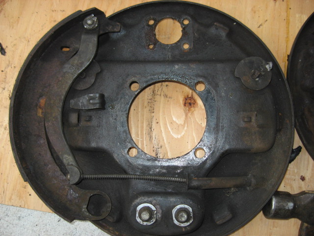

    I've got what I was told was a '39 ford banjo rear. But, I'm not sure if that's true or not. It's 10-spline input, has wide-five drums, and does not have spring perches built into it, just brackets to bolt on radius rods. Does this sound like a '39? I tried searching for info, but couldn't find photos, just a bunch of contradicting descriptions. (BTW, if there's anyone out there with uber knowledge, I think a complete breakdown of the different banjos complete with actual photos and descriptions would be an AMAZING tech article!) Also, before anyone says it, I checked http://www.vanpeltsales.com/FH_web/flathead_home.htm with no luck. All of their pictures, with exception of a few, are just drawings of the internals of the center section.
    I'm getting way off topic. Back to my initial question. I'm trying to tear the thing down, but can't get the drums off. I'm afraid to beat on them with a hammer because I fear hitting too hard and bending something or breaking something. The only things on the backing plates are two bolts with springs behind them. They both turn so far one way, then the other, and stop. I'm assuming these hold the shoes to the backing plate as I can't find anything like on modern drum brakes that would do this job. Is this a correct assumption?
    There's no hole to loosen the adjuster because I'm fairly certain these don't have self adjusters. Am I right in thinking this?
    So anyway, what's the proper procedure for getting these drums off?

    Sounds like a '36 with later hydraulics...I assume the adjuster nuts are big, I think 13/16...turn both so wrench is swinging UP to loosen. You must get hold of a good antique puller or replica that pulls from the center of hub. All else is hopeless unless they were inadequately tightened...

    Yes, they have hydraulic brake line at the top. With copper brake lines to boot. They also have piece of a cable coming out which I'm assuming is the parking brake.

    There's plenty of brake hardware that shows from the outside, but there's also some that does not show that cannot be cut from outside.
    But that's not his problem. He can't get the hubs off the tapered axle. And when the hubs won't come off, the backing plates and brake guts are the least of your worries.

  25. NINE INCH
    Joined: Dec 26, 2005
    Posts: 1,020
    NINE INCH
    Check this out.. Just a week old pic. :) B
  26. NINE INCH
    Posts: 1,020
    NINE INCH
    Here, one more. hope this helps. B
  27. NINE INCH
    Posts: 1,020
    NINE INCH
    I got a million of em! Hah! Its very simple. Take my advise on poppin em off and disassemble. Super easy. Take pics like I do. It helps! See ya.:p B
