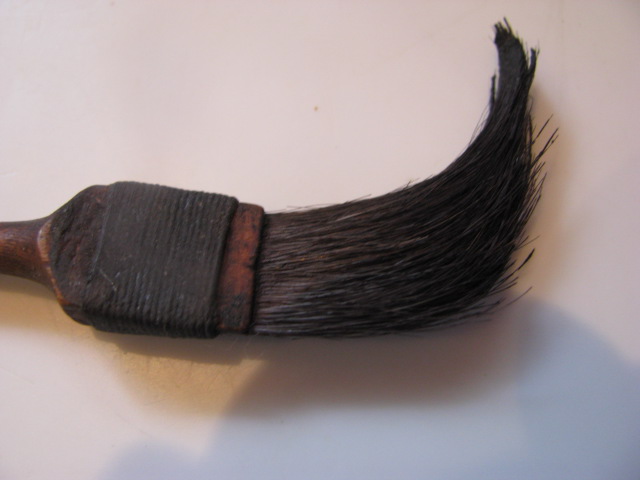

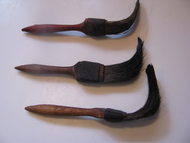

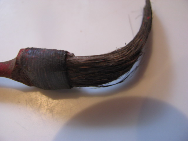

    Someone had donated three old Mack stripers to my collection that had been sitting somewhere with the hairs folded over more than 90 degrees. These would probably work well if you were painting around corners but for regular striping they are useless.

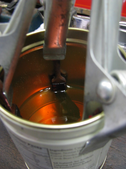

    I began my resurrection by carefully suspending just the hair of the brushes in a can of lacquer thinner. MEK can also be used but be careful not to soak the binding as it may soften the coating holding the hairs and start the brush shedding.

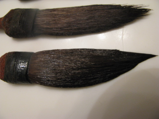

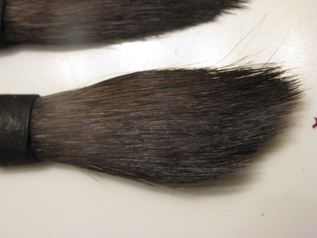

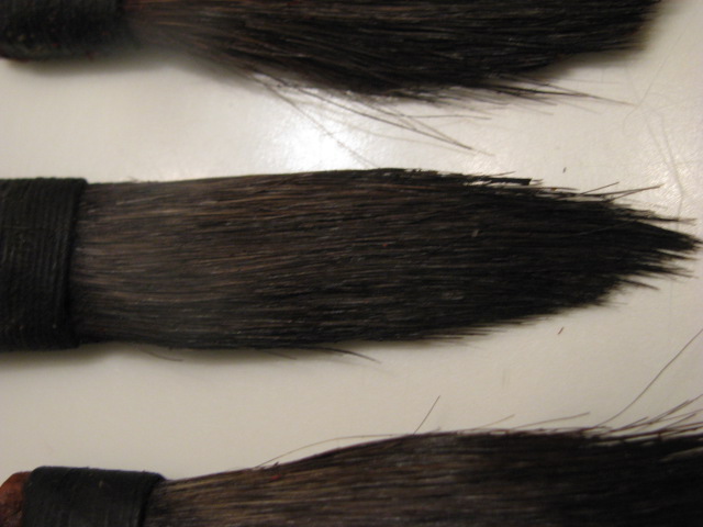

    The pictures I am posting show the stages I went through to straighten what appear to be totally destroyed brushes.The last two pictures are of a table top I striped with one of the brushes. 3DeadBrushes1.jpg 3DeadBrushes2.jpg 3DeadBrushes3.jpg 3DeadBrushes4.jpg 3DeadBrushes5.jpg 3DeadBrushes6.jpg 3DeadBrushes7.jpg 3DeadBrushes8.jpg 3DeadBrushes9.jpg 3DeadBrushes10.jpg 3DeadBrushes11.jpg DeadBrushRepair13.jpg DeadBrushRepair14.jpg DeadBrushRepair15.jpg DeadBrushRepair16.jpg DeadBrushRepair17.jpg DeadBrushRepair18.jpg DeadBrushTestPanel03.jpg

  8. That first picture kinda brings a tear to your eye, don't it? :( Definitely looks like "dead squirrel parts tied to the end of a stick". :rolleyes:
    Thanx for passing this along. Never thought about them using anything water-based for the binding.
