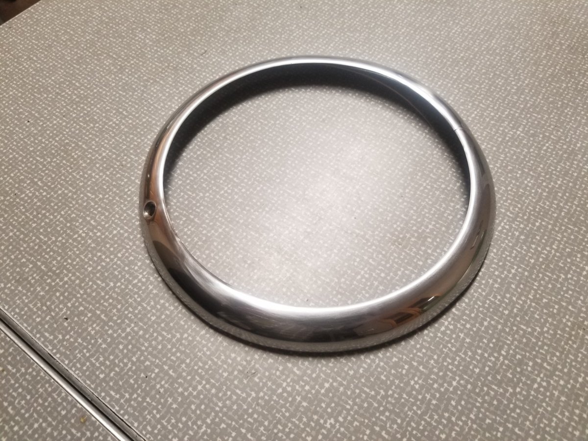

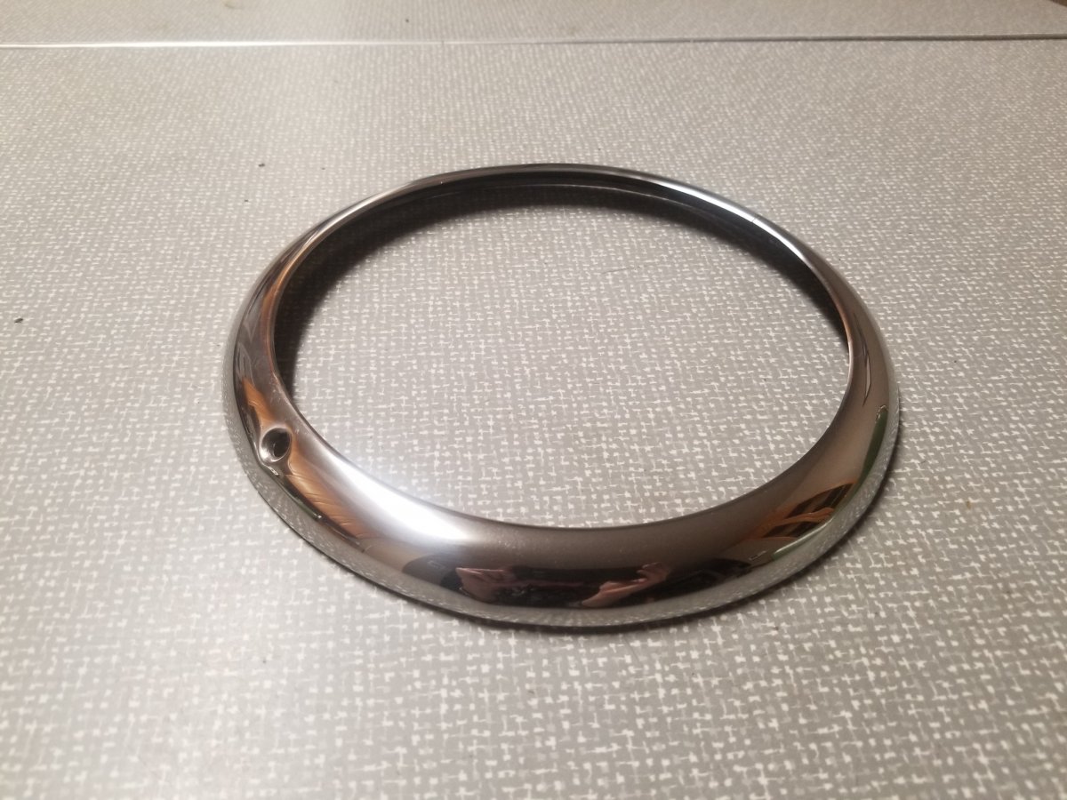

    Stainless trim is thin and delicate, so the key to repairing it successfully is patience. For this demo I will be repairing a headlight ring, mainly because it was near the top of my junk pile, and I don't know what its for so if I ruin it who cares...
    It has most of the typical damage, heavy scratches, dents, dings and a small crack

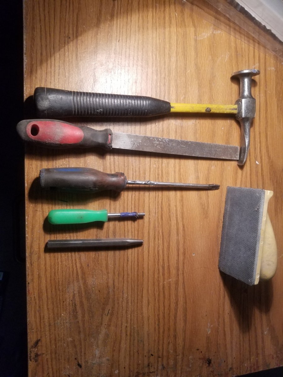

    Now these are the tools, old body hammer, file, flat blade screwdriver (aka chisel), screwdriver with the end broken off,a punch,sanding block, and a flat wood table. In this case I will not be using the file, only use files as a last resort. Files help to reveal high and low spots, however they also remove material fast and leave heavy scratches, so I prefer to use a sanding block with 80 or 120 grit sandpaper.

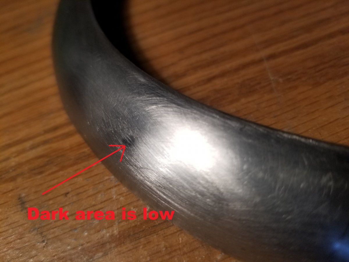

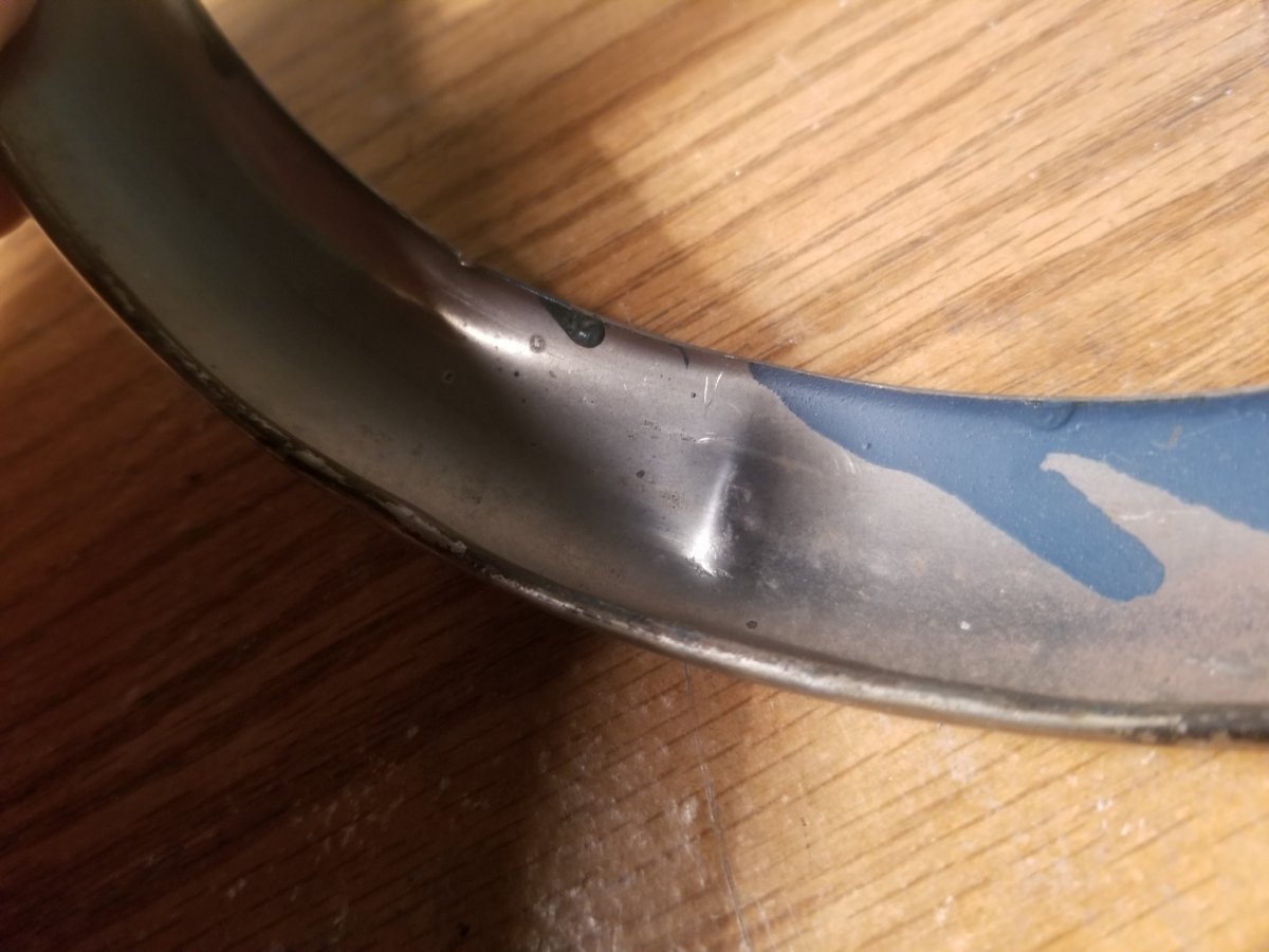

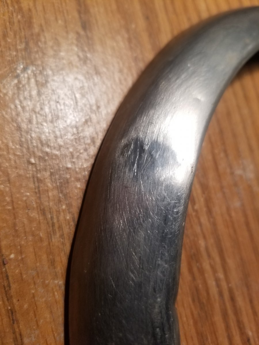

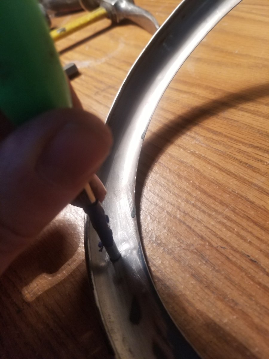

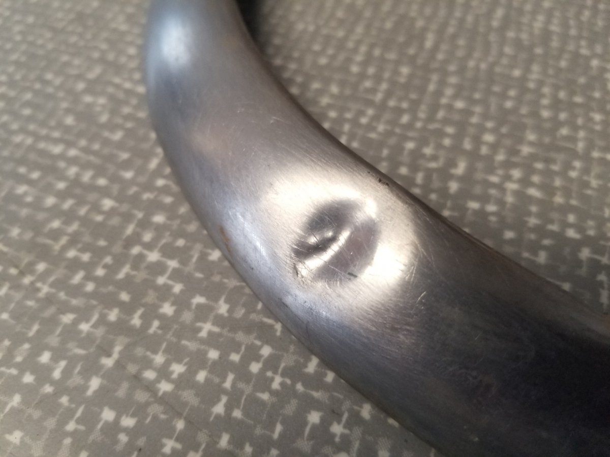

    20201201_132518_resized.jpg We will start by repairing the larger dents, here is a dent from the underside (I have no idea why there is multiple colors of house paint on the inside, you should clean off all house paint and debris from the inside of the damaged areas first)

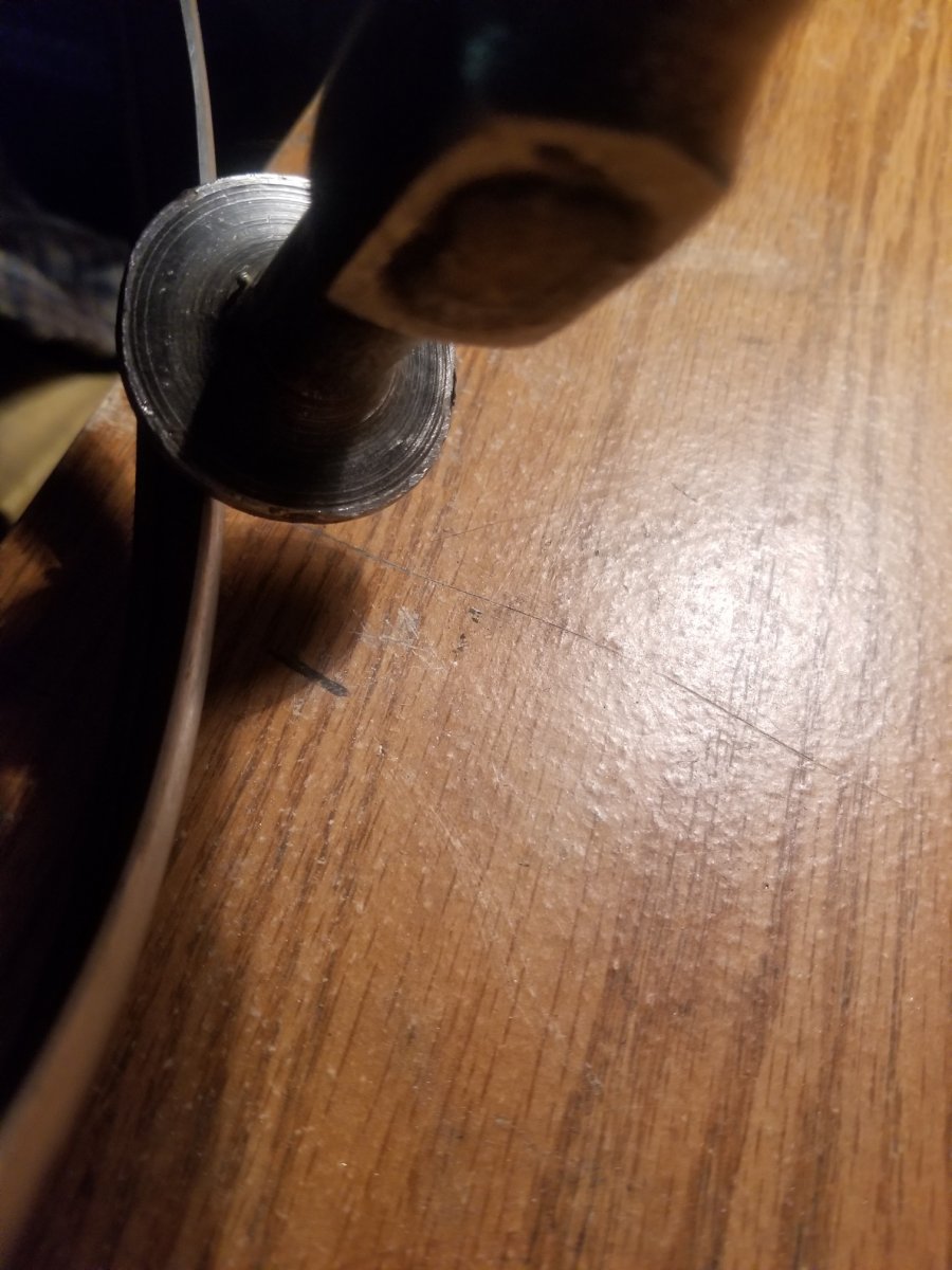

    Okay so we are going to start by using the broken off screwdriver as a punch by tapping on it with a hammer, starting from the outside of the dent and working towards the center. I'm holding the piece against the table, using it as a back up dolly, I like to use a table with a softer surface, as a metal table could cause further damage to the surface of the stainless.
    Ok now we can see that the basic shape is back, however the area is still low (dark spot)
    now back to tapping away with our busted off screwdriver. Just about any tool can be the right tool for fixing trim, chisels, punches, jewelers hammers, blocks of wood, chunks of s**** metal, just get creative. Going slow, and being accurate is more important than the tools used

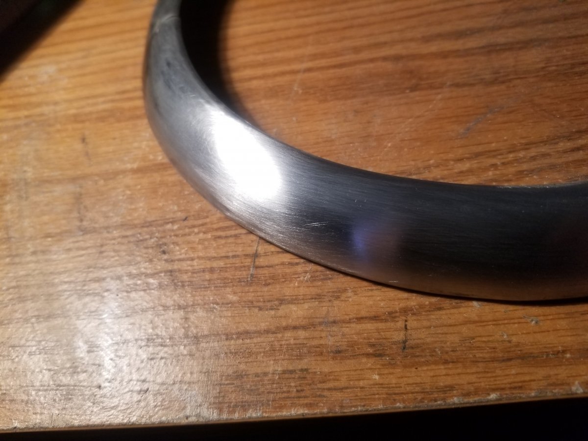

    Once larger damage is roughed out, its hard to see the remaining imperfections from the inside, I lightly sand the inside to reveal highs and lows, high spots show up as shiny areas, low spots are dark

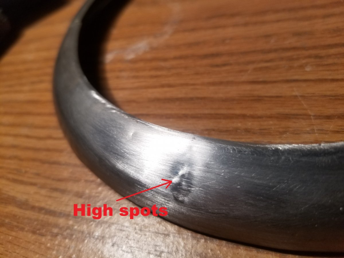

    On the outside I have sanded the surface with 80 grit on a block, this has revealed some high spots which will need to be tapped down before we can continue
    20201201_134657_resized.jpg I'm using the hammer and chisel to lightly tap these down

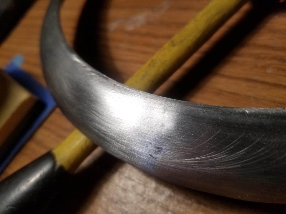

    Ok so after tapping down the high spots, and tapping up some more low spots from the inside with our trusty broken screwdriver, I've block sanded the outside again and we are now left with a few very small low spots...
    For minor low spots and dings I put my busted screwdriver aside and use the chisel to push up the low spots, no need for hammering, laying the piece on a flat surface and applying medium pressure is often enough. 20201201_135005_resized.jpg
    How it looks after blocksanding with 80, this area is now ready for final sanding and polishing

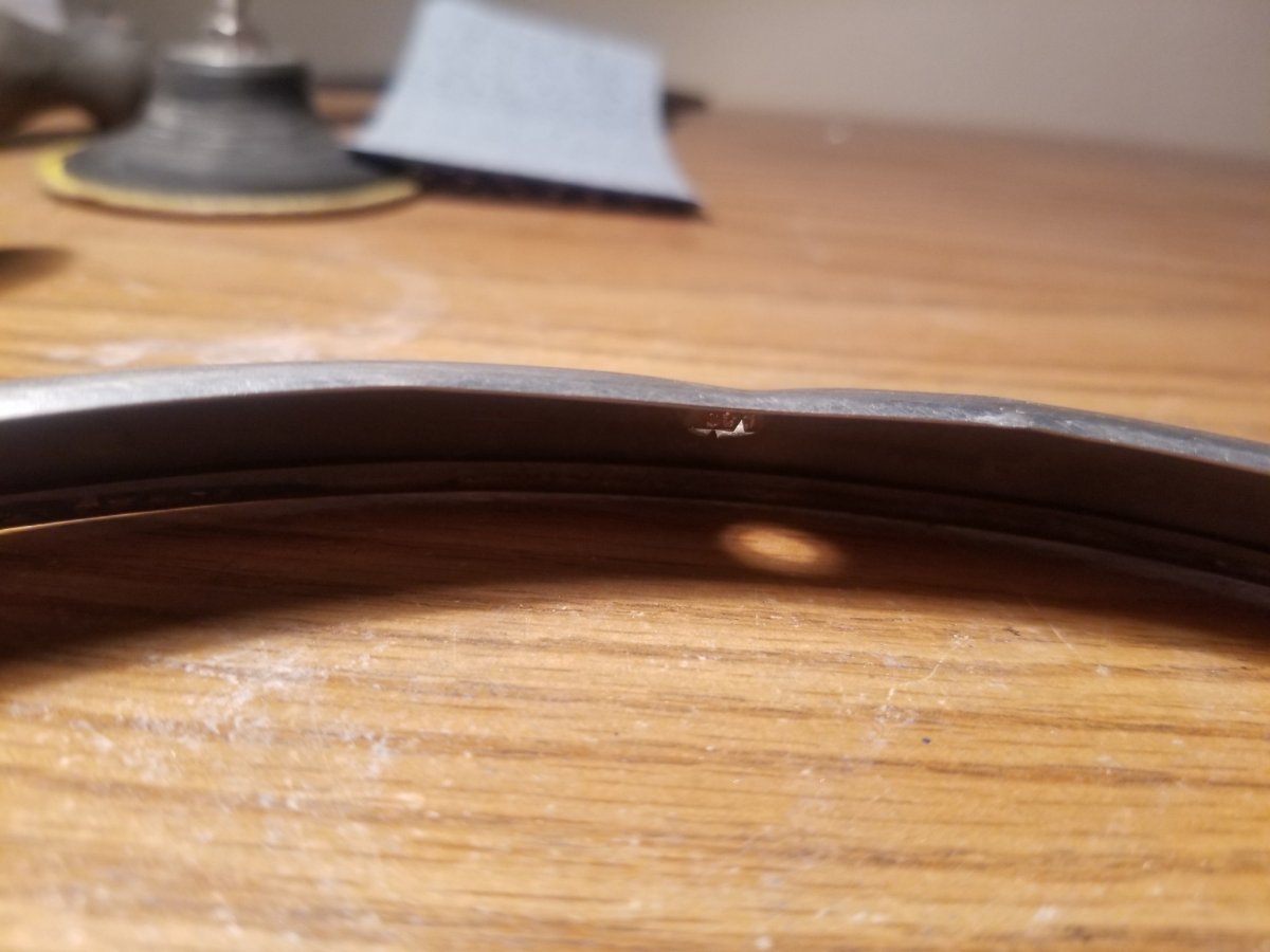

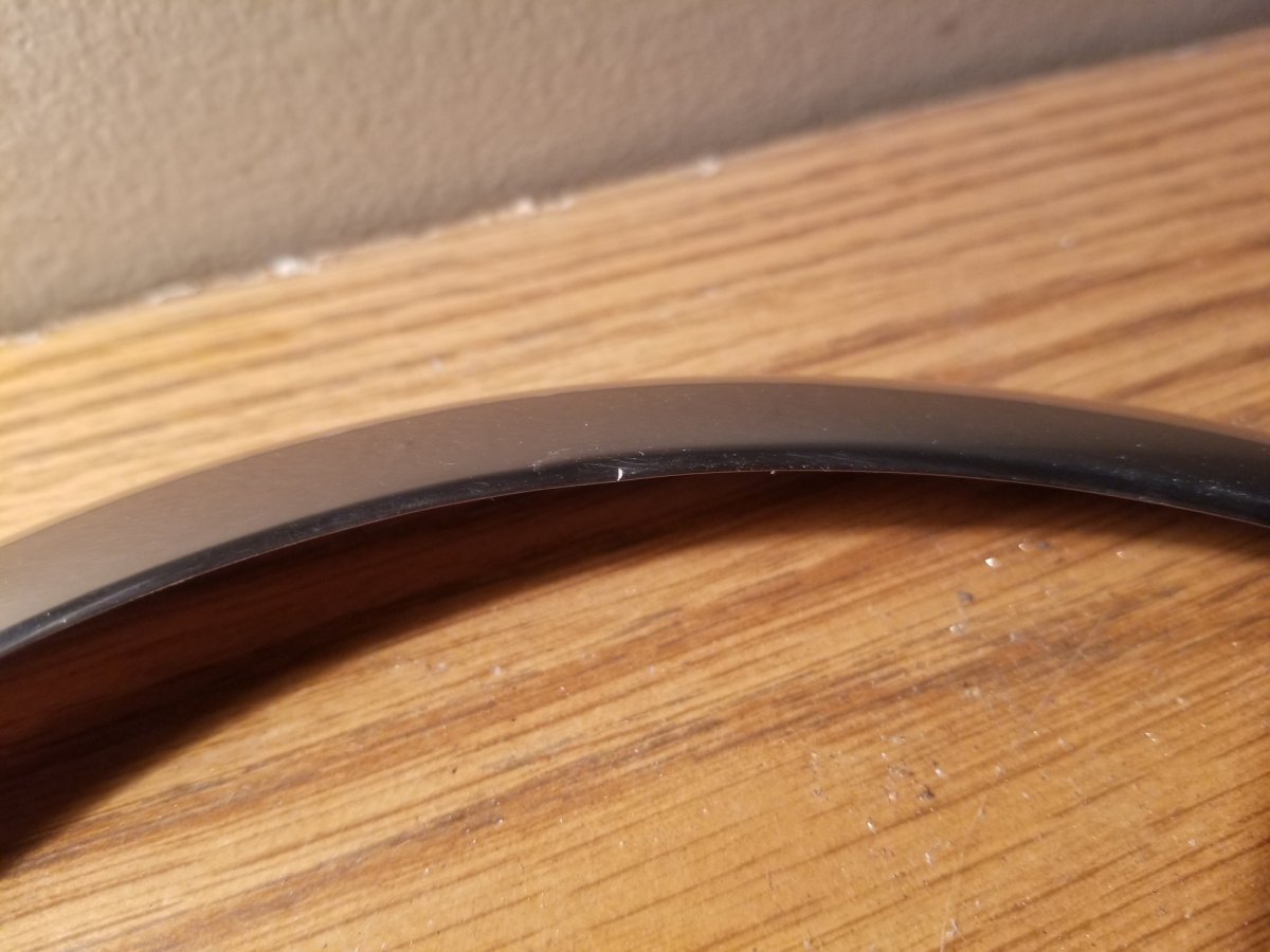

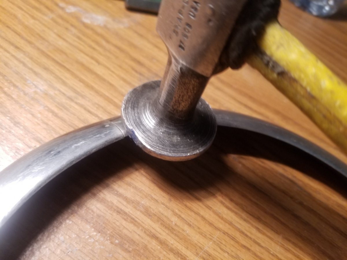

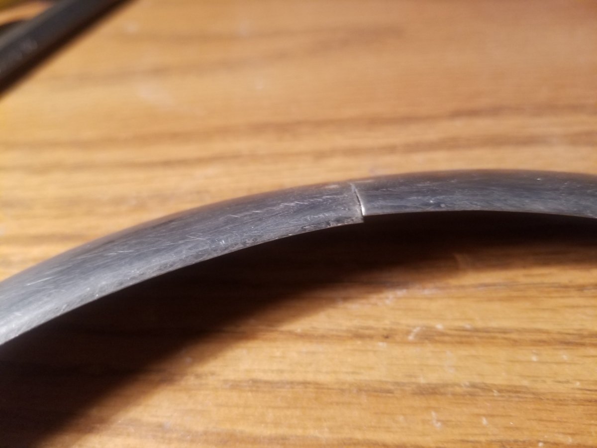

    Here we have small crack on the edge, cracks can be tig welded or soldered up, but if your like me and dont care, and the crack is not in a critical area, you can still make cracks look presentable without any welding.
    20201201_133158_resized.jpg I started by using my body hammer to straighten the edge, then used the chisel to help finesse everything back into shape.
    20201201_134438_resized.jpg And here is the final result, its not show quality, but this only took a few minutes, and it looks much more presentable then it did.

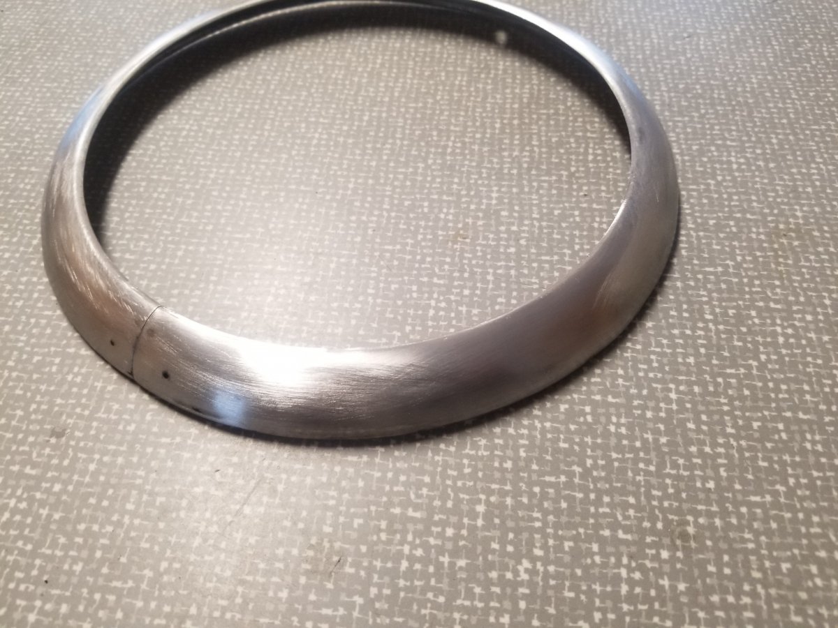

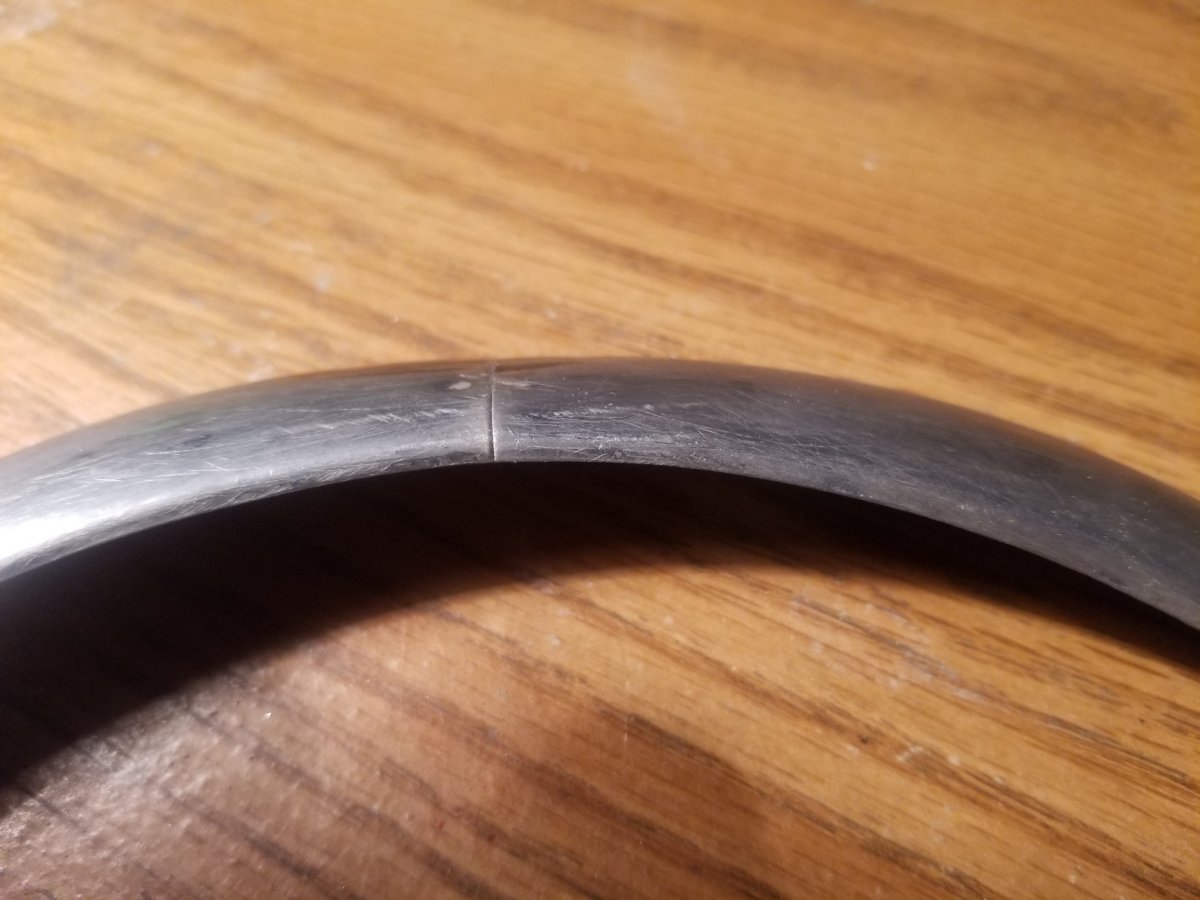

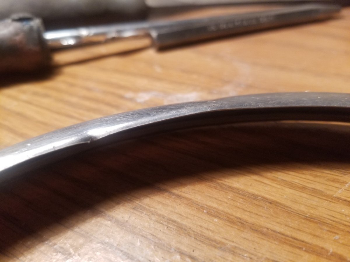

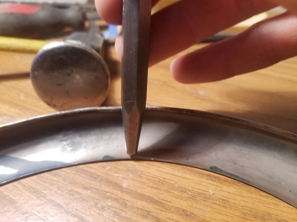

    20201202_105812_resized.jpg Here the edges are misaligned where the headlight ring is spot welded together, damage like this can be easily corrected with small adjustments, with stainless its always best to start with the least aggressive methods vs taking the heavy handed approach, which often just causes more damage.
    20201201_143839_resized.jpg In this case I applied light pressure using the face of my body hammer...no hammering required
    20201201_144007_resized.jpg and its fixed... A lot of damage can be repaired by just applying pressure in the right areas, this is especially true on thinner stainless pieces.

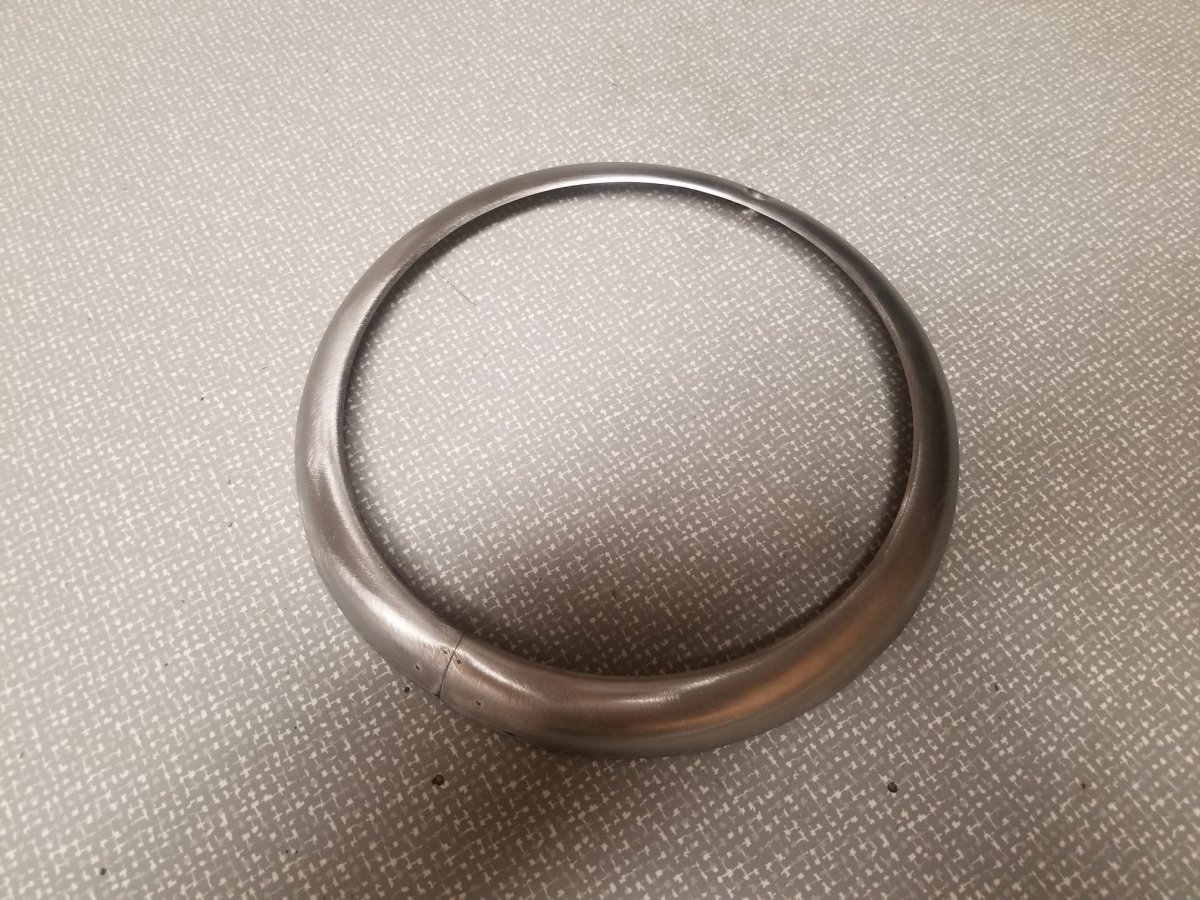

    Its often not necessary to sand beyond the repair area as it just creates more work during the polishing stage, however this trim ring was badly scratched and dulled, which made it difficult to spot additional damage.
    Sanding has revealed a small ding that otherwise would have been missed. It's better to find damage like this now, rather than during the final sanding stage.

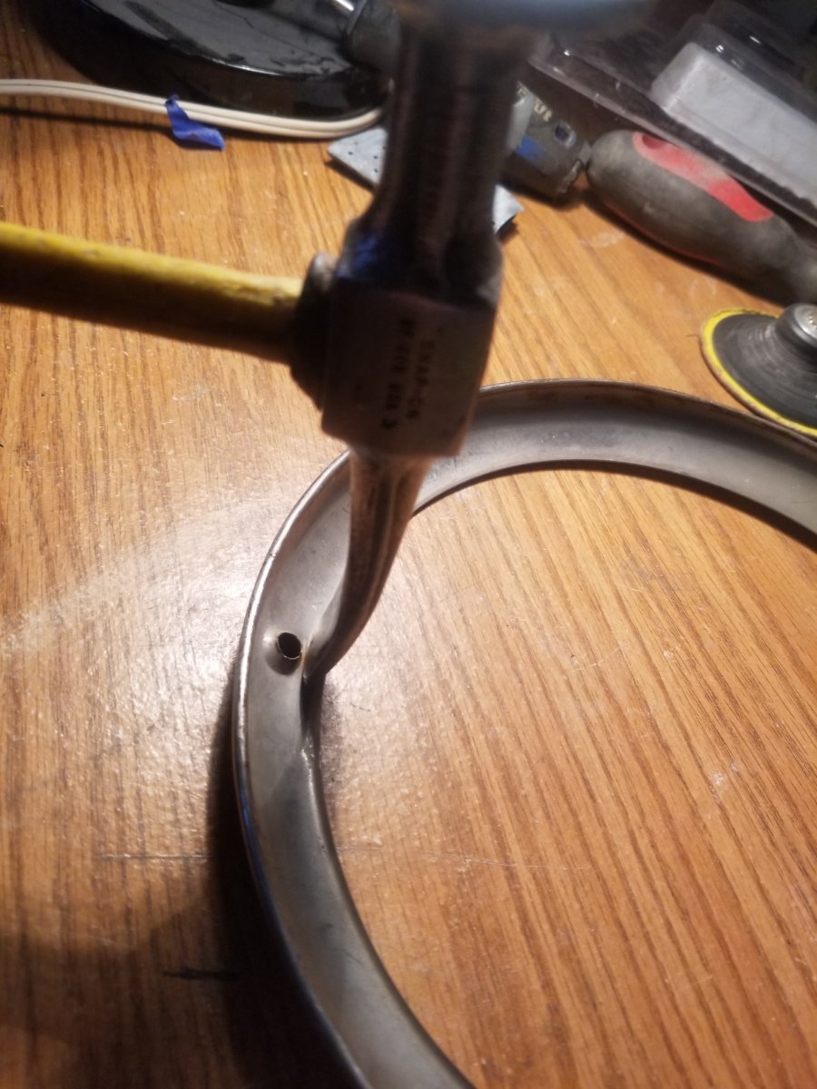

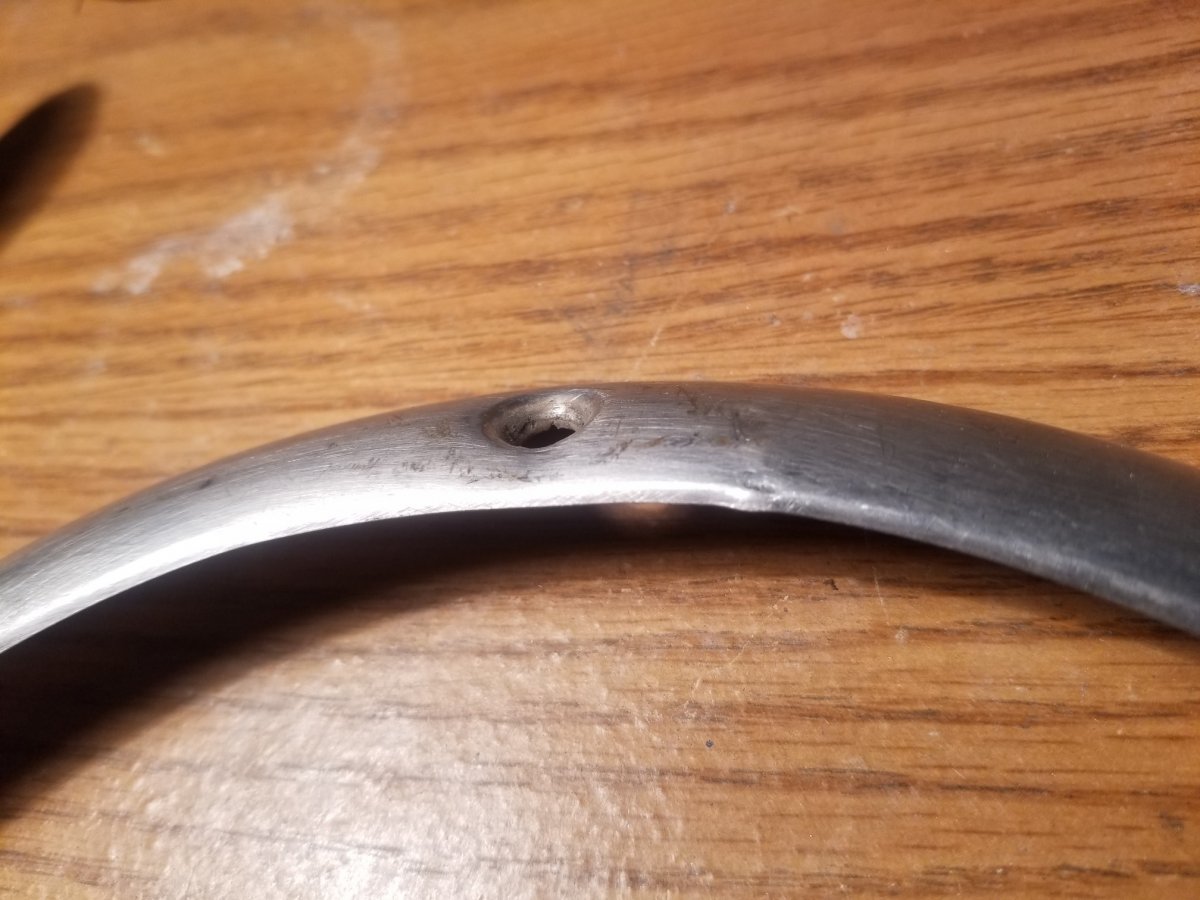

    20201201_144154_resized.jpg This area is badly distorted from someone over tightening the hold down screw

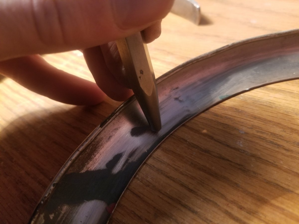

    I'll use the chisel area of my body hammer to rough this area out. Generally I prefer to avoid swinging hammers during stainless repair as its less accurate than punches or chisels
    Using the face of the hammer to push the inside edge back into shape.
    20201201_145250_resized.jpg here is the area all straightened out.

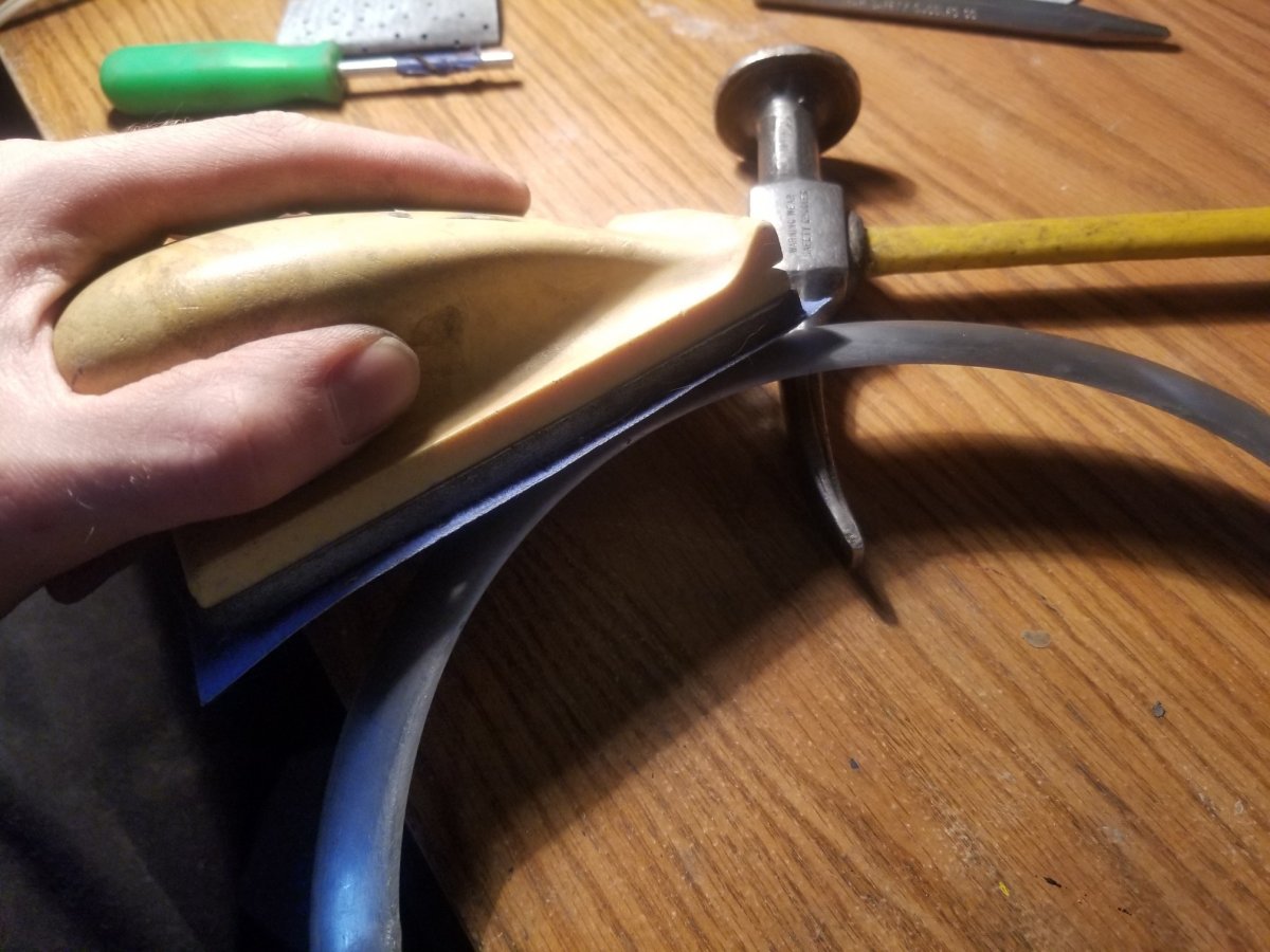

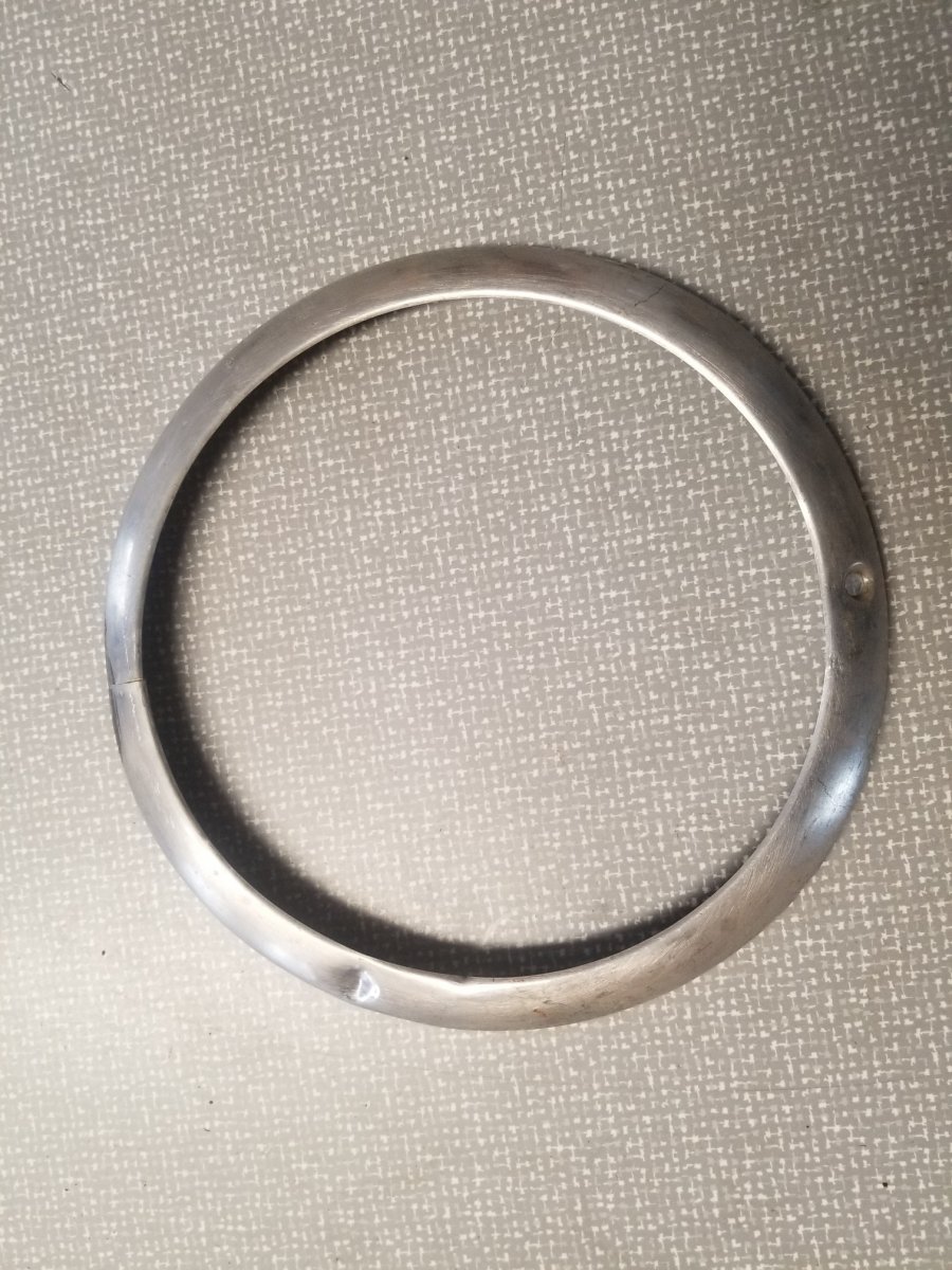

    I start by sanding the entire headlight ring with 80 grit, unless you like making work for yourself don't sand the entire trim piece unless it is damaged. As I mentioned before this entire headlight ring was scratched and damaged, which made sanding neccesary.

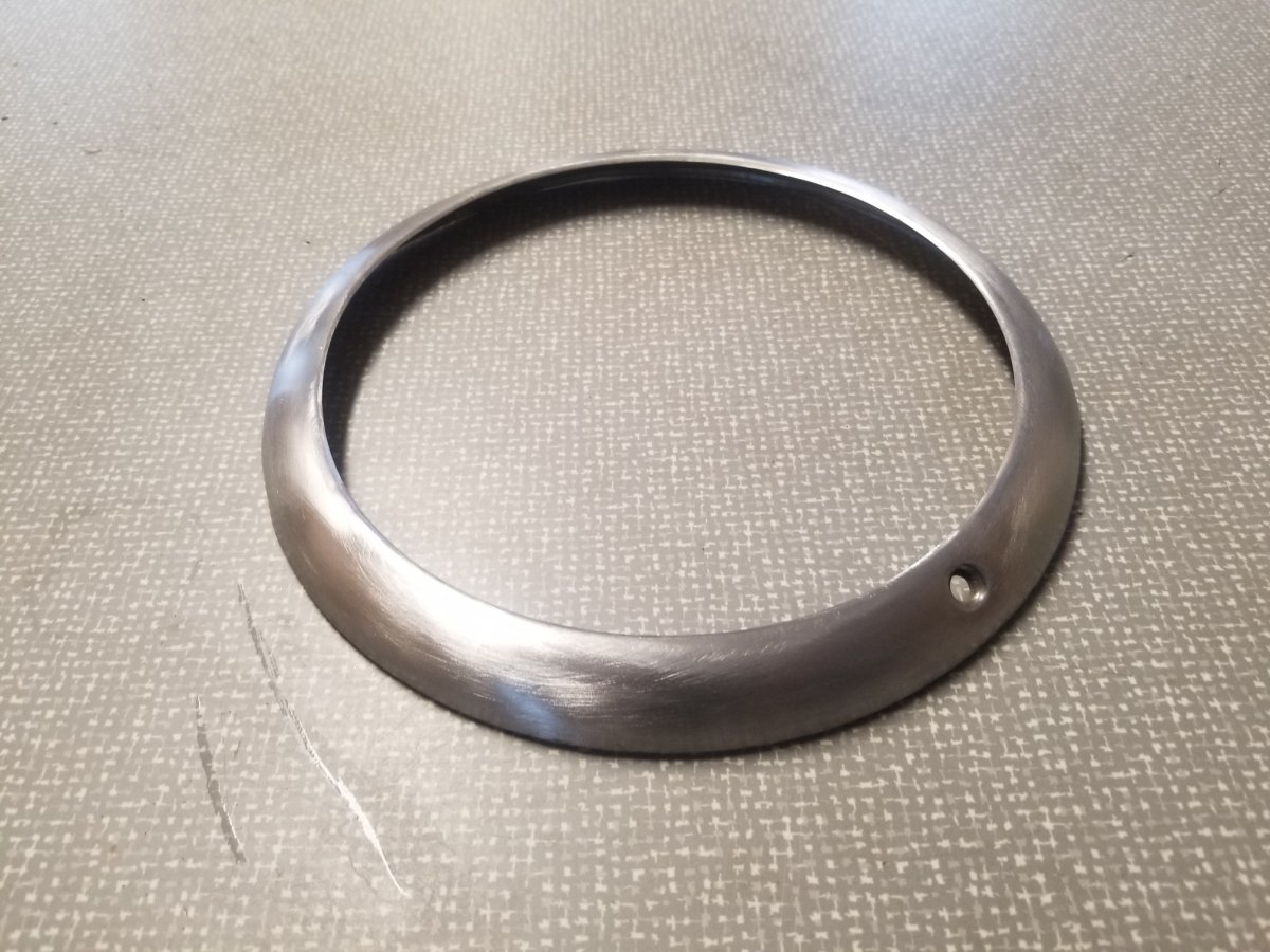

    Next I sanded with 120. I sand in the opposite direction with each grit, that way I am able to see when all the sand scratches from the last grit are removed, if you sand one direction the whole time, you will not be able to see if you removed all of the courser grit scratches, which will come back to haunt you when it comes time to polish.
    I continue on sanding changing direction with each grit, 180,220,400,600,800,1000
    In this picture we are in 1000 grit. The sanding takes forever, but you get out of it what you put in, so don't cut corners...

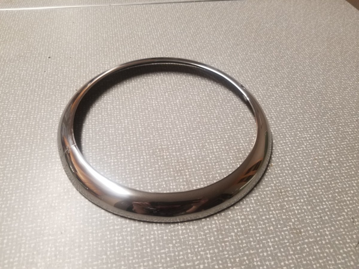

    I take it up to 2000 grit then polish. In keeping with the caveman theme I am using a cheapo harbor freight buffing wheel chucked in a corded drill thats clamped in a bench vice. (sorry I didnt take any pictures of this sketchy operation) I use the green metal polishing compound. In the past Ive also had good results just sanding up to 3000 and using automotive paint polishing compound with a soft polishing pad. You can also get away with sanding up to 800 or 1000, and then working up through various compounds on the buffing wheel, but I prefer spending more time sanding then buffing (less heat and less chance of the buffing wheel grabbing your freshly repaired piece and flinging it across the room...)
    Anyways here is the final result
