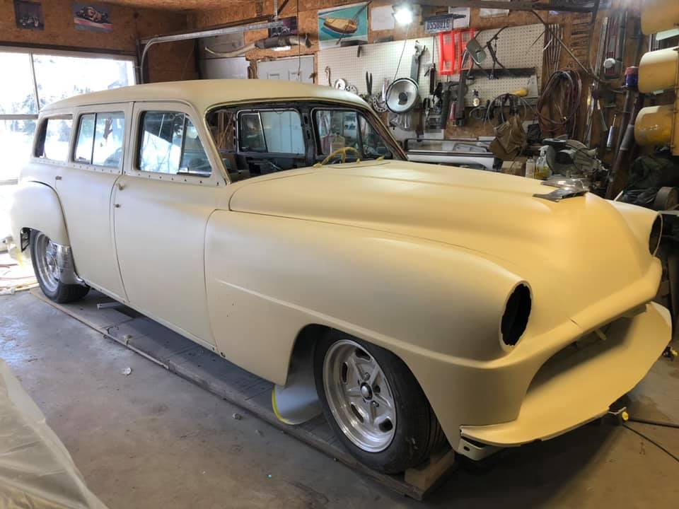

    I thought I had a picture of the wagon with the lift up, but I guess not. I bought this scissor lift just to do this car, it was a life saver. Just the ticket for body work, no more laying on my back or crouching on my knees to do rockers, change tires, brakes, exhaust work. Safe and stable. 4840CBCD-3832-4568-A72B-DD33E740271A.jpeg 3BE937D0-C34D-4BD9-92A8-9090D9F805AD.jpeg
    bulletpruf likes this.

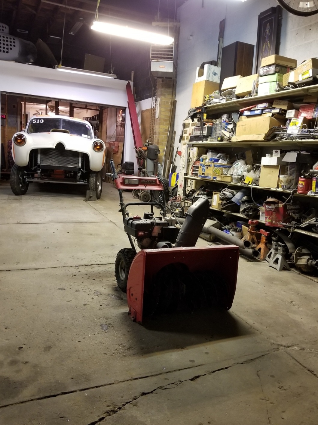

  7. gimpyshotrods
    Joined: May 20, 2009
    Posts: 24,023
    gimpyshotrods
    b-body-bob, 49ratfink, winr and 4 others like this.
