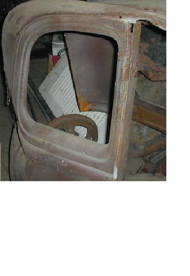

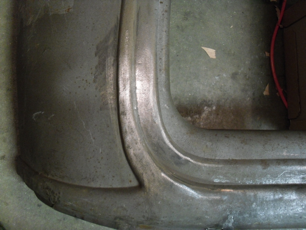

    Purchased a 32 Ford Quarter Panel for my coupe project. Unfortunately It was heavily damaged.
  2. rcnut223
    Joined: Oct 12, 2006
    Posts: 1,282
    rcnut223
    from wisconsin

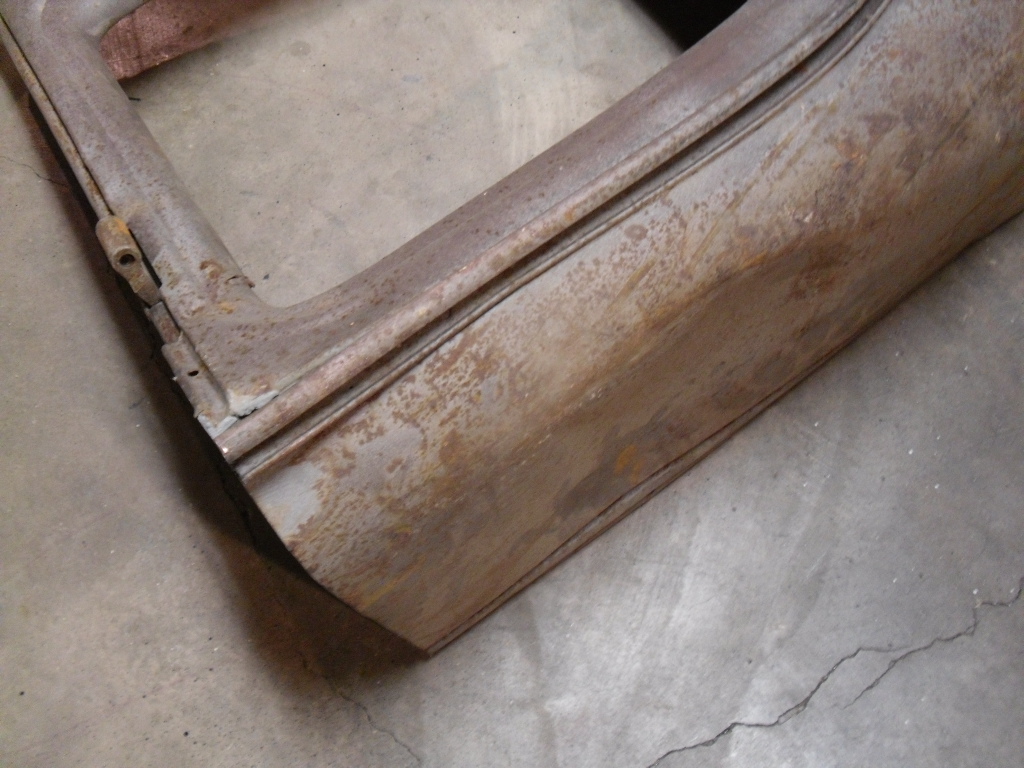

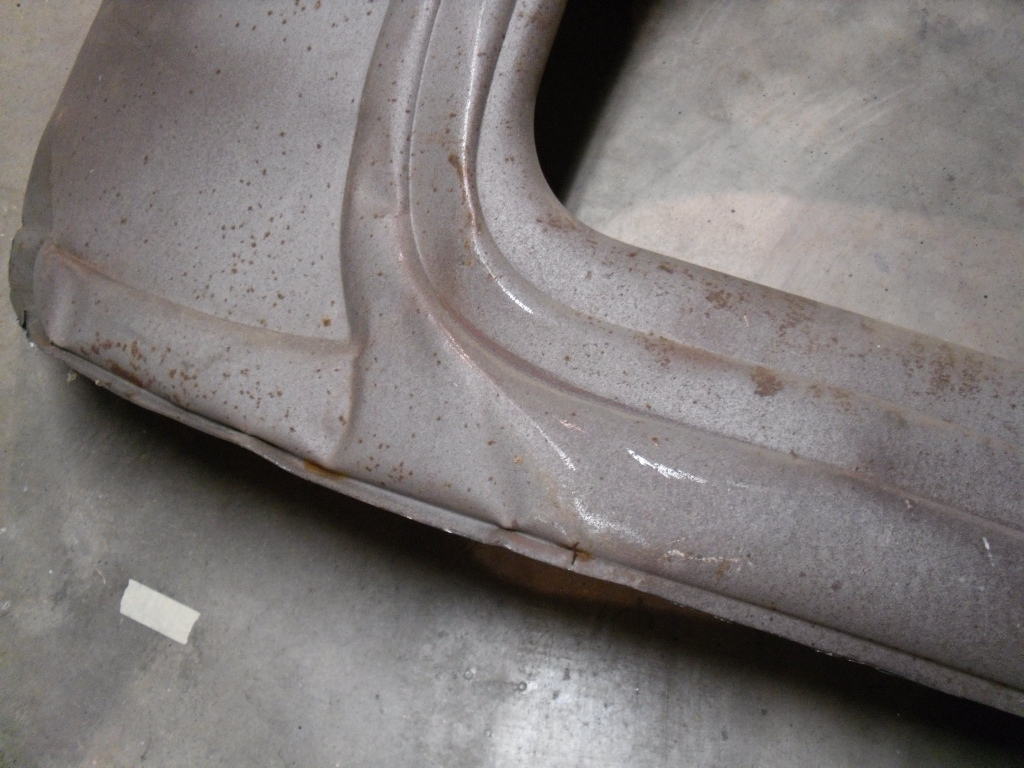

    I did not need the bottom so I asked for it to be cut at the belt line before it was sent. This is what it looked like when I got it.
  3. rcnut223
    Posts: 1,282
    rcnut223
    from wisconsin

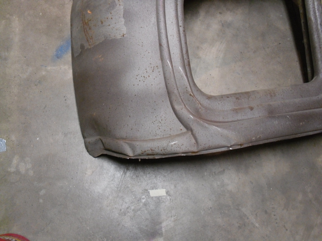

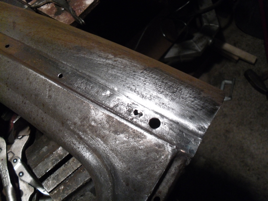

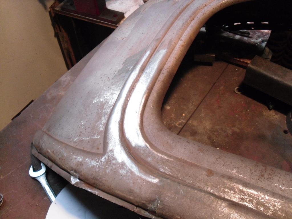

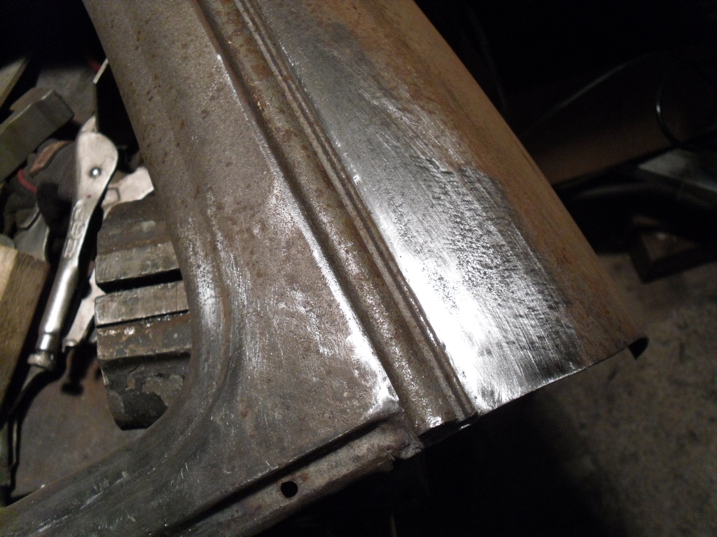

    I began by removing the damage at the belt line, relieving the stress on the wrinkles in the lower left hand portion of the window. No alhtough it appears that way the dents didn't pop out. I slowly worked on the being careful not to strike directly on the crease.
    As you can see the hard crease on the inner reveal remains.
  4. rcnut223
    Posts: 1,282
    rcnut223
    from wisconsin

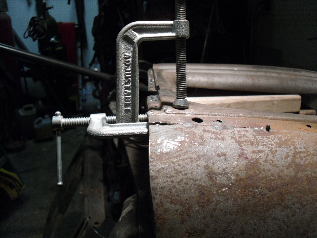

    The remaining crease was removed by a combination of slapper and dolly and pressing on the crease with two pieces of metal and a couple large c-clamps. Sorry did not take a picture of that procedure.

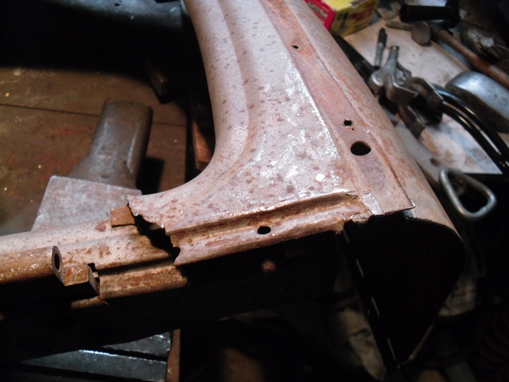

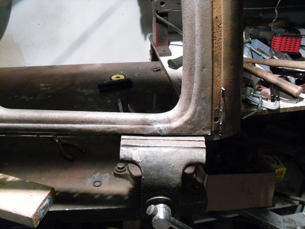

    Next up was the big tear in the upper corner of the window. I started by removing the drip rail and the section of the door post.
  7. rcnut223
    Posts: 1,282
    rcnut223
    from wisconsin

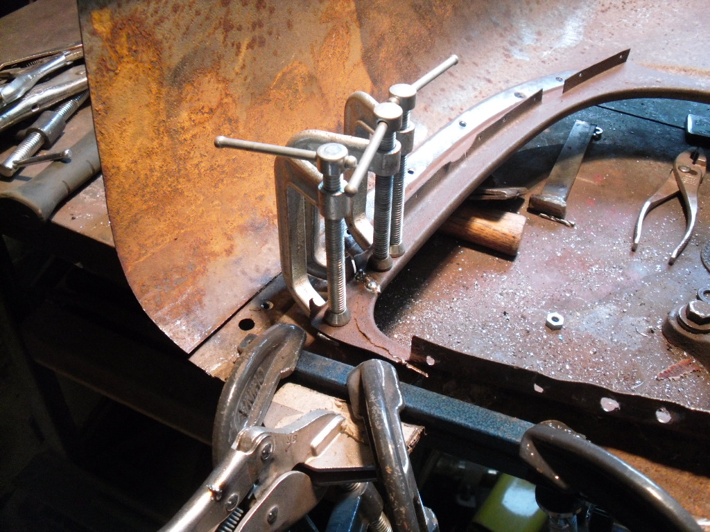

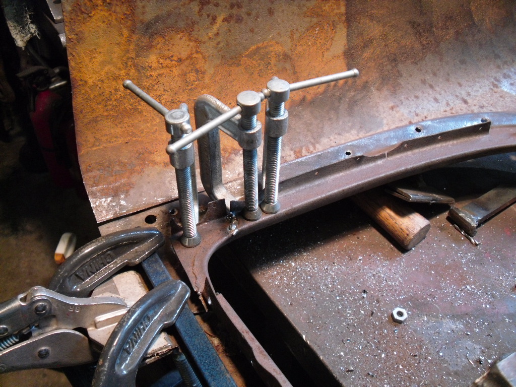

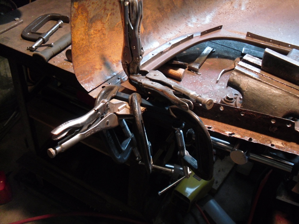

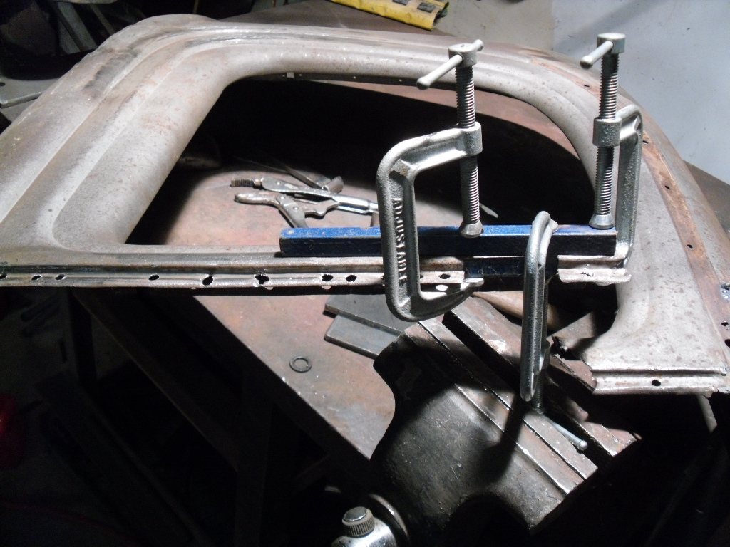

    The inside of the window has a small brace (for lasck of a better term) in the corner. This had been torn loose and I used kind of an unorthadox method of to return it to it's original location. Good thing I have lot's of vice grips.
  8. rcnut223
    Posts: 1,282
    rcnut223
    from wisconsin

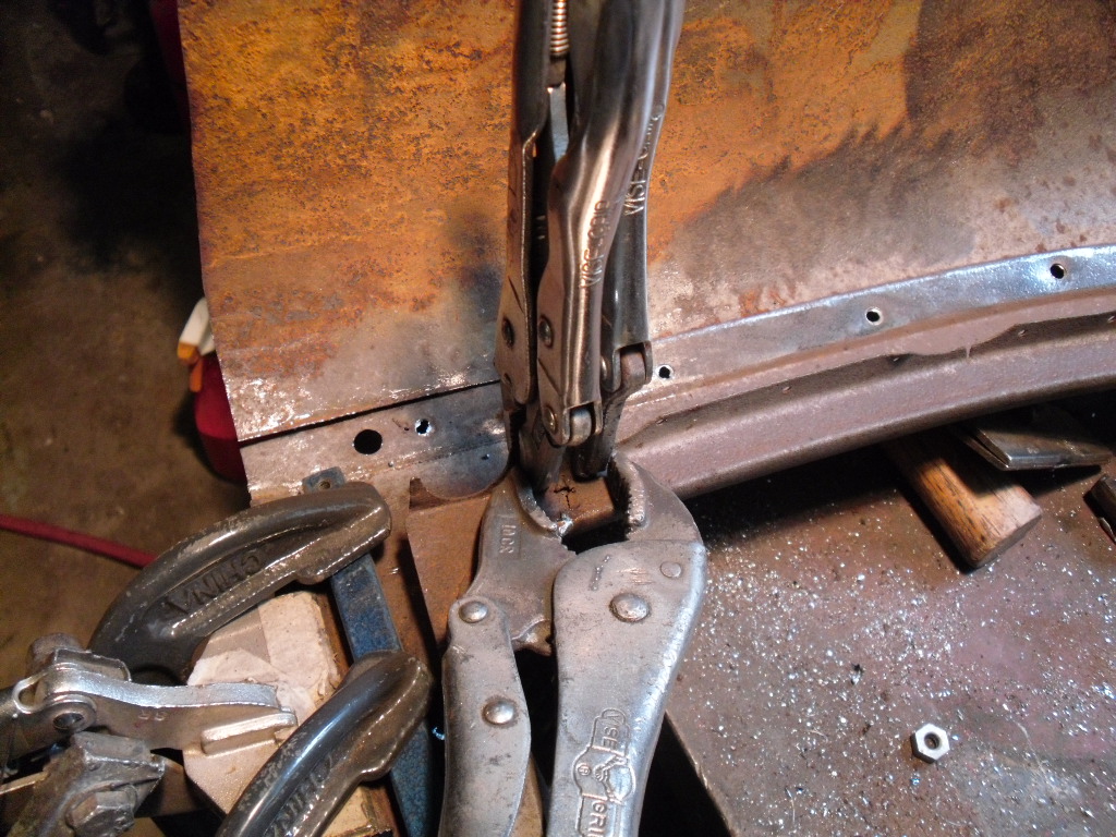

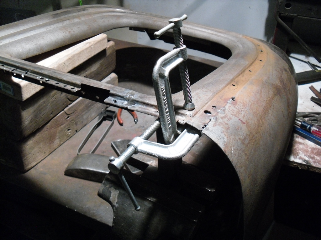

    The previous setup pulled it in place so I could tack it but it was not flat. I then used this setup to get it to lay down like it was originally designed.
  9. rcnut223
    Posts: 1,282
    rcnut223
    from wisconsin
    From here I used small square stcok and worked my way up the post straightning the bow that had been created by the impact to the car.

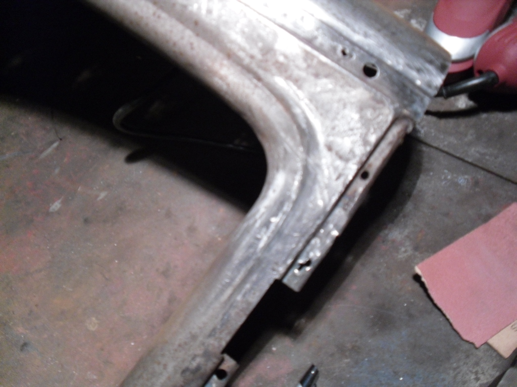

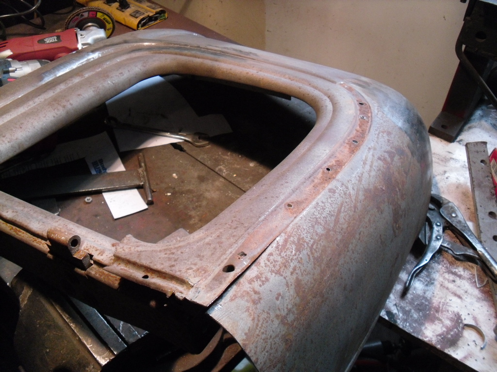

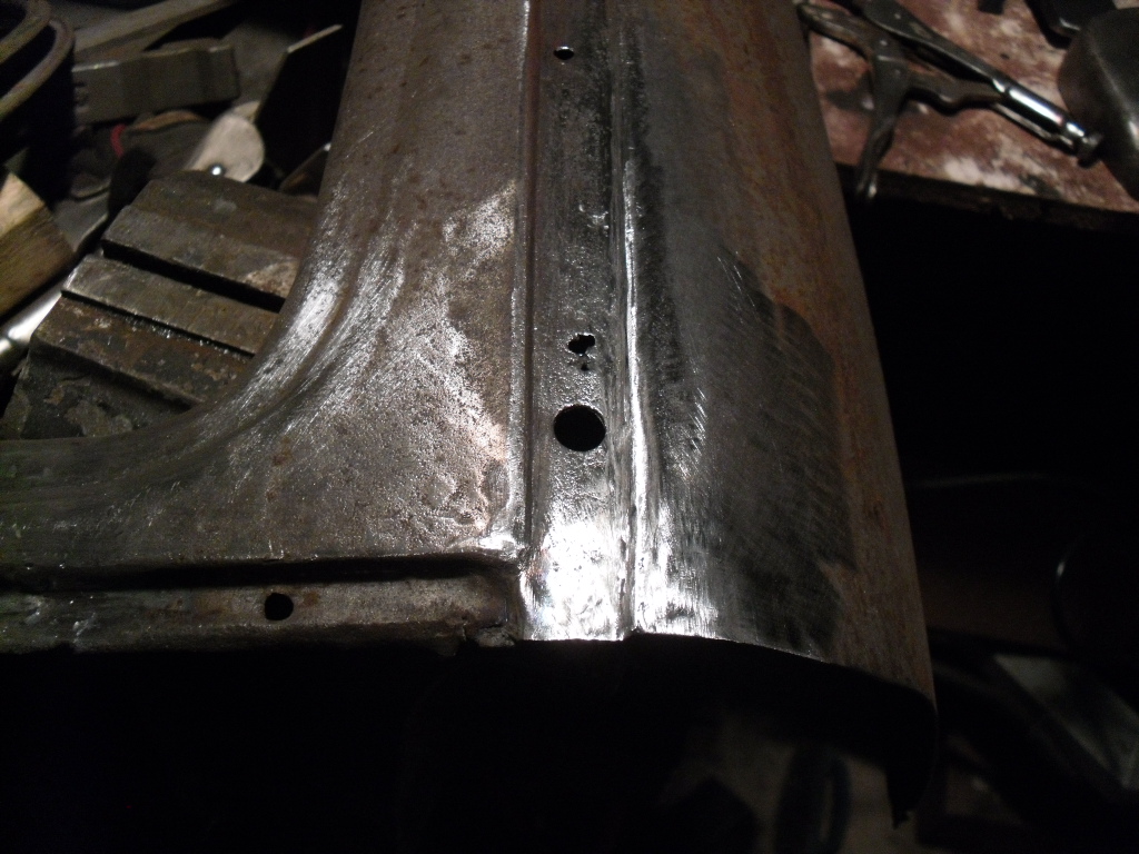

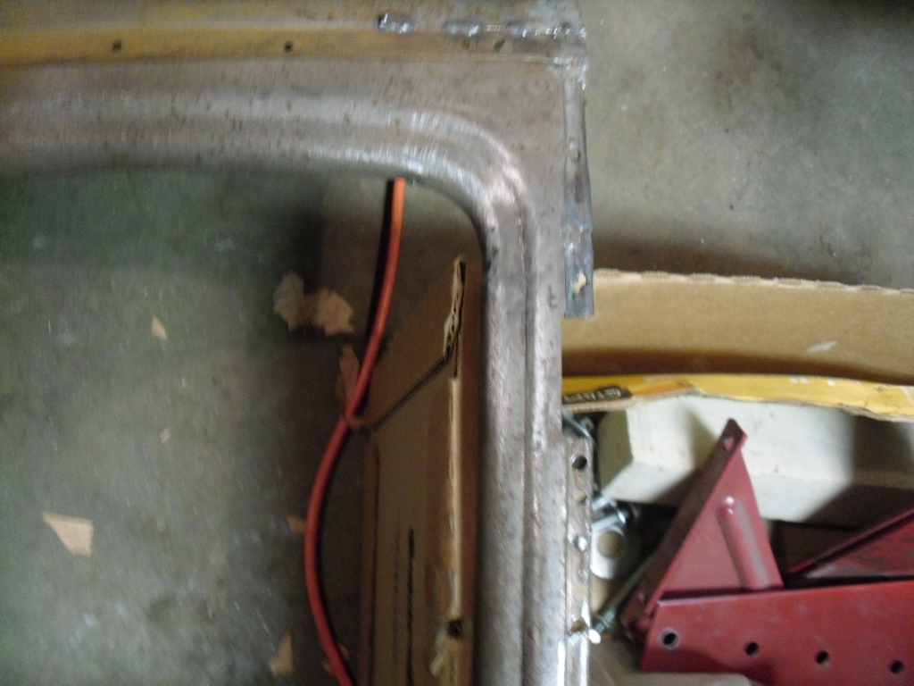

    I had a crack in the upper drip rail area that I had to tack as it was causing the stress on the lower panel. Once done I straightened the bent areas below and matched the outside body line. I then welded the crack with oxy aceteline so that I had a soft weld to work with. I t may appear so but It still did not line up correctly in the inside oof the panels but some minor hammer and dolly work and things began to come around.
  12. rcnut223
    Posts: 1,282
    rcnut223
    from wisconsin
    I finished welding the crack and filed and ground the weld. Thenreattached the drip rail.

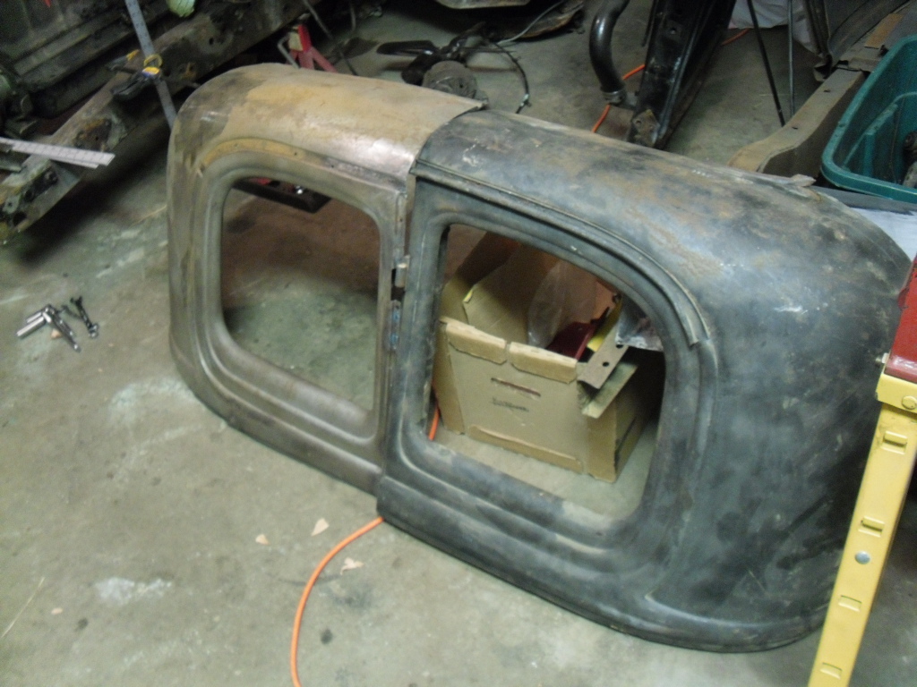

    Here it is sitting next to the the undamaged panel from the other side.
    Ready to be cut down, soon to become the rear quarter windows of my coupe.
    Just need some Qtr Panels!!

  19. couverkid
    Joined: Mar 30, 2007
    Posts: 1,134
    couverkid
    Only problem is you saved a 4 door window panel which is nothing like a 5 window.
  20. rcnut223
    Posts: 1,282
    rcnut223
    from wisconsin
    Coverkid
    I realize it's larger, with alot of work it can be made into a 5 window window. Check the thread by oz40 where ne built one of these.
