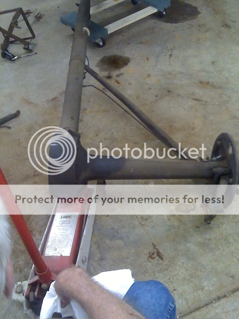

    Well, I got the rear-end all torn apart. Here are some pictures:
    And once I took the drive shaft housing off, I received the shock of a lifetime...the drive shaft and the pinion WERE ALL ONE SOLID PIECE:
    There was a problem. Luckily, 30 years ago my grandfather had planned for a broken drive shaft and had purchased a replacement which didn't have a pinion made on to the end of it. It was a shaft with 6 splines on both ends. So, I had to pick up the phone and order a 6 spline-to-6 spline coupler to join the new pinion to the drive shaft (notice how small it is!)
    After all that ordering and shuffling around, I have now got it all back together!
    Just a DIY tip...when putting your new race into the center housing for the pinion, it makes it SOOO much easier to put that race in the freezer for an hour or two, and then heat up the race seat with an oxy-acelylene torch just a bit. It literally drops right in! No pressing!
    God, I am glad this is over! I will let you guys know how this new 6.17 gear works out! I'm looking forward to the line jumps with it!

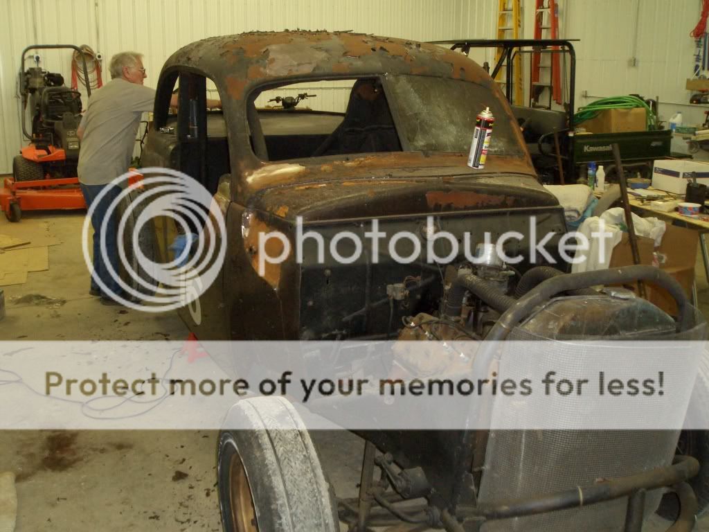

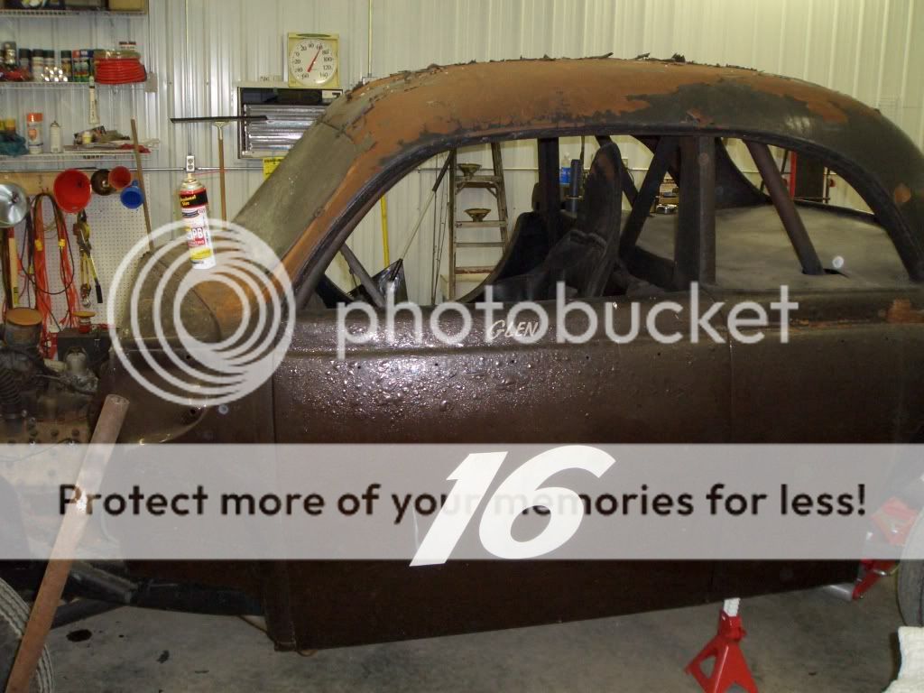

    Sure! Here are some pictures:
    She was in our garage when it burnt, so its not that pretty. We have lots of painting to do, I still have to replace the seat and some guages, and I also have a fuel cell to replace the old Johnson Marine outboard gas tank! I still have a little bit of work to do.

  15. Shame someone ruined a Merc coupe!!!!!!!!!!!!!!!!

    I couldn't agree more! When it was built, it was sitting (rotting) in an old chicken yard. My grandpa saw it, inquired about it, bought it, and turned it into a race car back in the 50s. It would have made a BEAUTIFUL resto-mod! But, racing brought in the money back then!
