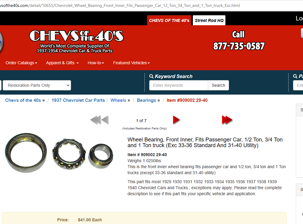

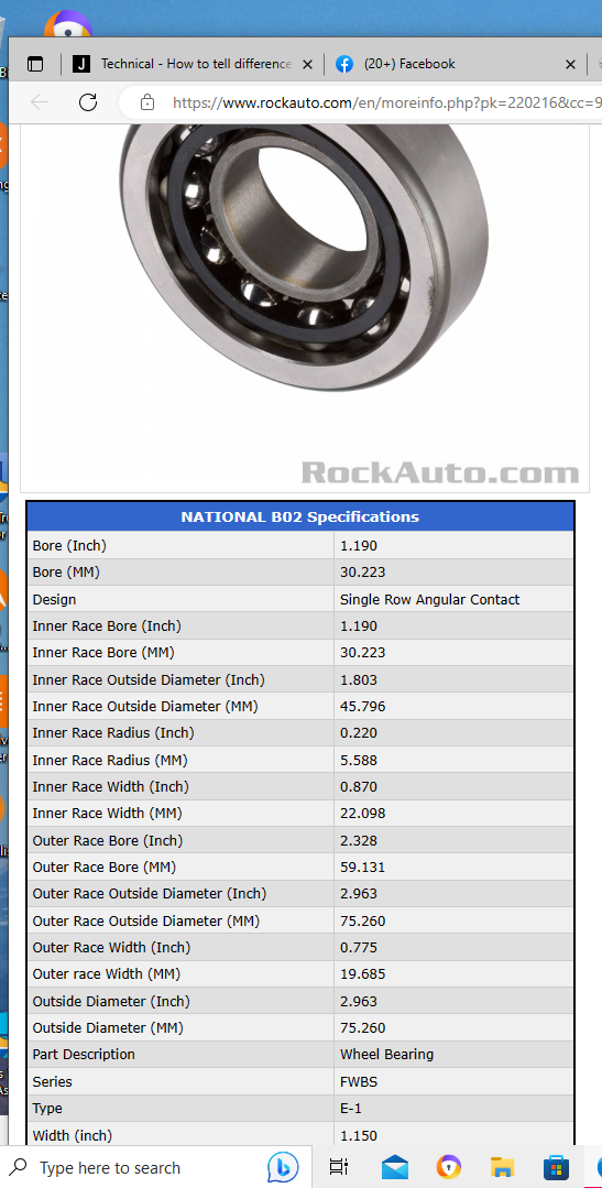

    What I am finding is inner wheel bearing ID.
    There is one inner wheel bearing that fits most 29/40 front spindles. The inner bearing is larger ID from 41 to 57. For years I thought 48 had a smaller inner wheel bearing ID until I figured out years later that I had a 40 or earler axle under the front of my 48 when I bought it. The outer race is the same and the bearing is the same but the inner race has a smaller ID for 40 and earlier. The bore for the inner race should be 1.190 Thats on a National B02 set.
    The 33/36 standard is by it's self. The Filling station didn't give bearing sizes nor did Chevs of the 40's for the others I was double checking the year to year differences there. Screenshot (1236).png Screenshot (1238).png Screenshot (1242).jpg Screenshot (1243).png
