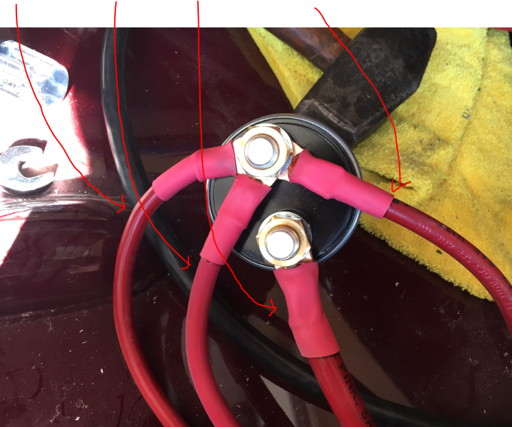

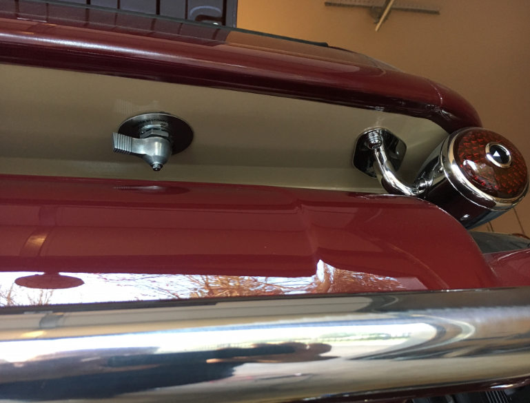

    Not bunched, "but I'm really not as cool as I'd like to be". It may be paranoia (need destroyer), but it wasn't difficult to drag the hot leads through the disconnect switch on the back of my car. Even Lola could do it.
    6 gauge heater circ./6 gauge fuse panel/2 gauge to breaker/4 gauge alt cable (so engine will turn off at this switch)
    all power from switch through this thing on the way to the battery so one day you don't self-destruct
    On/off, all power, running motor or not. Also nice for long term storage or anytime battery disconnect is necessary to service alt, starter, fuse panel, etc.

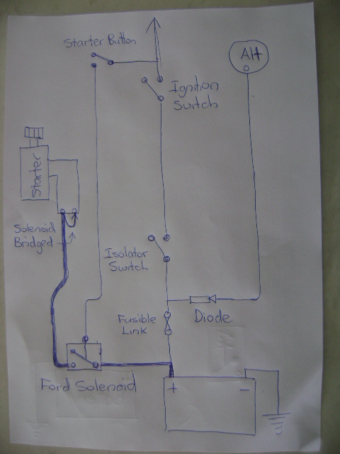

    You don't need a continuous solenoid [on my schematic] , the solenoid is only activated by the starter ****on.

    If you want to get really creative [refer back to my original schematic , posted here again]
    Replace the isolator switch with one of these single channel 12V 27A remote relays. You can disable your car from 100 yards away.
    https://www.ebay.com/itm/12V-Relay-...-Switch-Transmitter-Receiver-US-/182446258641
    I've used these on Garage Door remote repairs, my trailer winch getting updated etc [2 channel]
    You could use a 3 channel remote relay [1 as the isolator, 1 as ignition, 1 as the start ****on. the starter will need to be set as "momentary"] but this get me thumped with the "Ban Hammer" for being too off topic
    The isolator switch on my schematic is low current draw , but obviously headlights etc will need their own relays with fusible links
