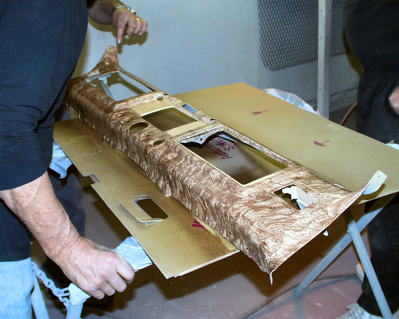

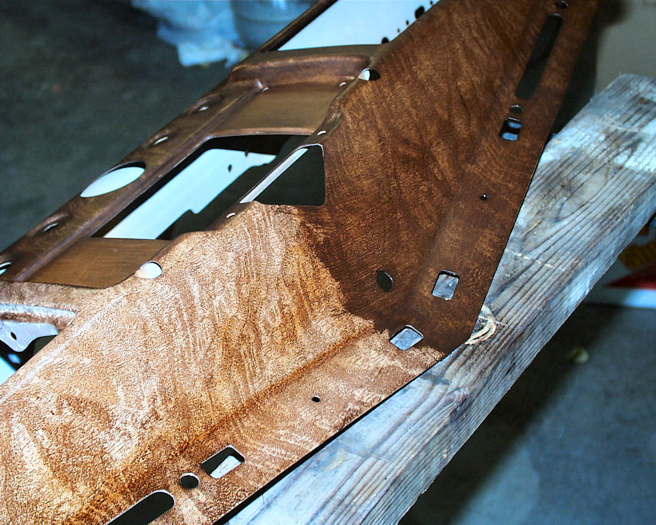

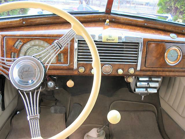

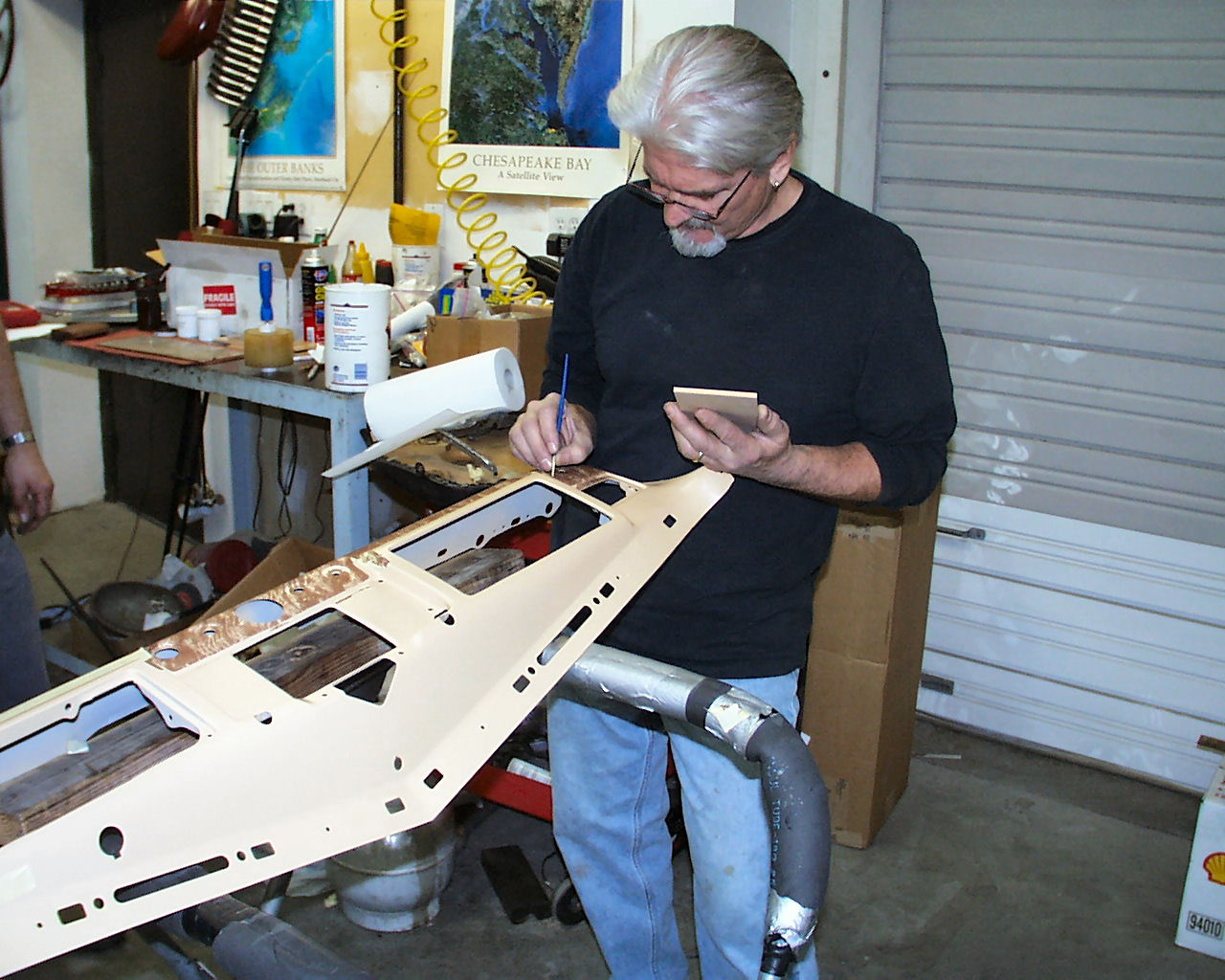

    Interior.jpg PIC00009.JPG PIC00010.JPG PIC00012.JPG PIC00015.JPG PIC00018.JPG PIC00019.JPG Dash 20.jpg Dash 22.jpg Dash 21.jpg dash 23.jpg When I finished my `38 Buick, the only thing left was the dash. It was origonally woodgrained, but when I got the car it had been painted red. Here are some pictures of how we woodgrained it. We used a woodgraining kit from Grain it technologies http://woodgraining.com/. It has comes with a lithograph plate and a roller to transfer the pattern onto the dash. the voids have to be drawn in with a brush. Thanks to my friends Mike and Richard Beggs for doing this for me.

    `38 Buick With New Sidemount Fender Installed.jpg Dsc00803.jpg Dsc00800.jpg DSC00964.JPG For those of you who want more details about how we did it, here it is. First we stripped and primed the dash. Then a base color, a pale yellow, was applied. It doesn`t show up in the pictures, but it was a pale yellow. I would have thought it would have been a brown or at least a beige color, but Mike works in the furniture industry and does this for a living so he knows what to do.
    Next, the pattern was applied with a roller. This is where real skill is needed. A lithographed plate with the desired pattern is inked and a gel roller (supplied with the woodgrain kit) was rolled on the plate to pick up the ink. The roller was used carefully to apply the ink to the dash, and the voids were painted in to match the grain.
    Then after the ink had dried, a stain was put on and when dry, clear was sprayed over it and the job was completed. It sounds easy when you say it fast, but it wasn`t. That`s why I let my friends do it.
