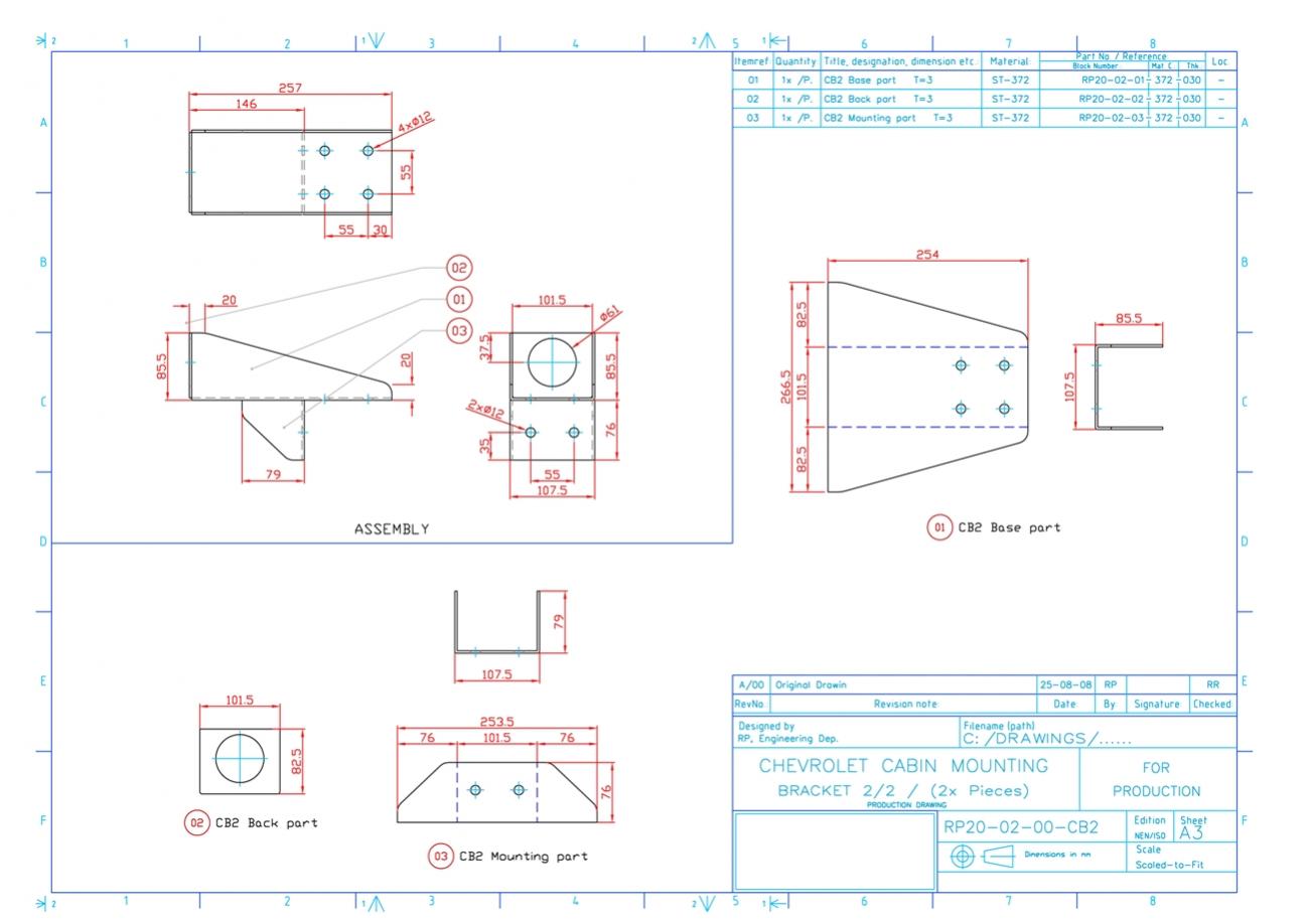

    does anybody have a drawing or the measurements. of this bracket...
  6. bigtumtum
    Joined: Jul 2, 2008
    Posts: 655
    bigtumtum
    My good friend Robin has made his first drawing of the bracket hope you guys like it

    ow the measures is in metric not in inch!!

    The bracket that you need measurements for is just a piece of 3" square tubing 14 inches tall overall. It sits 8 1/2" above the s10 frame rail. The brackets allow me to use the stock chevy bed crossmembers along with the stock bolt locations in the bed wood. Here is a pic of the brackets welded to the s10 frame.

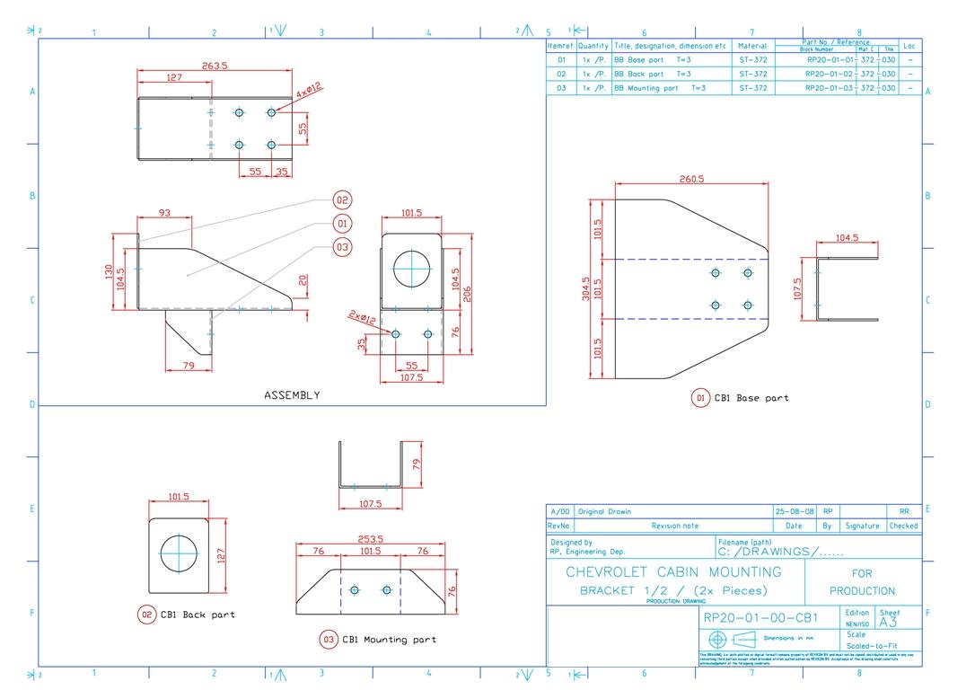

    Thanks jeff anychange that you would have a small drwaing that just works better...
    ow also here is the other bracket...

    if people want the original size of the drawing just email me.

    So jeff if i understand correct this picture below is how far the distance is between frame rails and bed..
    so its 3"x3" L= 14"

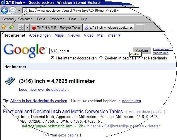

    Yes and no. Yes, the section of 3" tubing is 14" overall, and yes, the distance above the frame rail is 8 1/2", but that is to the top if the tubing capped off with a 3 x 3 piece of 3/16 steel plate. The stock AD bed crossmember rests on the top of the tubing. The 8 1/2" measurement is not from the frame to the bottom of the bed, but to the bottom of the bed crossmember.

    but to be honest too dificult to understand that you have a 3x3 3/16 on tope of the tube i still understand...
    so to be basic is correct please tell me if im wrong look at my drawing below..

    Already knows it... its 2" see the drawing People come and share this..
    i want also make a drawing for this part..

    Hey Jason you dont have too if you type it in google it will say it already for example googltje.jpg
