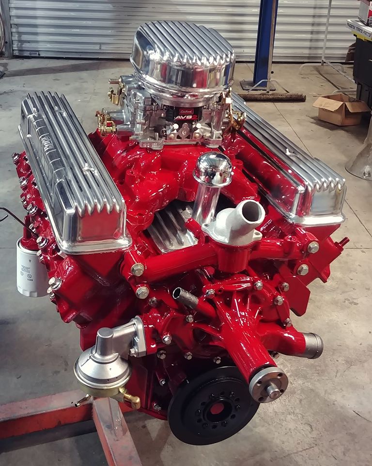

    Do these engines have hundreds of hours in grinding/filing or is there a trick to get one to take paint like this?

    Grinding, sanding, use of filler primers, are how they do it. Then you must never fire the engine. Oil, gas, and heat will make it look used quicky.

    Yes, they do. I have this affliction. I start with the bare block before machining. I use a stacked disc wheel on a 4.5” grinder. I take off the casting flash and remove the porous casting. Polish it until it looks like a new nickel. I use a die grinder with different sizes of flapper wheels.
    I repeat the process on the heads, water pump etc. I use an epoxy primer and paint with regular automotive paint.
    It takes a while, but to me it’s worth the extra hundred hours. I usually do it while I wait on parts or run out of money. It keeps me involved and moving forward even when the coffers run dry.

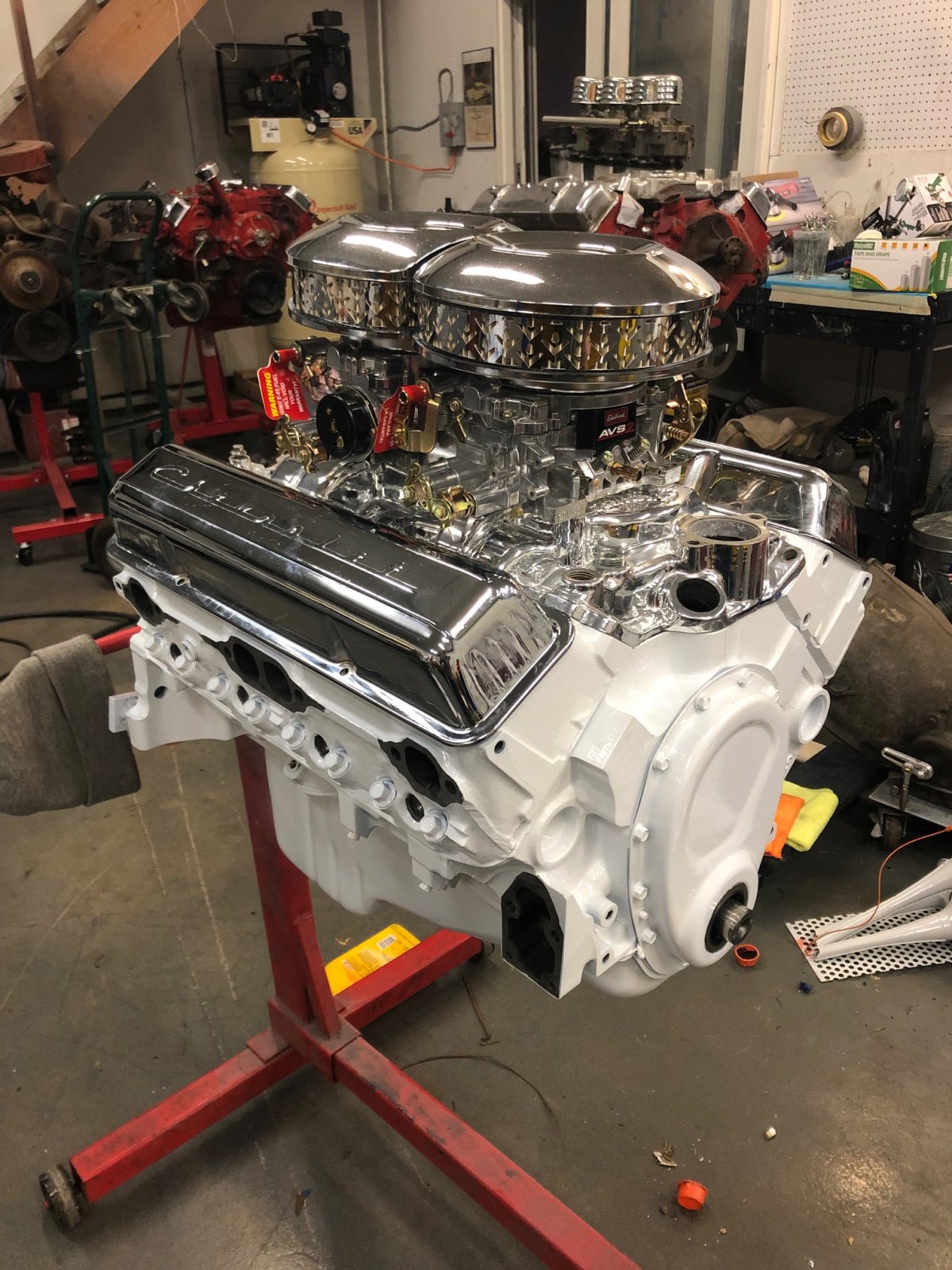

    Even if you don't want to go crazy grinding and sanding, there is a huge difference in the appearance of real automotive BC/CC versus rattle can engine enamel from Auto Zone.
    I did no sanding whatsoever on this 350 crate engine, and just elected to seal it in HOK KD3000 and shoot it in Shimrin2 BC/CC. If the engine was in a hot rod that was out in the open I'd have probably done some block prep and sanding, but stuffed in a full bodied car with full accessory drive, it's just not that important to me.
