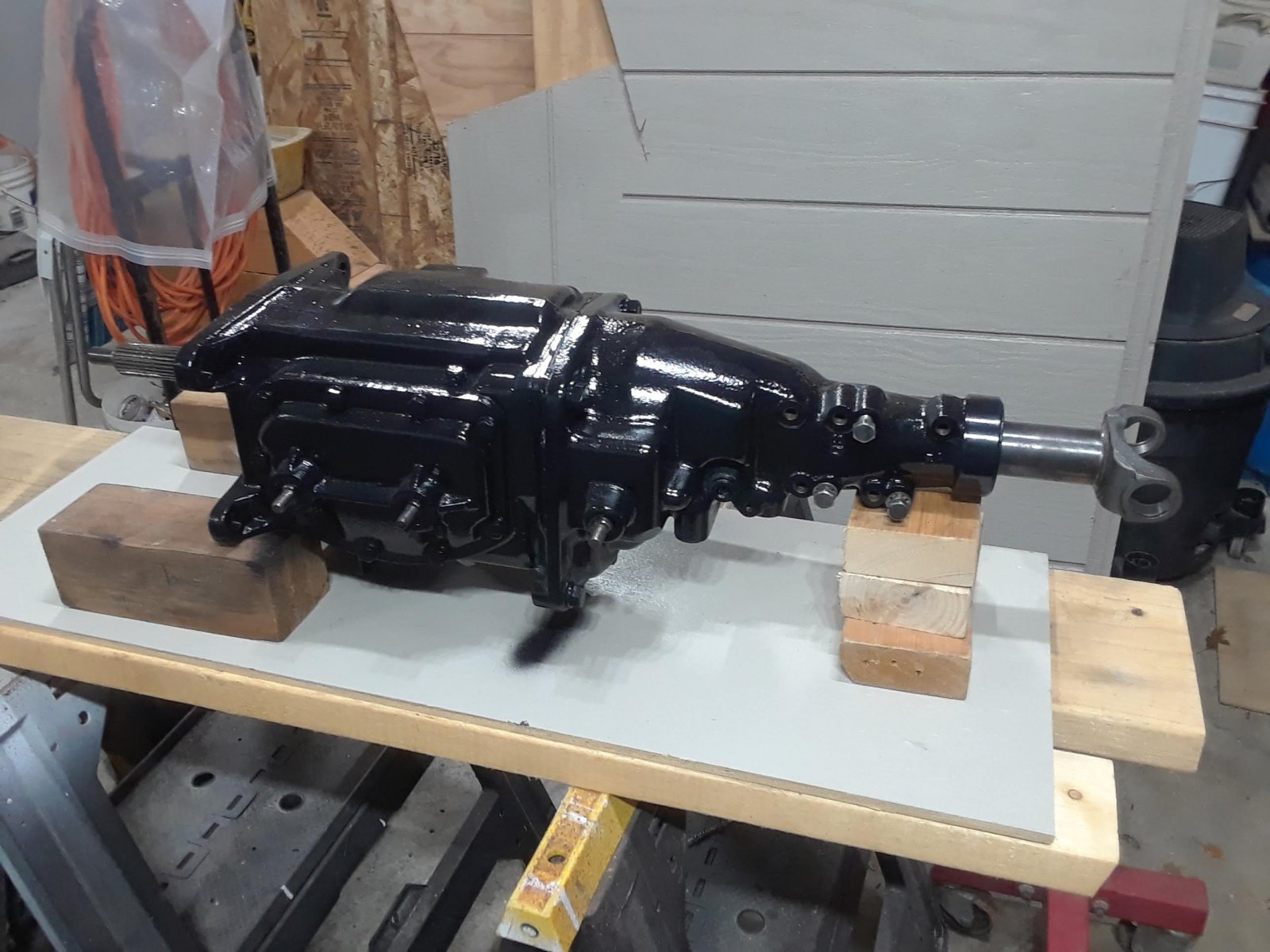

    A thankless PITA job and dirty. I sanded the casting flash etc off (Not engine #), linished the block and radiused the corners before a light coat of 2-pak etch primer etc before 2-pak colour and clear. I didn't use etch primer on my other SBC and after 15yrs of driving it's starting to de-laminate in a couple of places. P.S. When the transmission was rebuilt I changed the extension housing (C4 Corvette) and output shaft as there's no provision for transmission mount on case as Corvette used a 'C' beam mated to IRS. You'll never see any of this when in car, just me being pedantic.

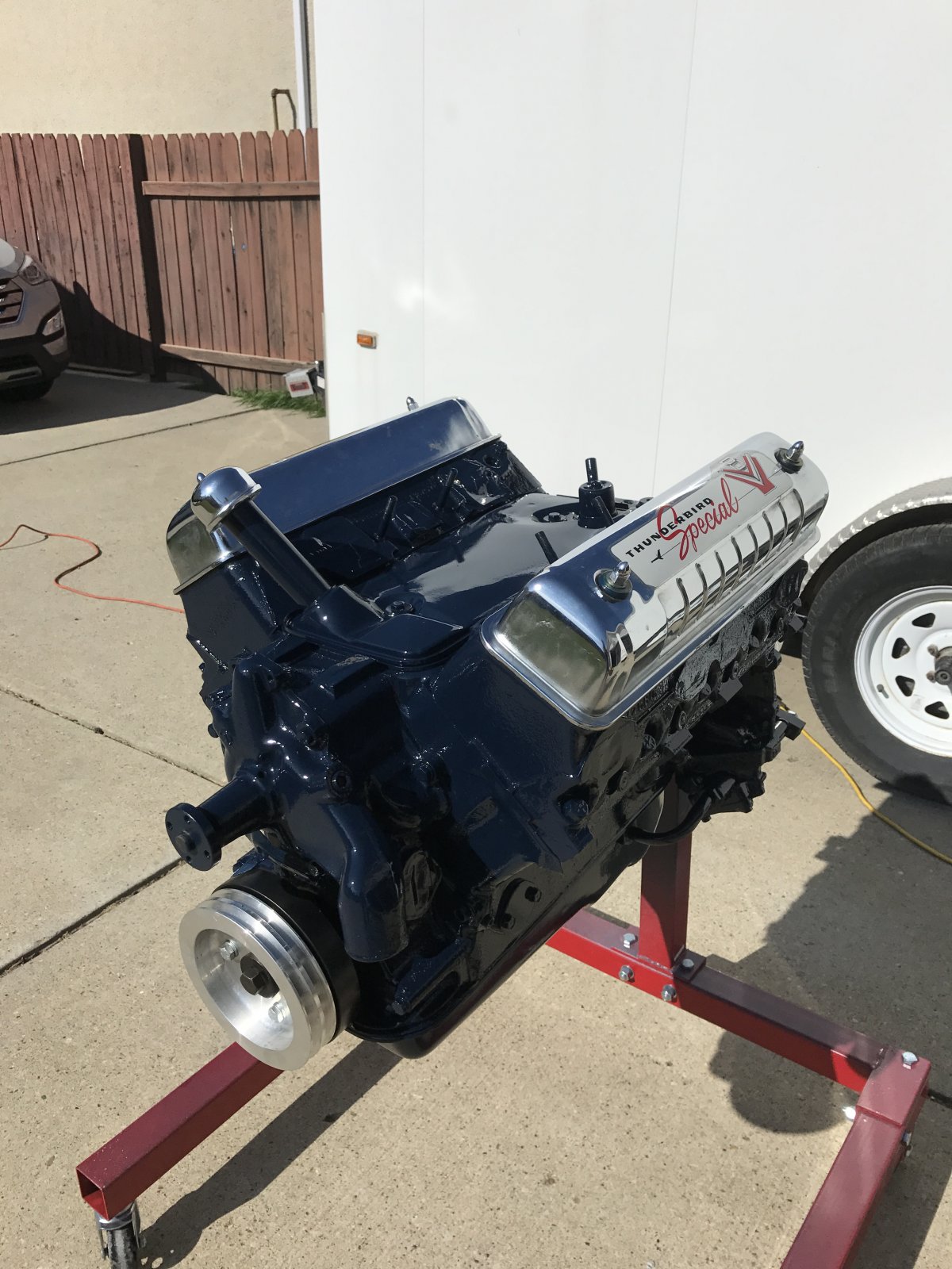

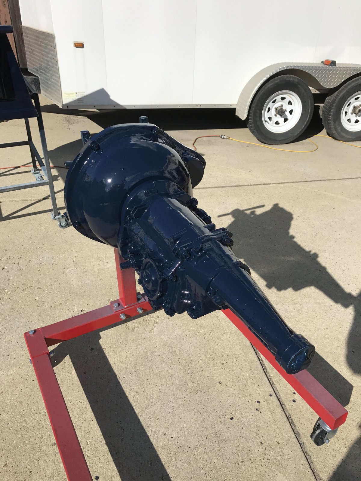

  29. Blue One
    Joined: Feb 6, 2010
    Posts: 11,512
    Blue One
    from Alberta
    I just Painted the engine and transmission with the same Single Stage Acrylic Urethane in Washington blue.
    Then the appropriate use of chrome , polished aluminum and ceramic coating.
    Along with details to keep everything clean and tidy.
    Not that difficult and I felt it was appropriate for the Tim Mcmaster Y block for my 26 RPU.
    7EBF965F-E82C-44DD-9F18-1A5DA779EF1A.jpeg AE174C22-0895-42D7-86C3-A9C21DE82320.jpeg D7303A06-1B2E-44CF-920B-BF57C4EFACCA.jpeg 1CBFE672-CD68-4981-8EDA-71662BDBDE0D.jpeg F14C123E-7A1A-4259-9F58-8E2504199818.jpeg 4501F018-CBCF-4968-85E8-D8031131BEAF.jpeg
