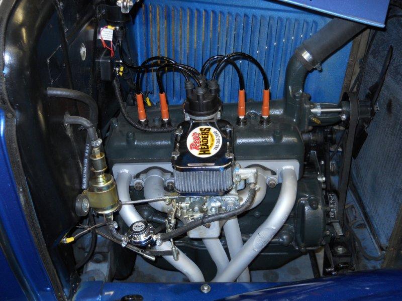

  5. Should be good for 85-90 mph... tops.
    Sam

    IMHO, the worst thing about a 4 banger is the transmission.
    Change out the original******* for something with an O/D and a few more gears in between and it will make a big difference to performance of even a rock stock engine.

    "Good for 85-90 MPH"... Oh hell, let's drive to the salt and get right in the "Two Club". Not real.
    65 MPH and you will feel like the flywheel is gyroscopically on its way into your lap.
    Rods will be singing the Babbit Quartet, and oil pressure will be somewhere on the extreme left hand side of the gauge. The ride will be rough, you'll feel it from the toe board to the steering wheel. But keep your foot in it. You'll know where the weak link was...it will tell you with a resounding "Thump!" I've heard it. And fixed it.
    That '4-Barrel is like a tough guy from the 'thirties. Challenge it and find out.
    That 'banger is excellent in its own window. It is a window of the past, rice burners will be passing you on the Australian Causeway like a freight train passing a tramp. (U.S. Folklore of the '30s, '40s, and '50s; in the late '60s, the railroad cut most interstate, so...)
    This car/engine is a stoplight hero. Zero to 50, then it's dead. Don't lead it to an early death just to prove something. This ain't the '40s, and the competition is no longer Babbit Bearing stovebolts and 21-stud flathead V8s.
    Remember your A-B-Cs. 'Always Be Conservative.' Your engine will last that way.
    "This 4-Banger can do 85, I'll betcha"
    Bet high, cuz if it does the fix won't be cheap.

    There is a guy out in Banning CA with a pretty stock model A RPU 4 banger and runs an O/D 5 speed*******, he is always running the I10 at 70mph.
    He does runs down to San Diego with it.
    If you keep the rpm's down with correct gears, good top speeds are still achievable.

  24. I am not disagreeing with you Sam, I know the bangers you build and run can go 85+ but a semi modified engine not built to withstand the RPMs will not for long. I had a buddy tell me I was doing 75mph one night and I called********* maybe 65mph. It was an all out sprint downhill for about 2 minutes. I got to the gas station and my banger was******** oil out the rear main it was so thin and hot. Touched the radiator and it was full of a bucket o' steam. Enjoy how fast I go slow was my thoughts after that jolt.
    Granted I have read Winfield used to do 100mph sustained on his way to the lakes back in the 30's :D. This one will probably be more then capable of 85 for awhile.-Weeks

    Weeks46...You are right on the money....would drive mine for three quarters of and hour to a cruise night and always had a old piece of carpet to catch the oil from the rear main...the rod end babbitt bearings wont last long if you over rev it especially if you have lifted the compression...great era hot rod ..but wont take to much abuse if you thrash it... Doug

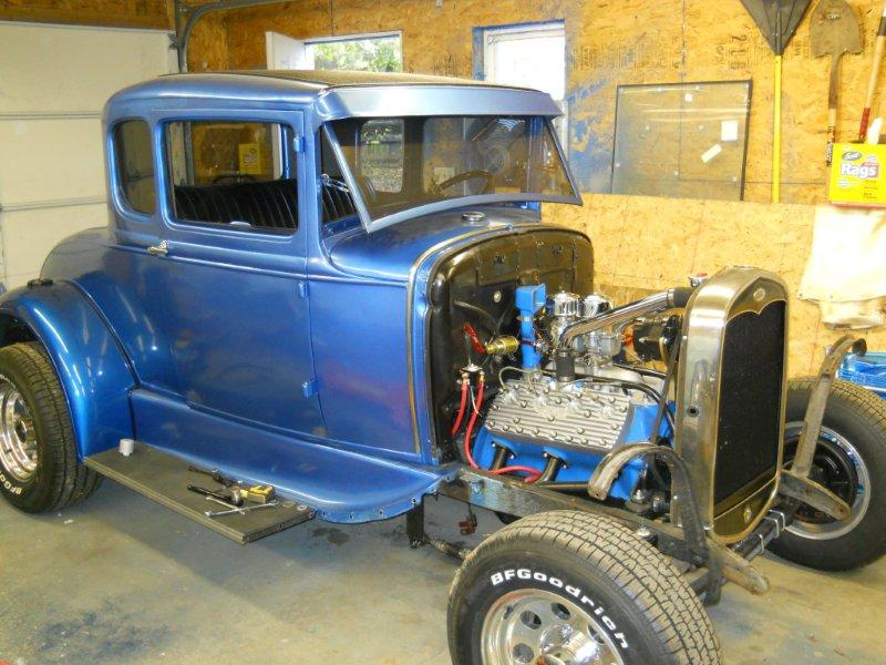

    It might not be a high speed ride, but the "Smiles Per Miles" will be over the top! You'll never have so much fun going slow.:D Here's my nephew's banger, it zips along pretty well.

    The green speedster posted by 64crump (mine) is all babbitt, dipper rods, C crank. I rarely turn it over 4,000 but do the Antique Nationals, hill climbs, etc. regularly with it, no problems. I ran Bonneville and many drags with my Cook, all babbitt but full pressure oiling. I turned it 6,000-6200 at the drags, 116 mph. What finally failed? The Buick pistons! I'm running the same block, crank and babbitt mains but now with Eubanks rods on the salt now, 165 in August. In my book these things are very reliable!

    i had one in my '31 coupe not what i expected. now i have a flathead now i got what i expected. it had a weber set-up, centrifigal electronic ignition,040 over,reds 2" two out-let dual exhaust with two smitty glas paks it did sound like a small block but didn't have any R.P.M.'S 3,000 tops not for me. looked great.
