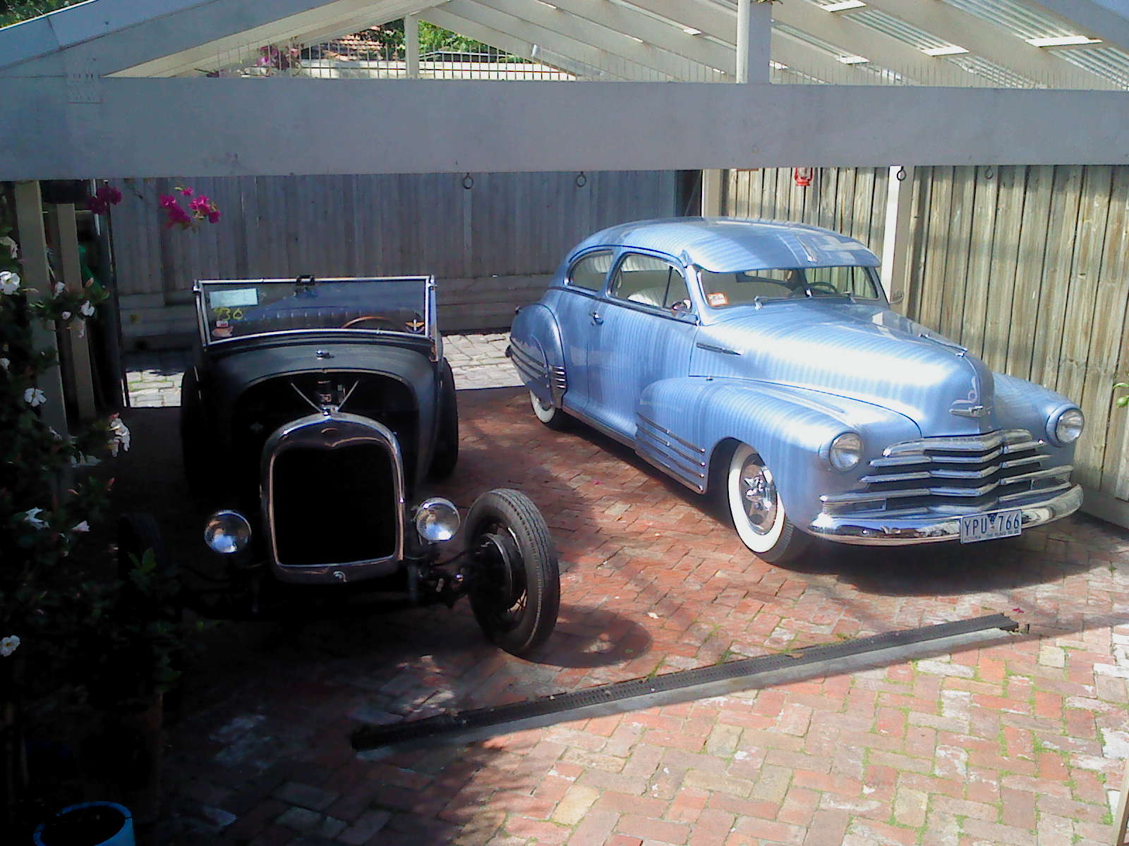

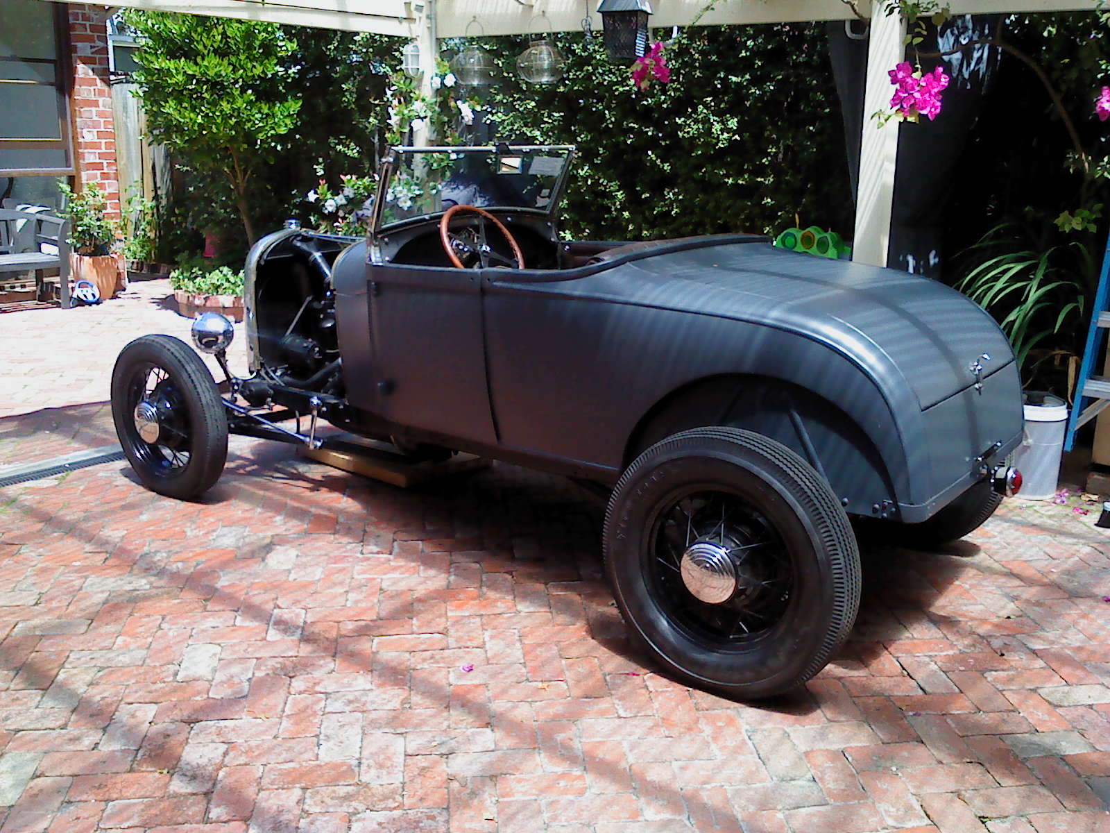

    Thanks for all the posts and great advice. Finally got the all clear from the Feds here in Melbourne Australia to pick up the roadster which landed all the way from California 4 weeks ago. They had flagged the container the Rod was in for some reason and held the shipment up for a month while they moved like molasses to process the cars.....geez!
    Anyway, to the seller credit and to my great relief the roadster is as good as I dreamed it would be. Runs and sounds fantastic! That little banger has the nastiest sound and hops along very well. I've included some pix taken at my place. Thanks again for the words of encouragement and advice, and thanks again to 21stud for being such a stand up guy!

    Hi Chris...It looks great ... I'll bet your heart was racing when you first to it for a spin..you will get a lot of enjoyable hours of hot roding out of it...Doug

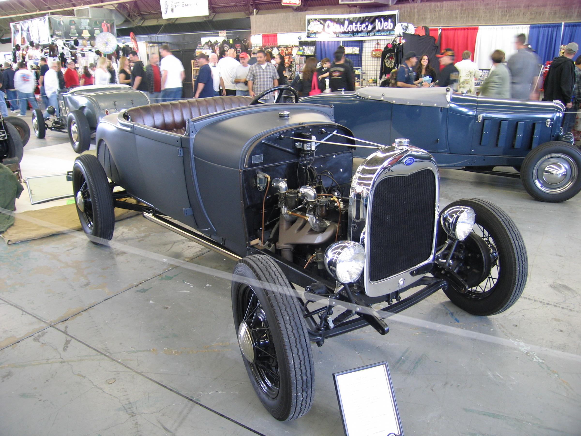

    Here are a couple of shots of your new car at the 2010 GNRS

    Dirtyest Devil, glad to hear that you're still running the banger even when you have the Cad and flattie V8 in sight tempting you. 64crump thanks for the killer pix of the roadster. And Morac41 thanks for the words of encouragement amigo!

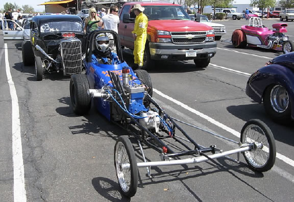

    Here are two. Both are OHV conversions. The Rail is an Alky car. Fun times!
