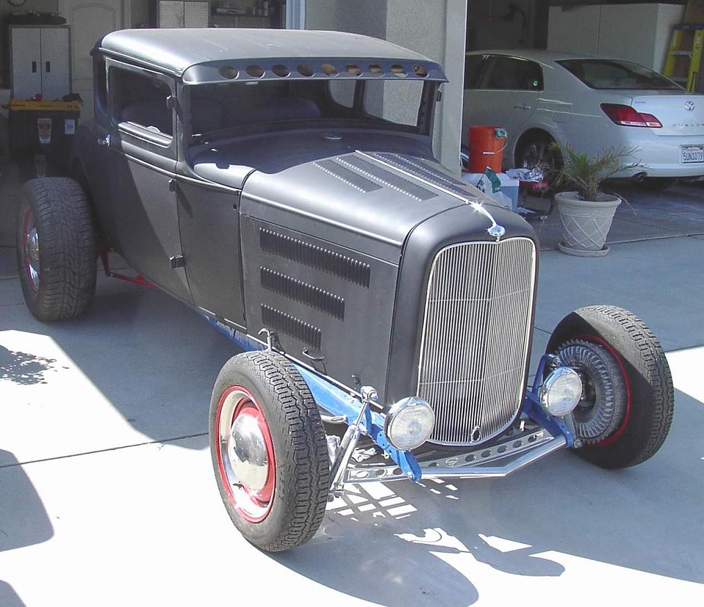

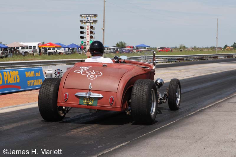

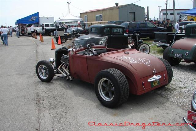

  12. Here's the Most common shot of my car...!:eek:
    Note: the rear of the car is narrower than the front and it's not as wide as a sedan that will sit lower than my roadster.

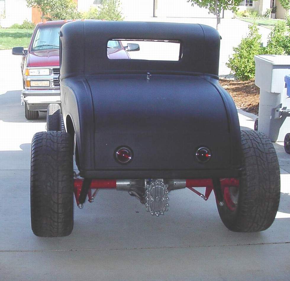

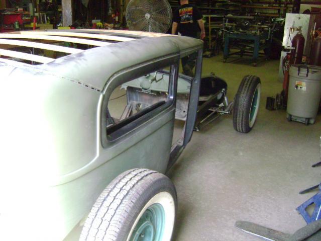

    I'm using a 55 chevy rear with the same backspacing channeled and zed 4" and 8"[​IMG]
