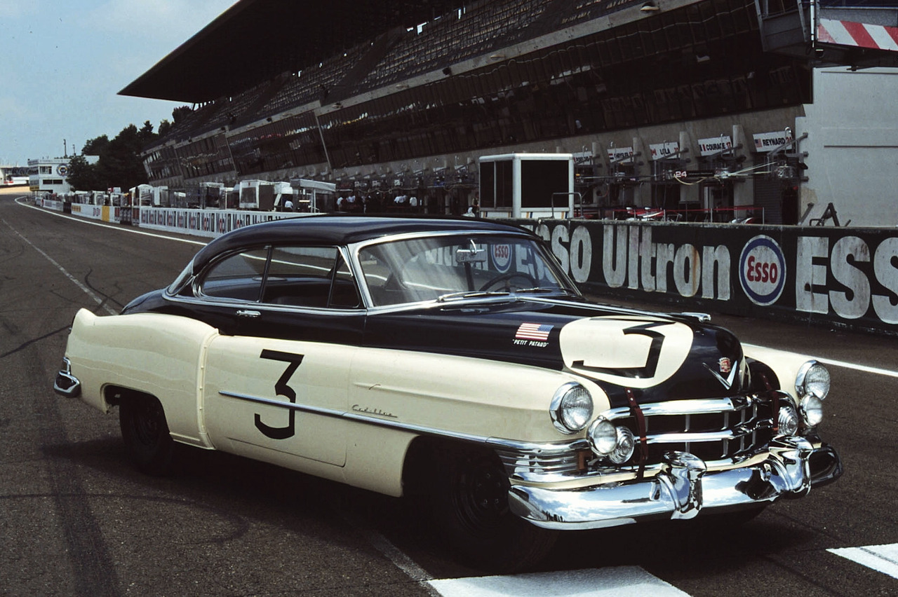

    Would this have had a Cad/LaSalle tranny?
    ( serious question, I really don't know what cars they were OE in )
    BTW, if we keep this On Topic for the HAMB ( mid '60s or earlier ) the engines had broader powerbands and the transmissions had fewer gears.
    So 24hrs of racing would have taken less shifts than they do today.

    From the factory, it did; a side shift Cad. Not sure if that race car had one, but what else would they have used back then.

    It had the optional 3 speed stick.
    The Monstre had the same engine and driveline.
    Edit.
    I don't have the Info in front of me, but if I remember correctly, the Cunningham Le Mans Cadillac was really close to stock.
    Le Monstre had an engine that was souped up more, and the aerodynamic body, but underneath it was basically the same car.
    So since those used the Cad/LaSalle gearbox ( thanks, F&J ), that answered the question.
    A Hot Rod transmission held up to the 24Hrs of LeMans.

    An interesting read is the build on those Caddy racers. I sure the gear boxes were helped by the somewhat low RPM of the Caddys used during the long race. The big Sedans were kept to around 4400 rpm maximum.And the engines were pretty close to stock...
    http://www.briggscunningham.com/home/le-mans-era/lemans50-html/
