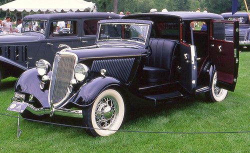

    Said to be the most beautiful Model A, was Gordon Buehrig's custom body convertible.
    He worked as a stylist for Duesenberg at the time and wanted a custom built automobile. As he could not afford a Duesenberg or even an Auburn, he bought a brand new Model A and had the body built to his specifications in the Duesenberg shops. The management approved, and gave him the work at cost price. Some of the shop workers thought he was "nuts" to cut up a brand new car!
    turboroadster and Model T1 like this.

    He started with a Sport Coupe because it had the cowl and windshield he wanted. Cut off the body back of the cowl, and moved the cowl back 4". Extended the controls, and built a new hood. Then built the rest of the body to his drawings. Using the same materials and built to the same standards as a custom Duesenberg body.
    The picture shows the car when it was first completed, with heavy duty tires more suited to a limousine or light truck! Gordon thought they must be the best tires because they were the most expensive. But soon found out they were way too "heavy duty" for alight car and gave a terrible ride. So he went back to the stock type tires. More expensive does not always mean better.
    Model T1 likes this.

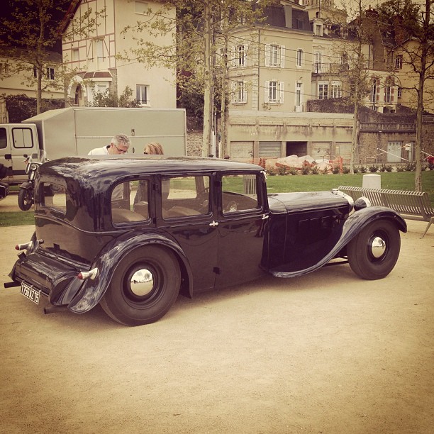

    Some rich people had small town cars or limousines built specifically for city use. The Brewster company in New York specialized in this type of work. In the 1910's they made small custom body limos on imported 4 cylinder chassis. Later they made custom bodies on Ford chassis. It was a way to have a car that was handy in city traffic but with the comfort, quality and prestige of a custom built car.
    They were far from a cheap car but, you could always transfer the body to a new chassis when the old one wore out and save some money that way.
    Have seen pictures of one of these mini limo bodies they built in the teens, that was transferred to a Ford chassis in the mid thirties. When they took off the fenders and running boards you could see where they shimmed up the frame with wood blocks to make it fit.
    Here is a 1935 Brewster on a Ford V8 chassis. Note they even changed the front fenders and grille to their own design.

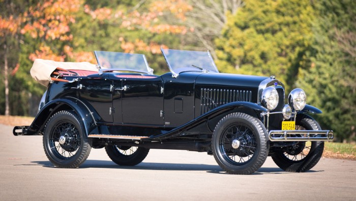

    Edsel Ford's 1930 Sport Phaeton has a look with swept back fenders, BIG headlamps, long hood and cowl, slanted windshield. Also like the windshield wiper in the cowl.
    Imagine it with out the back seat and a treatment on the trunk. Maybe someone will pick up on that and photo shop it.
    I have a '31 68C slant windshield Cabriolet and that modification by Ford is the biggest thing alone for looks on a Model A ever in my mind.
    kidcampbell71 and Dave Mc like this.
