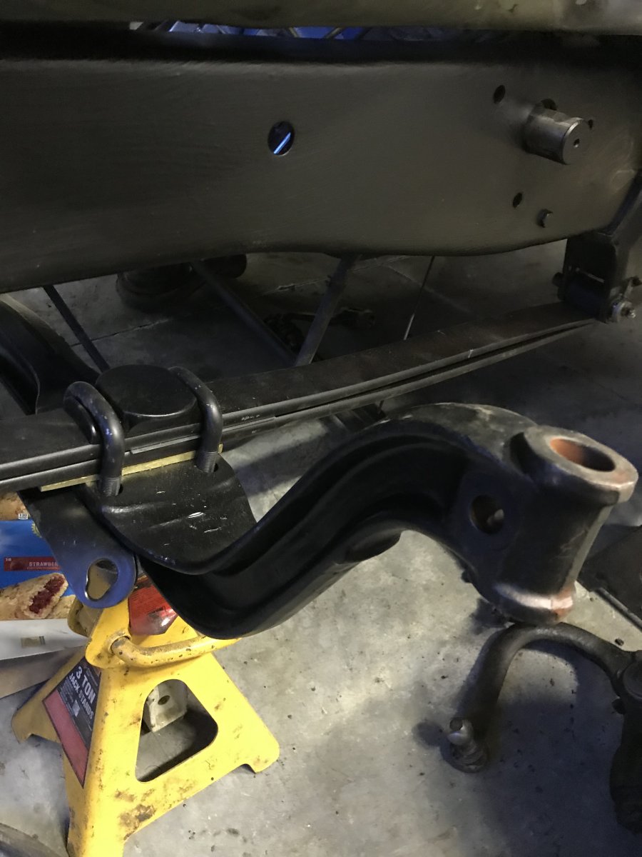

    i installed can original Ford axle I had dropped in my 56 F100. I am ****oning it all up, but ran into a snag. The truck had a fresh king pin job and the pins slid out of the original axle no problem, on the dropped axle, they will not go in the axle. I think maybe the heat from dropping warped them a smidge. I honed and used a rat tail file in the boss on one side, but man that’s taking forever.
    Has anyone ever ran into this problem? What did you do to fix it? The king pin is 7/8 of, was thinking of picking up a 7/8 drill bit and cleaning the holes up that way?

    Thanks guys! Sounds like I will invest in a reamer. Funny thing, I have done quite a few dropped axles, this is the first one I have ever had this problem. The pin starts but only goes maybe a 1/16th ways down the hole and stops. I tried tapping it, and it's just way too tight. Popped the pin out and two sides of the bore had drag marks. So I think it is ever so slightly egg shaped. I tried a rat tail file and a wheel cylinder hone, just to see if it would clean up. But didn't make much progress. So I stopped.
    For king pins, my dad has an engine building business and I usually use his Sunnen Hone to do king pin bushings. It's slow but works very well. I thought about taking the axle there and using it, but honestly you guys are right, I should have a reamer on hand.
    Also to clarify, I am not sure on the pins and if they are oversized. I have a dial indicator but it is not digital, so it works about as good as a tape :D Another tool I need to invest in. But again, usually these things go together pretty easily for me in the past.
    As far as the guy who dropped it, I am not slighting him at all. He may have checked it and it measured fine up top. Or maybe my pins are indeed oversized? Regardless, this is something I can fix, so no harm no foul

    I looked at McMaster Car, the bummer is, early Ford king pins are .812 diameter, and F-100's are .8595. The reamers for the early Ford size go up to .8438...meaning the reamer for the F-100 would not work for early Fords. It is what it is, but kind of a bummer to buy a reamer that may only be used once. If it fit early Fords, I may wear it out :D

    Thanks guys. I found an adjustable reamer at Granger here in town for 35.00 that goes .8438-.9375. I'll spend the big bucks on the early Ford version beings it would get used a heck of a lot more. So I ran out and grabbed it. I also picked up a digital caliper and guess what...these king pins are .010 over, (.8695) explaining my issue. I am glad @oldtom69 mentioned it, I know oversized king pins are made but I just didn't think about it last night. So, I will ream the bores and it should be like new again. Thank you everyone for the help, I truly appreciate it. Like Gene Winfield says: "every day is a school day"
