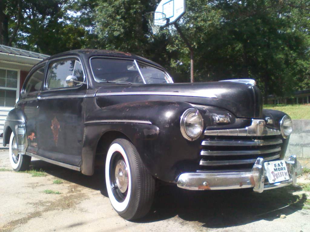

    Looks like they just sprayed a half ass semi gloss black over the original Henry black. The MEK didn't have much effect. 600 paper knocked it down pretty quick. Just the high spots.
    Drove it to our local Sonic Cruise In last night.
    Here's the "So Far".....

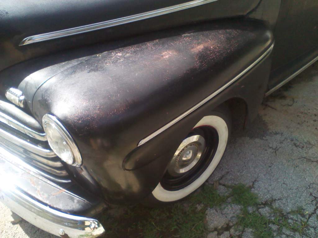

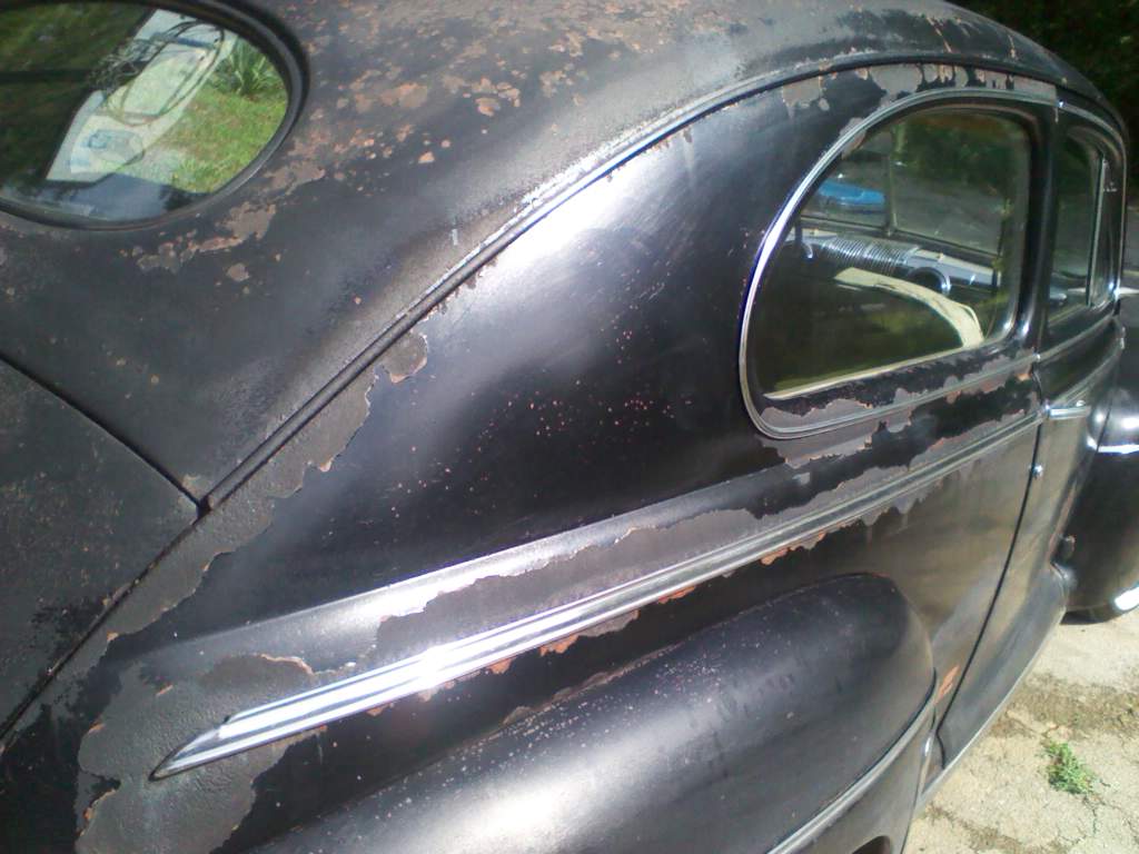

    Well, I've been on vacation for the last 10 days. While most people would be doing nothing but enjoying the beach... I've been thinking of the best way to attack this paint.
    After taking all suggestions to heart, I chose to strip the top layer with EZ Off oven cleaner. Then work on the problem areas with Green Scotch Brite pads and CLR.
    The EZ Off cut that shit like butter..... :D The green pads are WAY abrasive, so I took it easy. The grey pads might have worked better (in my situation), but I didn't have any new ones. After ruffing up the RR fender for absolutely no reason, I put the pad down until all the paint was back to the original.
    The ruffed up area will slick back up pretty easy, but it scared me when it dried.
    Here's a few "So Far" pics. As you can see, that Henry black is alive and well with some shine still left in it. A couple of the pics show where I stopped stripping, and the difference between the two.
    I went VERY slow and only did small spots so I wouldn't damage the original paint.
    What do you guys think so far?

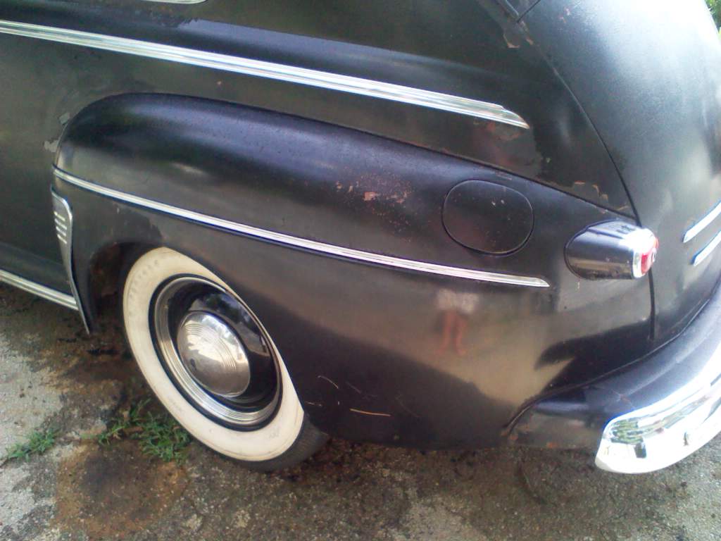

    A few more.

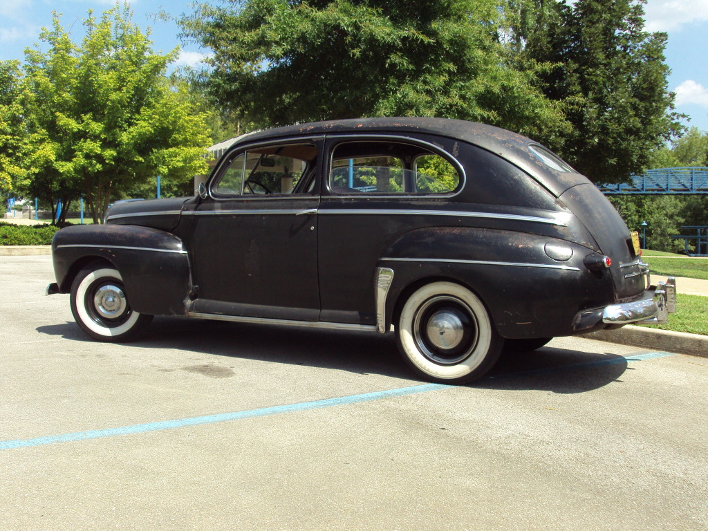

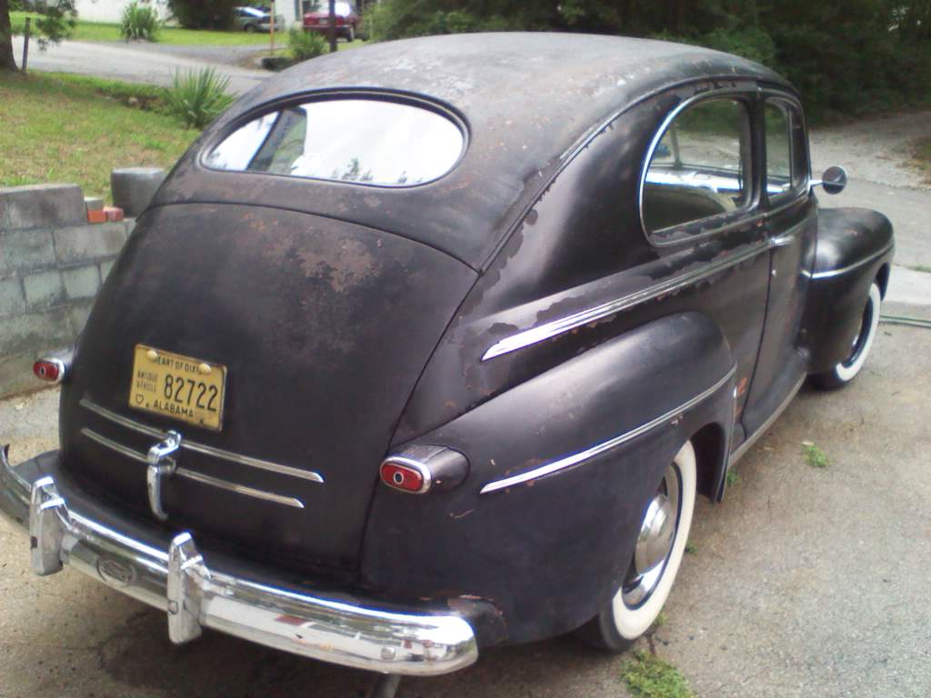

    Here's a few more pics from this week. These are from a really nice river park on the way home from work. I still have a little more work to do on the doors, trunk and roof but it's getting there. It looks to have had some sort of logo on the doors (same kind of spot on both doors). Hopefully I can save it.
