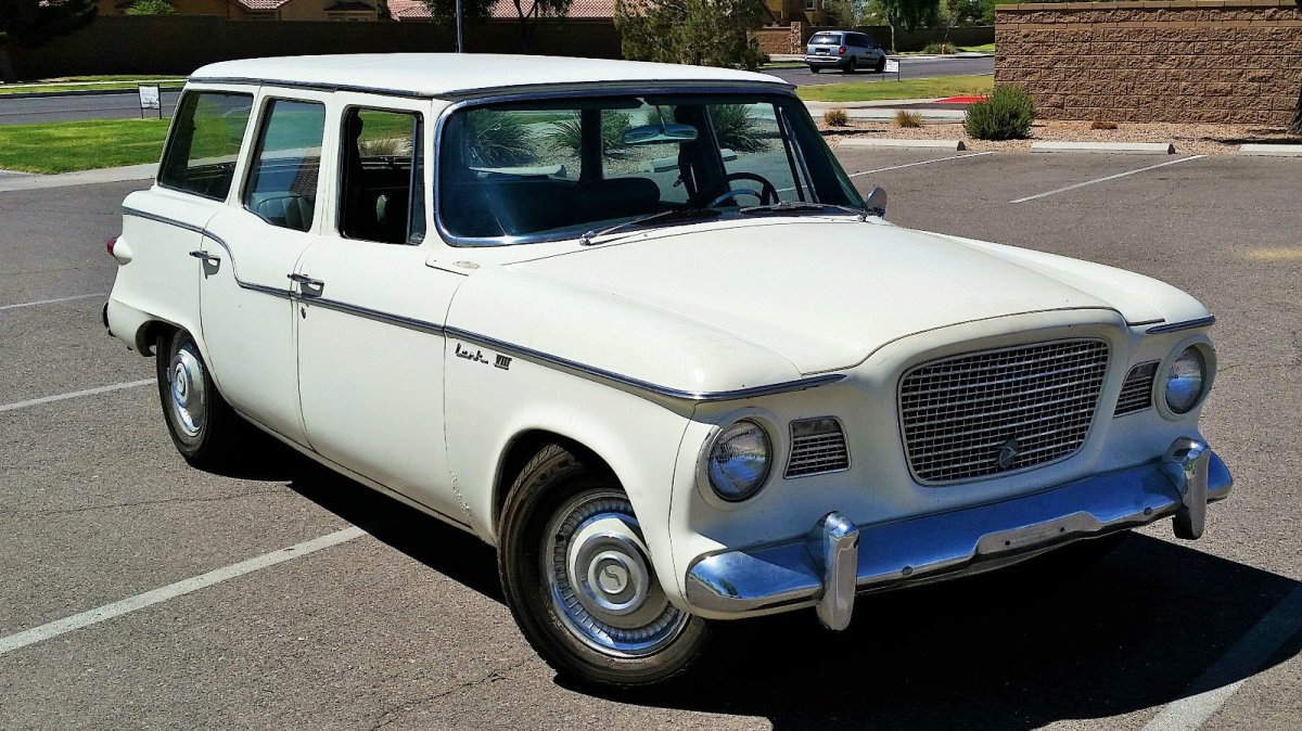

  29. Here's the last one I did, white is hard to see shine especially in pictures. It was totally chalky and dull when we got it, to the point where any greasy hand would just soak into the paint. I didn't put too much effort into it, if I spent more time it would really glow (but I hate polishing/waxing) and it still looks good/beads water a year later.
    Before:
    After:
    mbstude likes this.
