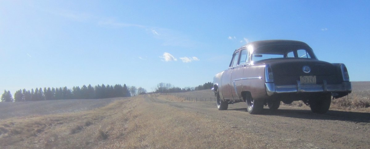

    That car looks pretty shiny already to me. I've been using some pretty harsh stuff on the Merc. It has sat outdoors for the past 46 years and I figured I had nothing to lose. Started with a dirty rag soaked in diesel fuel to get the initial dirt, moss and lichens off. Then on to Turtle rubbing compound to get the oxidized layer off. In places it was down to the red primer but even that shined up some. I even went with steel wool on the worst patches with good results. This is a survivor family car so I'm keeping it original as much as possible. Merc April 1.jpg
