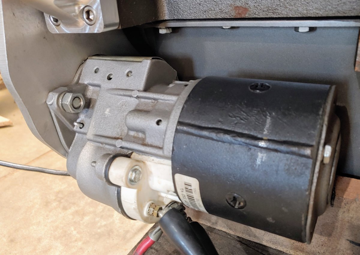

    More pics:
    Chavezk21 and Dino 64 like this.

    PROGRESS!:)
    I followed @triumph 1 , @TRENDZ , @Desoto291Hemi and @squirrel 's advice, grinding out one side of a starter mounting hole ~1/8" with a demmel.
    Before:
    After. The duct tape was to keep dust out of the solenoid:
    Then I mounted the starter & bumped it over. The pinion teeth *fully meshed* with the ring gear & spun it, but still didn't retract.
    Also, the gap between the pinion & ring teeth was still too small to squeeze a paperclip between 'em.
    I had to quit for dinner but tomorrow will grind the hole a little bigger so the teeth mesh with a paperclip size gap between 'em.
    Thanks everyone for your ideas.
    Having to modify a stock part to work with a custom part is truly annoying, but I guess sometimes that's just what ya gotta do.:rolleyes:

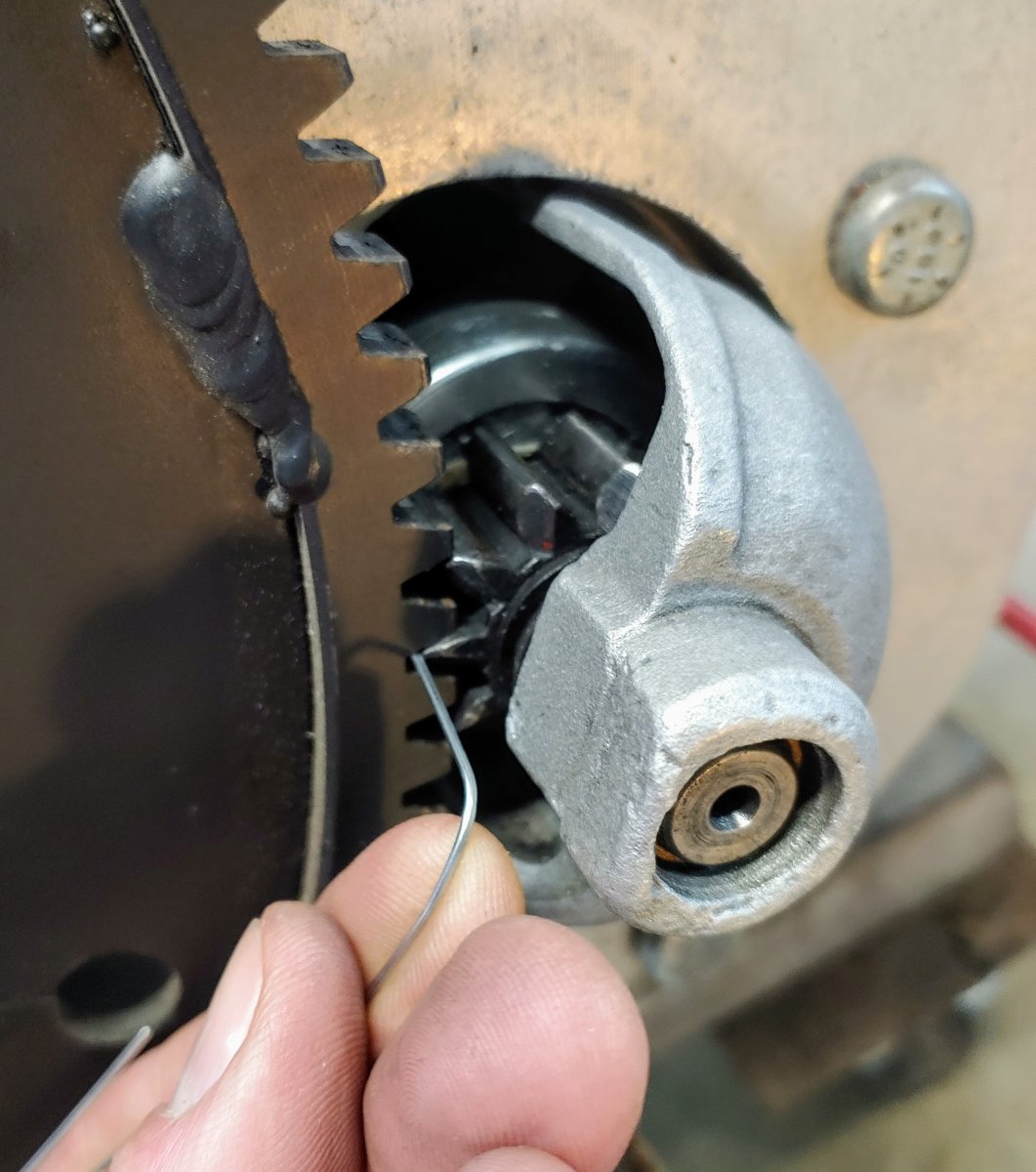

    After a little more grinding in both holes, l mounted the starter & bumped it over. The teeth are fully meshed & spin the flexplate but they still don't *disengage*.
    Shouldn't they??:confused:
    A paperclip slides easily between the teeth tips & roots:
  24. Just Gary
    Joined: Oct 9, 2002
    Posts: 6,049
    Just Gary
    Of course the solenoid retracts the pinion if the engine starts running.
    But if it *doesn't* start running (like in this case) is it normal for them to remain meshed?:confused::confused:
    I can easily disengage them by pushing/prying the pinion with a screwdriver.
    Or is the solenoid faulty? The AutoZone tester claimed that was included in their starter test.o_O
  25. I don’t think a paper clip is enough clearance,,,,,,it will fit at the bottom of the tooth basically .
    Try a little more,,,,,,then when it works,,,,,measure your clearance .
    Can you use a tool of some kind and make it retract,,,,,you are getting close I believe .
