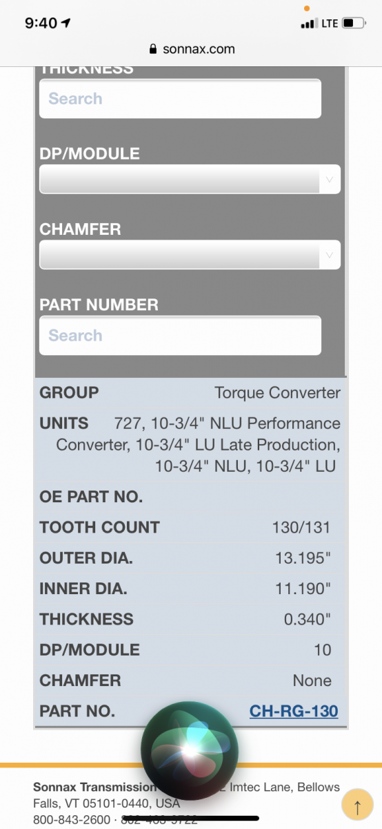

  2. https://www.sonnax.com/ring_gears
    Go check that out
    You’ll find this /
    And google mopar starter ring gear 131 teeth
    You’ll find a lot of people have them, don’t know why, others telling them they counted wrong and starter engagement issues.
    Those that report back get cured by going to later model mopar mini starter.

  3. 31 Vicky gave you some exceptional info there. I checked what I have and 10 tooth bendix and a 131 ring gear is spot on. With the O.D. option of .010 you may do better with the latter starter as mentioned. The 10 tooth Bendix I have is 1.290 O.D. and is second gen starter. What it sounds like and as Squirrel mentioned is the Index boss to help with dial in of the 2 items. All Mopar bellhousings have them see photos. Your 700-R does not.
