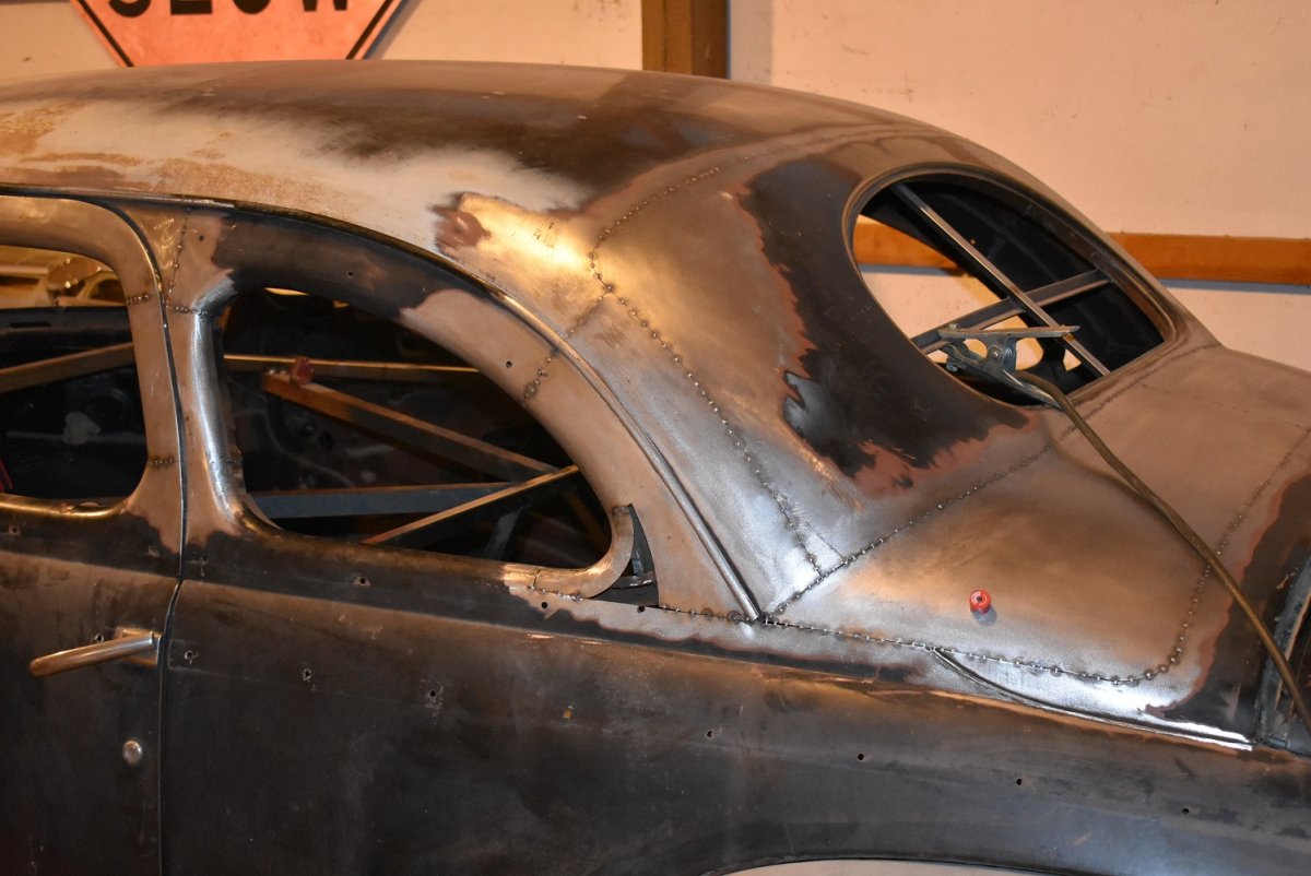

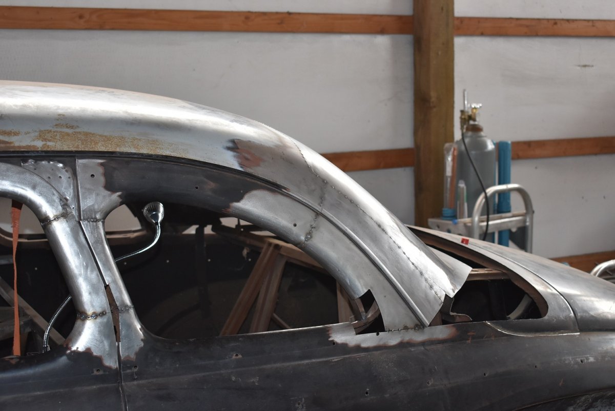

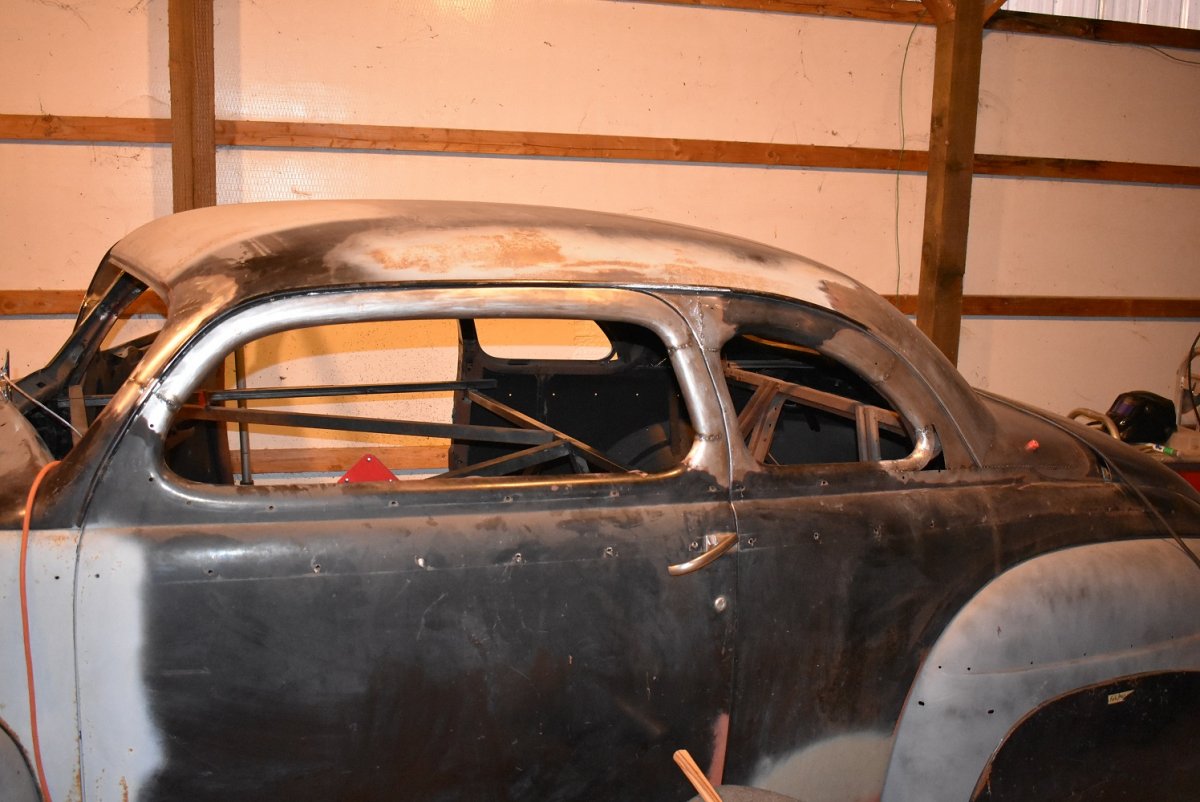

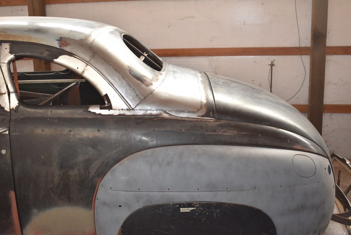

    Haven't been on HAMB for 5 years or so, but I have been working on Howland for a while on-and-off. Thought I post some of the progress.
    I'm building Howland to be a driver. Mild chop, pre-war stroked flattie with a 5 speed. Ford 8" rear on leafs.
    These roof lines are ugly stock and my biggest challenge was getting rid of the hump over the p***enger seat.

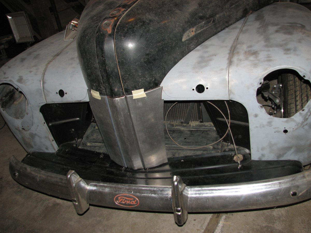

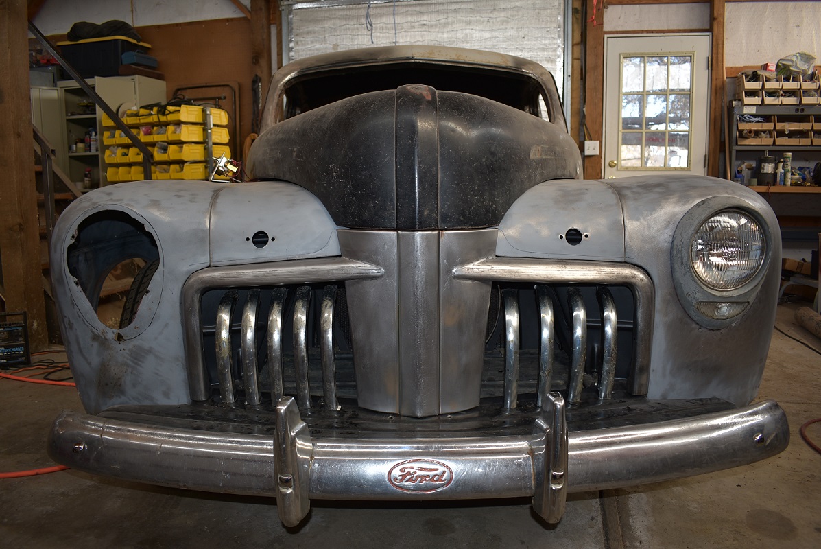

    I stopped working on Howland months ago when I got discouraged over the grill area. I had parts I liked – '50 Desoto grill, '41 Ford surround – but it didn't come together well. The Desoto grill was a bit too extreme for the subdued build and didn't tie in to the hood well. I recently had the idea of a Pontiac-like waterfall front. Here is the start.

    More work on the Grill. Surround sides are modified '41 Ford pieces. Teeth are from a '50 DeSoto.

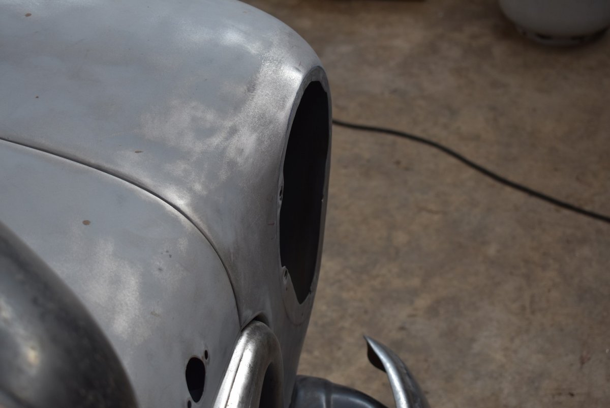

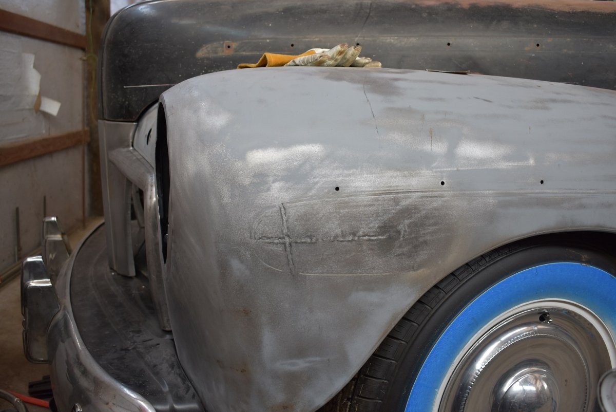

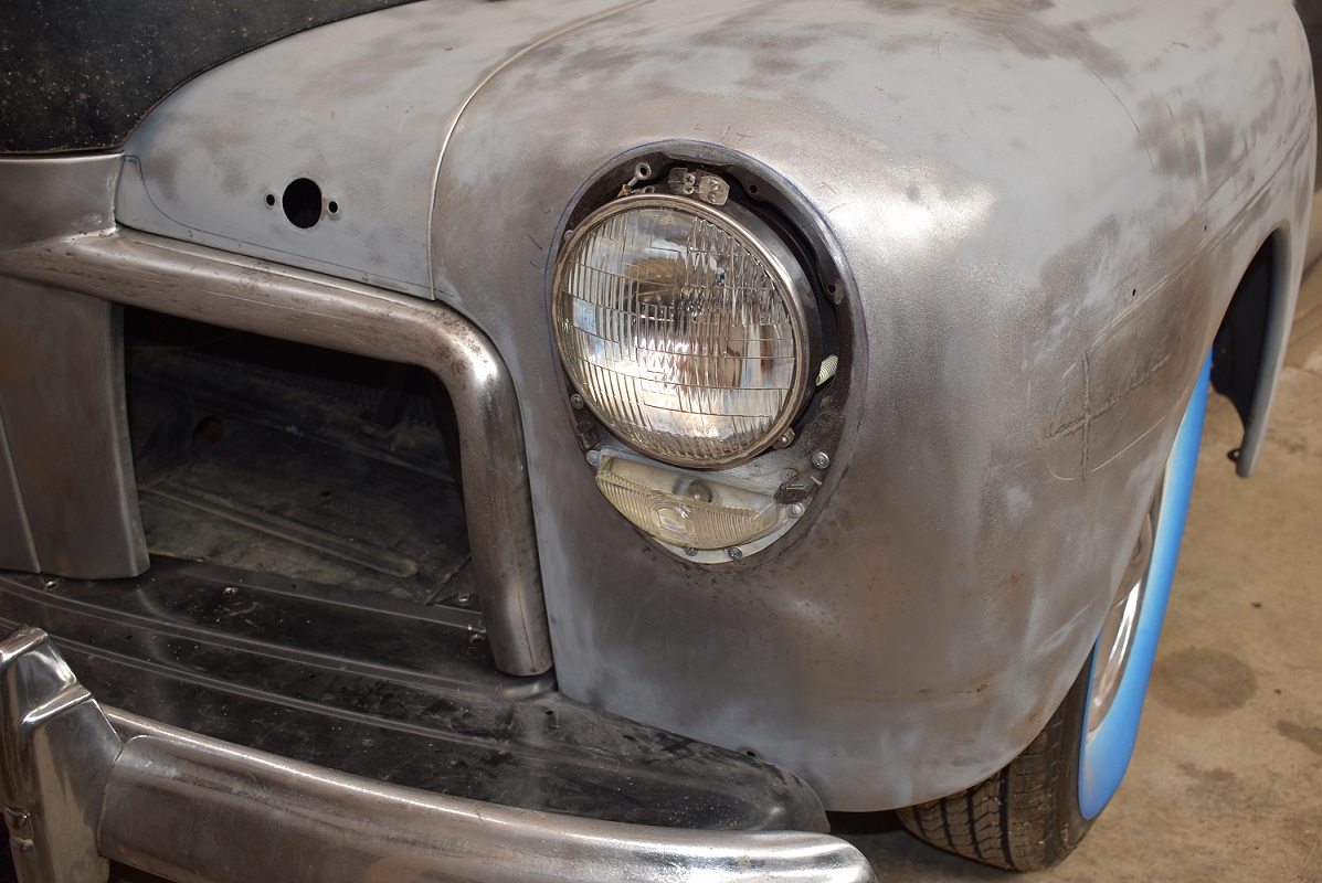

    Started work on shaping the driver's fender for the '52 Studebaker headlights. The fender falls back right under the stock round headlights, so the fender had to be brought forward almost an inch below the bucket. I like to use heat when stretching that much. It makes it much easier and a smoother result.
    Started forming the flange.
    I won't be installing the fender trim, and I didn't like the looks of the body line / shelf and scallop so I rolled it out and shrunk the scallop area.

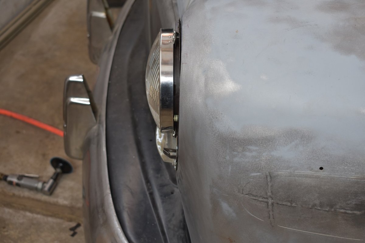

    dcadwell

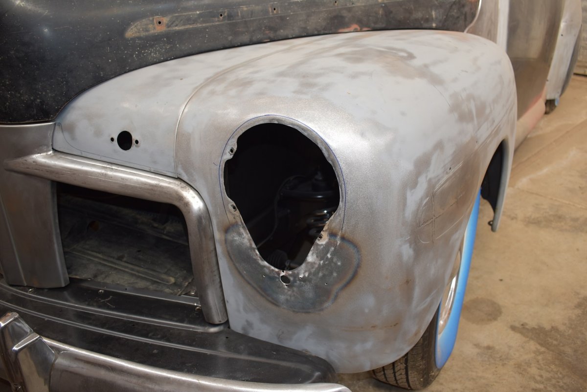

    Further tuning of the shape and flange.
    The Studebaker bucket and trim ring actually flare forward a little at the bottom. More metal moving and blending.

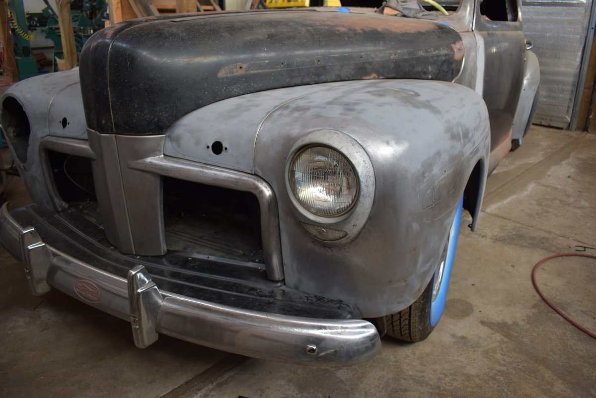

    Bucket mounted. No cutting or welding to re-shape. Just forming.
    Still need to add 3 tabs at the top of the opening to pick up the last 3 mounting screw locations and **** it in tight .

    Need some advice - 4 grill teeth or 5? Thanks!

  18. Copper Top
    Joined: Aug 18, 2007
    Posts: 485
    Copper Top
    Doing good work, goin' to look good, different. I think 5 bars look good.
    Outback, Cgrgrspt10 and Grumpy ole A like this.
  19. lippy
    Joined: Sep 27, 2006
    Posts: 6,855
    lippy
    from Ks
    Great job ! I think it's going to look great! I like five in the grille. :cool:
  20. RMONTY
    Joined: Jan 7, 2016
    Posts: 2,678
    RMONTY
    Five in the grill looks better. 4 looks too wide to me. Great job overall!
    town sedan and chryslerfan55 like this.
  21. rustydusty
    Joined: Apr 19, 2010
    Posts: 2,567
    rustydusty
    What an awesome grill! I like the 5 teeth. Is the whole thing going to be chromed, or are you going to paint the center?
    town sedan likes this.
  22. dudley32
    Joined: Jan 2, 2008
    Posts: 2,163
    dudley32
    five for sure...
  23. razoo lew
    Joined: Apr 11, 2017
    Posts: 542
    razoo lew
    from Calgary
    I’m with the 5 guys. Looks great!
  24. dcadwell
    Joined: Mar 13, 2014
    Posts: 125
    dcadwell
    Thanks - I had figured on painting the center / surround piece body color. Chrome! It would be a lot of chrome but I think it would tie it together better. Just the teeth and headlight bezels being chrome might be too little.
    Thanks for the idea!
    Outback and chryslerfan55 like this.
  25. dcadwell
    Posts: 125
    dcadwell
    Thanks everyone - can't argue with unanimous. 5 teeth it is.

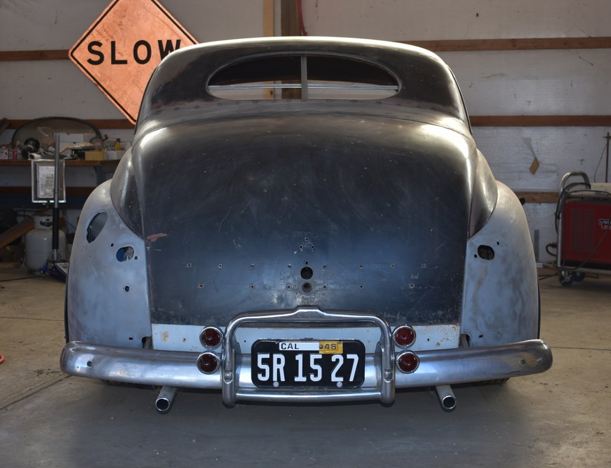

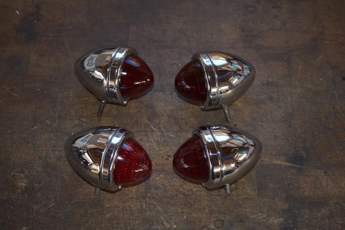

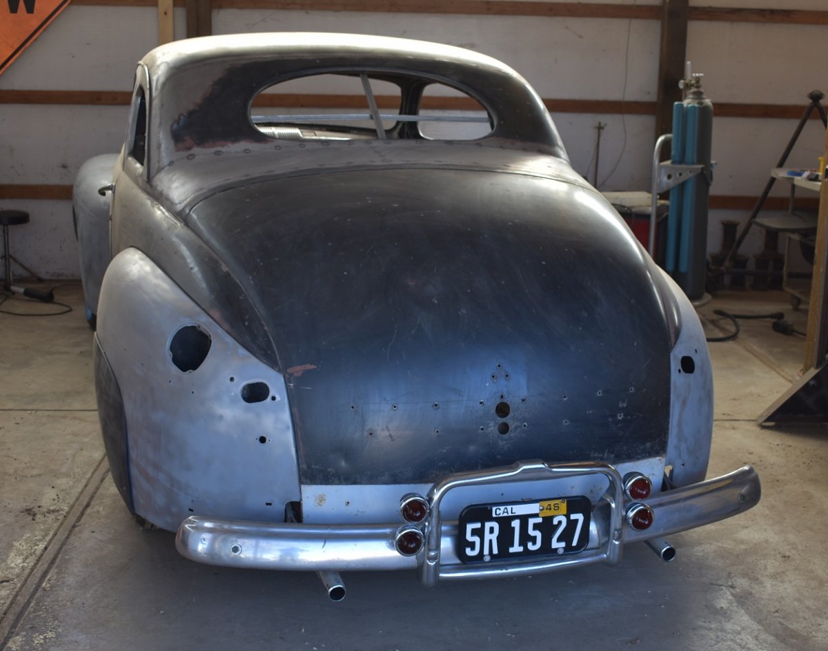

    Years ago I saw some photos of period customs with Guide B-31 style tail lights mounted to bumper guards in place of any tail lights on the body. I loved the look and started collecting B-31 housings. I found the red bullet lenses are very hard to come by and it took years to collect 4 that matched well enough.
    Was able to put together 4 nice ones for Howland.

    Here they are mocked up. Lots of "Super Deluxe" holes to fill on the back!
