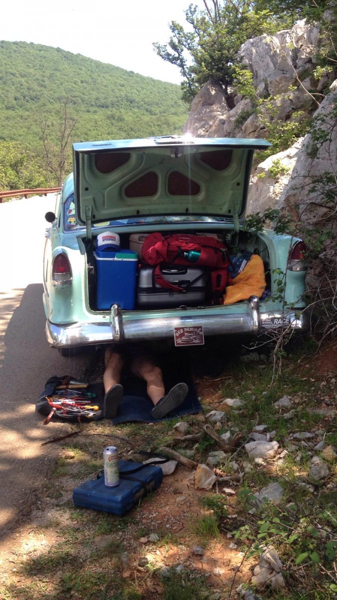

    image.jpeg image.jpeg image.jpeg Being the roadside/ shade tree mechanic that I am , I found myself a proper croatian car lift (tm) and crawled under to wiggle and see... Ok, here is what I found: the pinion nut is tight and the pinion has neither radial or axial play. The transmisson output shaft is tight too, but the rear seal is totally shot and I doubt there is much oil left in the Trans or OD. I won't be able to find a new rear seal here in Croatia. I will just fill both transmission and OD to the maximum and keep going. I have a 2nd 3 spd OD transmission at home, so I can keep the car driveable while I will be rebuilding this one.
    Anyway, thank you all for your awesome help and ideas! You guys a great!

    image.jpeg image.jpeg Another update from our trip through Croatia.
    We were declining a very steep hill down to the ferry to Cres island, it is an 18% slope and I had to use 2nd gear to help the brakes a bit. The noise was unbearable. So I drove down there just on drum brakes, which did a great Job btw. Anyway, first chance after the ferry I found myself another croatian car hoist, pulled the driveshaft and voila, the pinion was wiggling like crazy. Three days ago I did just the same but the pinion must have been in a bind or something , cause I could swear it was tight, you know I never ever screw up, hahaaa. Anyway, now that it's tightend again the rearend is quiet and smooth . Thank you all for helping me out all the time for all those years. Without you I'd be going in vacation in a late model, and WHO would want that??? Hahahaha
    I'll still pull the diff and clean out the bearings and axle housing when I'm back home, because I think there might be some shrapnel or debris considering the havoc that this thing was wrecking .Plus I'll be replaceing the tailhousing seal on the trans.
