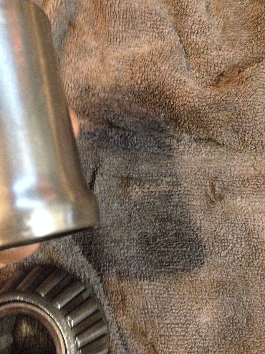

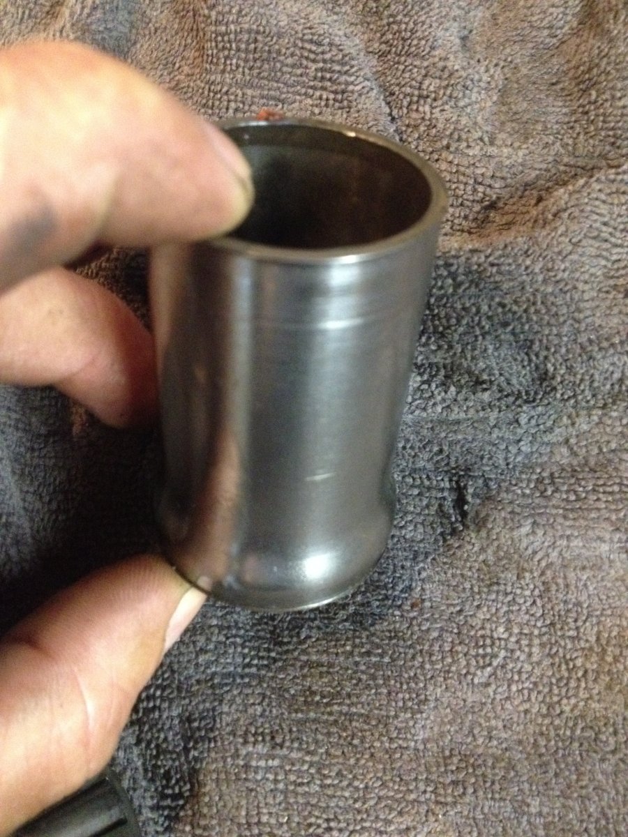

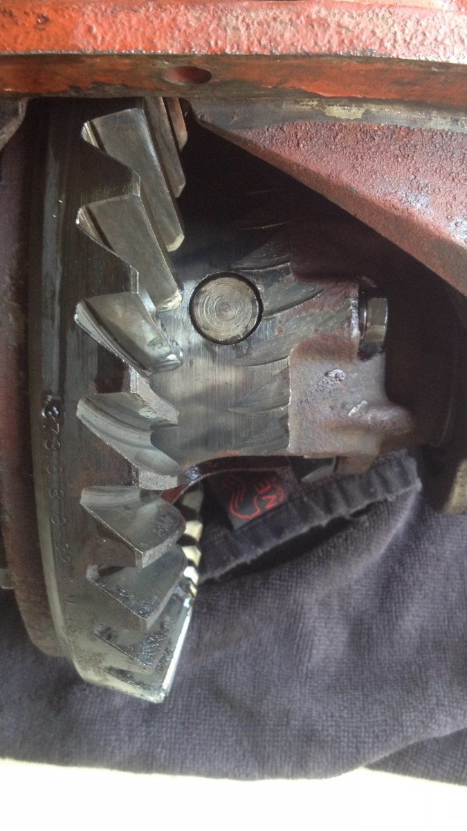

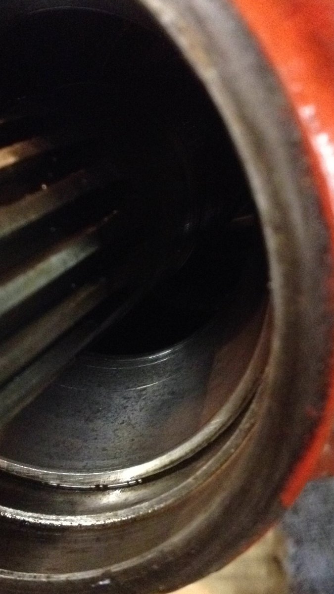

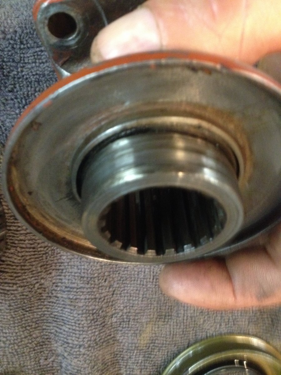

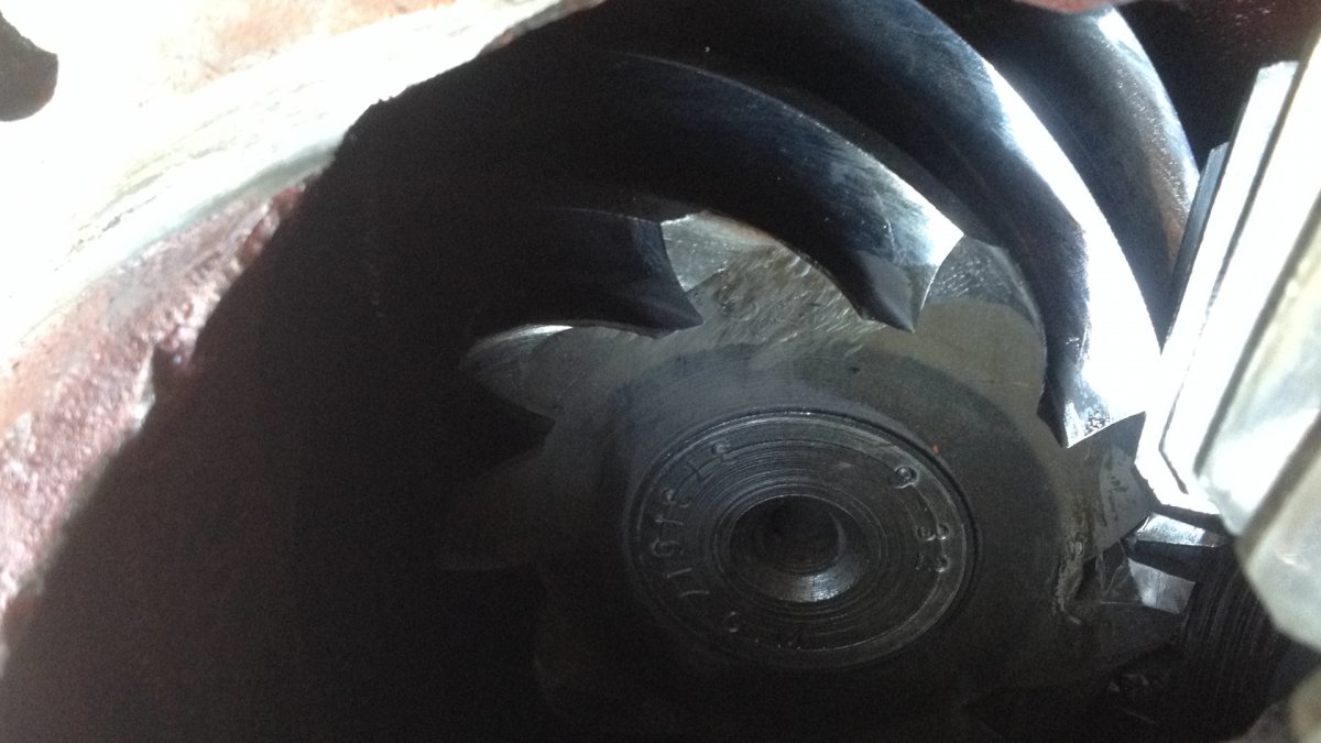

    So, after coming back home last night I pulled the differential housing to see what was going on. The pinion had not come loose anymore and it turned smooth and easily. The sleeve, the bearing and the yoke are showing some wear, but it seems like not very much. I gave the bearings and the gears a good wash in brake cleaner and I think I will repeat this once or twice and blow dry with compressed air.
    Jim, what do you think? Will a just new sleeve do it? I read a new one is 2.510". I'll measure mine. As for the new nut... The threads are clean and nice. The area on it that's usually supposed to lock is perfectly round and doesn't lock at all anymore. I would punch it a bit and use plenty of loc***e if I can't find a new one...

    New crush sleeve and find a new nut
    Since you have it that far apart I would do bearings as well, the one race doesn’t look very happy

    I always tend to err on the side of caution. It's all apart, you might as well replace all the bearings, crush sleeve, yoke and pinion nut. It's made it 64 years up until this, with a good freshen up, hopefully it will last another 64 years. [emoji6] JMHO

    @Baumi, here in the states we can get what's called an economy kit which basically only has all pinion related parts along with a new pinion nut. You should have no problem sourcing part's via the internet once your finally home. Good job keeping it alive. :)

    OK, then that´s what I´m gonna do. I found two almost identical kits on Rockauto. One with Koyo bearings and one with Timkens. I figure Timkens are the way to go, right? The kit also has an new pinion nut.

    One other check, ***emble the pinion, bearings, sleeve, and yoke. How much room is there between the end of the splines on the pinion, and the surface on the yoke where the washer fits? If there is no clearance here, the yoke is worn too far and won't be tight enough. It's not likely this is the case, but I have seen it happen.
    Beware the torque required to crush the crush sleeve....it's a lot, and you will probably need to make a tool to hold the pinion yoke, and use a long bar to tighten the nut.
