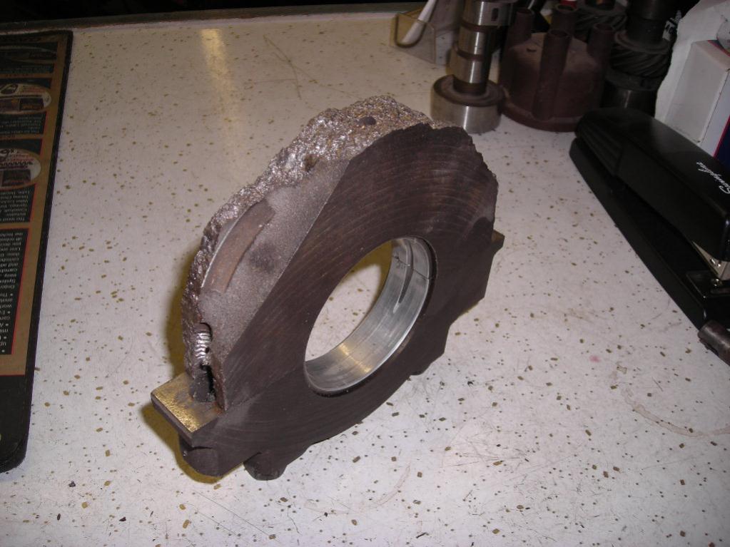

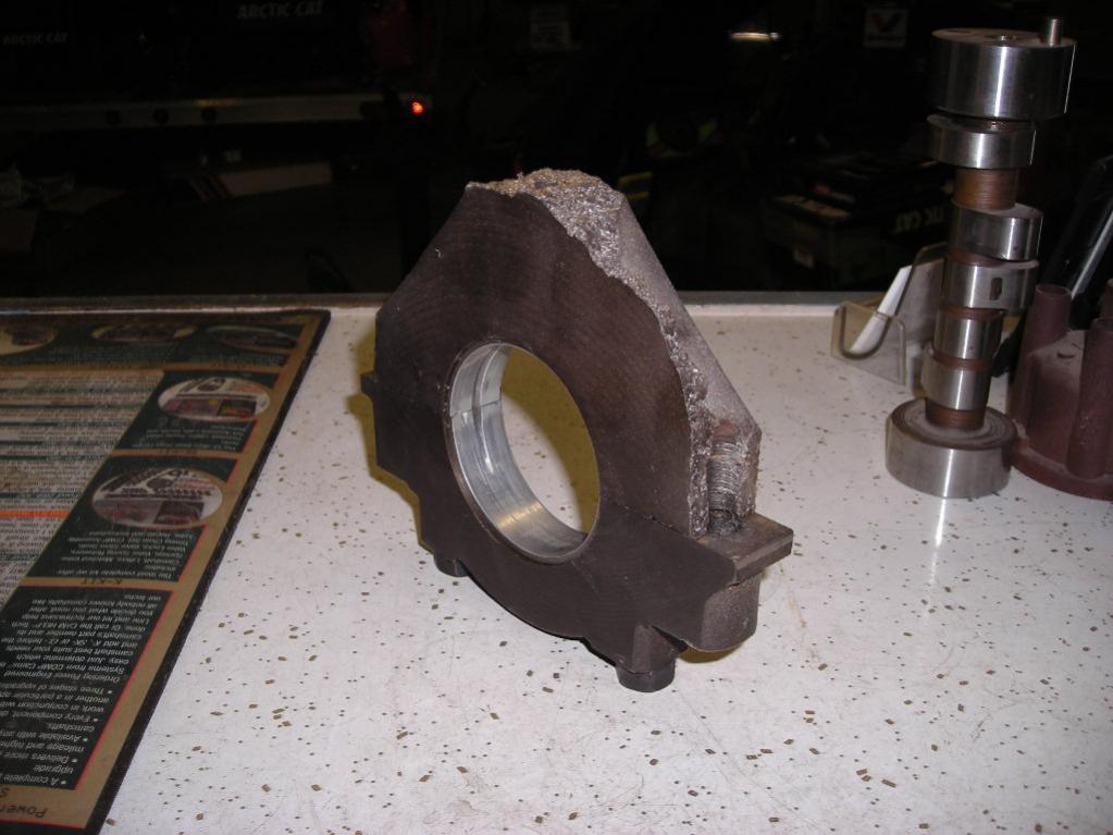

  13. Did somebody mention main bearing webbings breaking ???? I just couldn't help but to post this >>>>. 1500 posts yee-haw !!!
  14. I thought the number 1 rod was the weakest point in chev's. Farthest from the oil pump! Got two blocks inthe scrap pile where the number 1 rod let go.
