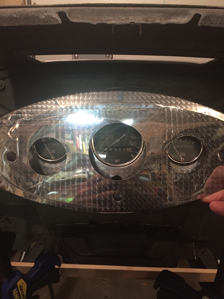

    That reminds me I was going to ask you before if you wanted a used engine turned flat stainless plate I have for your dash? I know you said you liked or was proud of your scuff job. But I'm going to go with the black painted stock style in my PU which I had bought it for.
    Here is is in front of my stock car one.

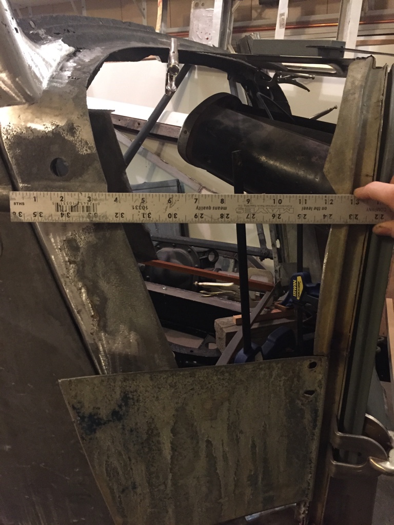

    Thanks, I knew about the band bolts. I'd appreciate any measurements that you want to take for me. Here are the two most important ones I'm looking for as a guide
    And
    I am needing them for reference. I'm not saying that these can be exactly like a 32 3w. But I certainly don't want the a average hot rodder, even traditional, to walk up and believe or notice something is off. I am ok with it being seen on a measuring device but not the naked eye.[emoji848]

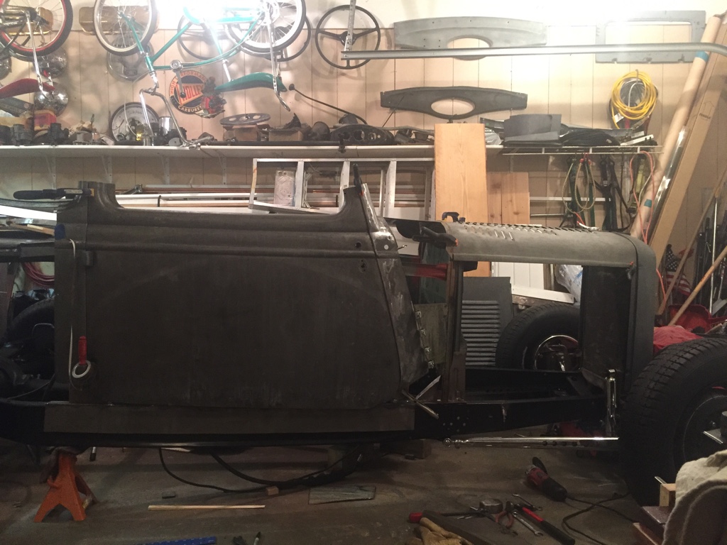

    LAKES CHOP!
    I don't know if looks like much here but I have a decent imagination. When I first set the door top on I immediately started looking for the box of chop pieces. It also looks so angled when it's not really just a tad sloppy on the squareness of the back edge of the door. But I said I want to angle chop it anyhoo. In real life I can't believe how far I have to lean over to look through the window opening! The back is is bout 7.5" of gl*** and the front before it really starts to curve down is around 6 1/4". This is at least 5.5" out of the B-pillar. So I'm way past the standard consensus on Tudor hair cuts but not never(not never?) heard of. The middle door hinge is just there to temporarily help with alignment, but good riddance.
    Here's less photo trickery
    Sorry for all the posts I'll try to cut back.

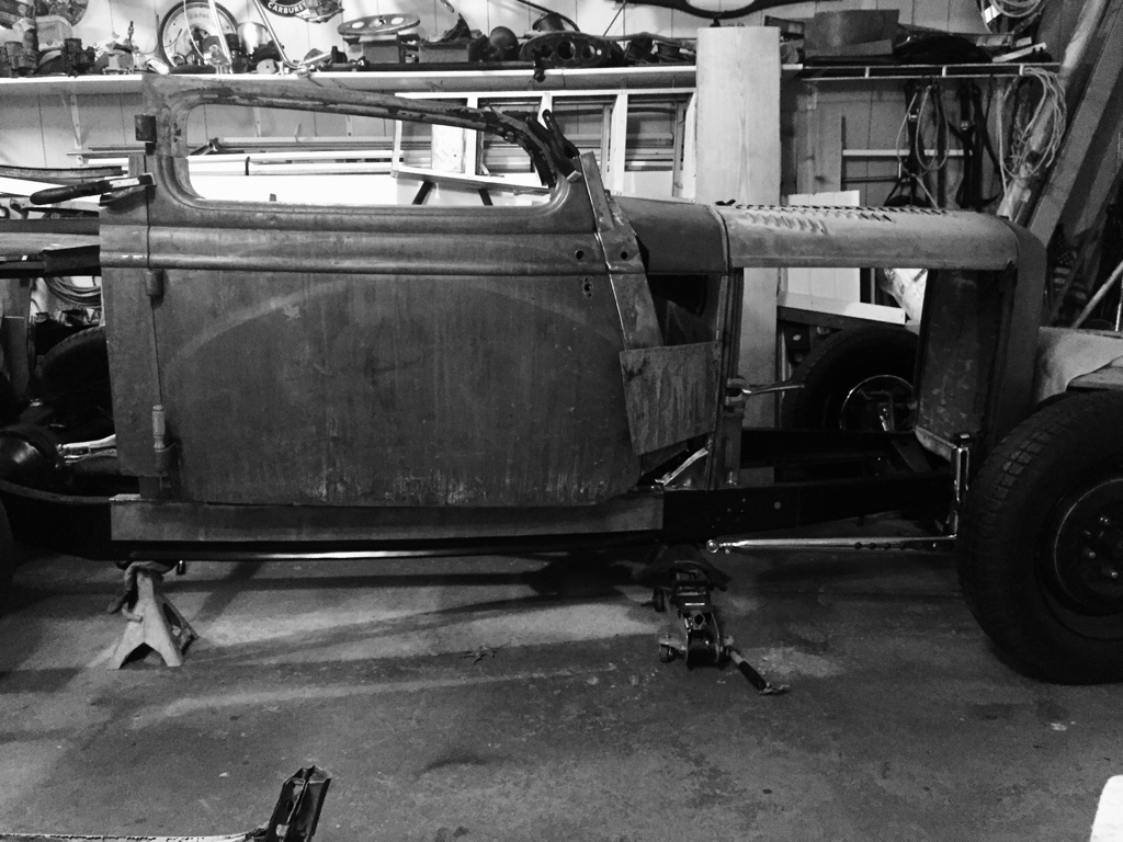

    Now please don't think for a second that I'm not fighting this thing every step of the way. I've even cut things back apart multiple times then back together again, I think.
    The soon to be famous joining of 34 and 32, test, bam!
    Fitting 32 cowl braces and almost ready to rivet and weld
    Oh and you really start to see what being poor gets you with a re-pop grill shell. I will be tweaking mine till infinity. Lucky I have the genie commercial to gauge things off of.

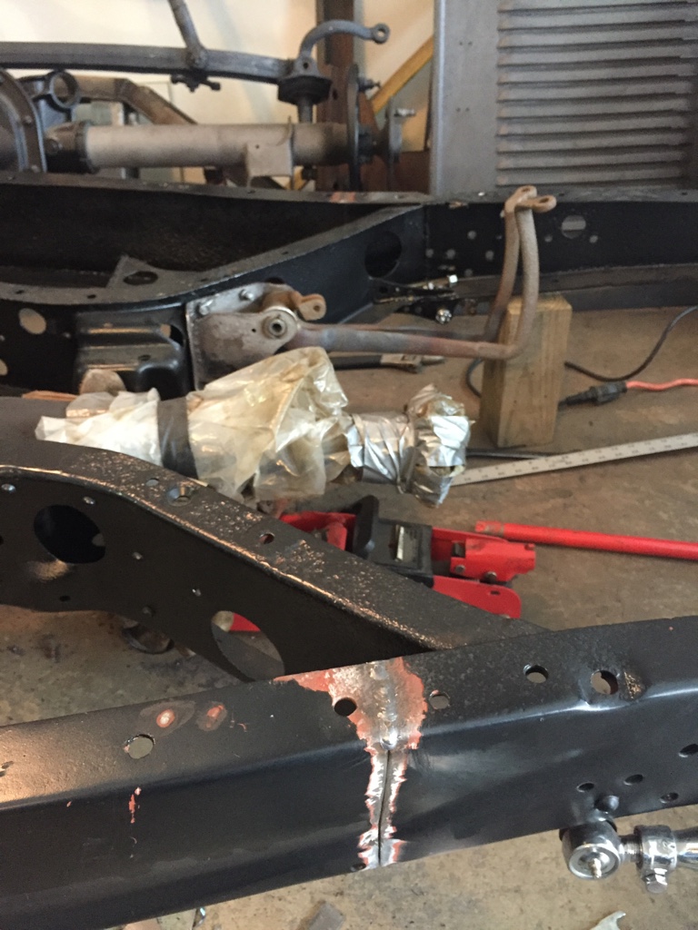

    Firewall foot shimming to compensate for my goofy rail. This points towards the problem I corrected with pie cutting where the pinch starts. More on this in a second.
    Then there's ol' Henry and not the Louis L'Amour book.
    No these two halves of the door jamb do not line up. Now, I'll be able to compensate for some of this when I'm leaning the A-pillars back but the area on the cowl edge is a little swelled out but I don't think straightening it will fix the door gap. No filler here unless lead but I'll probably leave it rough. Now this:
    This short section of belt line has been a nightmare to the point of considering completely replacing it. It will not line up with the door at all. More importantly I couldn't get it to line up with the hood or the tiny bit of 32 beltline on the cowl band. On either side of the car.
    I'm already very unhappy with the amount of gap between the rear tire and wheel well lip, even for a 40s build, and small tires. So I couldn't bring my self to lift the back of the body any higher. I also wanted the beltline to run perpendicular to the frame rails. Then there's having the rear door hinge gap be the same as the hood to cowl and grill shell gaps in squareness. So for exhibit whatever we're on:
    I really didn't want to do this but was running out of choices. I'm not crazy about all the splices to this frame but what are you gonna do with junk?
