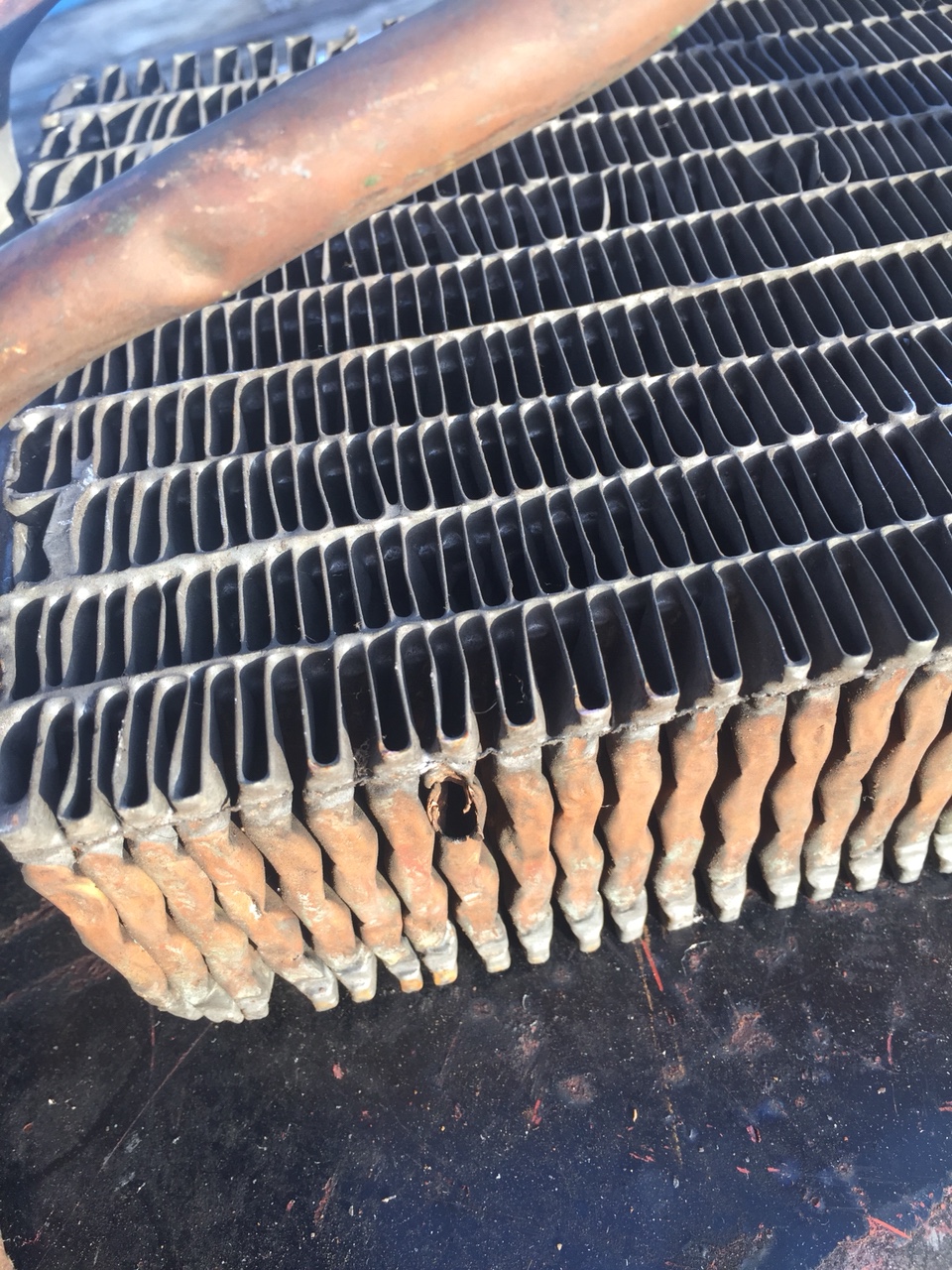

    I picked up some hammertone green the other day. So I took the underdash heater apart today.
    The core looked pretty good but someone screwed a hole into it putting it back together and you can see it leaked all over the inside by the splashy rust pattern inside the main body.
    I’ll probably look into a modern common alternative to stick in there.
    It be nice to use a way smaller fan to shrink the entire unit down. 6v may be a limiting factor I don’t know.
    And finally I think the chrome vent is a touch too ruff but a fresh finish would be well... too fresh.

    Upon further inspection the screw hole doesn’t mean a thing. Guess it needs a pressure check. It’s really clean so I can’t imagine it is original to the ***embly without having been overhauled. I wonder if the rust I mentioned is just from a seller cleaning it up or just a previous failure. I could see on the fan blades that it was fluffed on some level before I got it.
