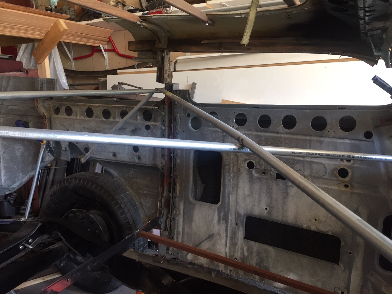

    A door width of those slots are visible correct?
  2. Runnin shine

    I had a thought to use the half of the die that pushes in and rig something up that could fit on the inside. The metal is really thin so it might not be difficult to manipulate.
    Stogy the rocker panel welds over the holes. So no they are not visible. Don’t ask why I insisted on putting them in. I also need to weld a small strip along the lower edge to make it like a L channel.

    Why You ask...to go faster...Lighter even though it's behind the curtain...You are building it in an authentic manner...that's bragging rights;)

    I was unhappy with myself when I rushed these on before to mount the quarters. I redid them this time around.
    This is not the green I will use on the interior.
    I finished the holes after a few alterations and smoothed out the weld on the corner/edge of the subrails.
    Oh and the body is back on the frame.
    I have to add on the remainder of the rear subrail portions. I also have to fabricate lower sections of the B-pillars that were rusted away to mount to the side of the subrail.

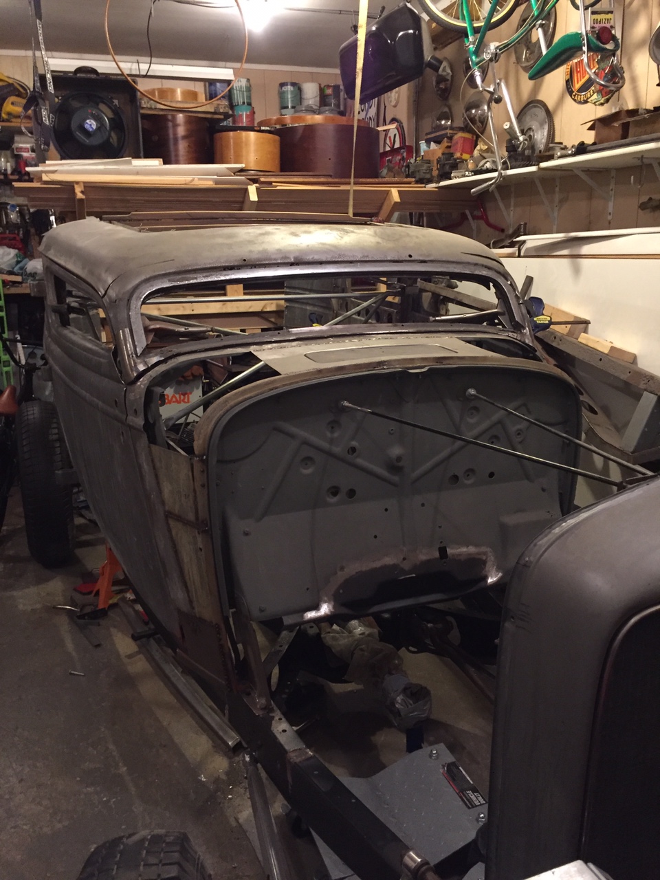

    Not the best day but did some fitting to the rear quarters. Mostly working on p***enger side with attention to the lower 32 3w patch to bring it into proper position. It is not ready yet
    I put some effort on the rear subrail extensions but paused to think on it some.
    I secretly was a smidge concerned about how shortening the quarters would effect the visual relationship for proportions of the two side window openings. Well I’m really diggin it now. I don’t think it looks as stubby as a Vicky. Before I thought it looked too stretched out with all the chop.
    Lately my thoughts have turned to feeling bad about cutting original gl*** so much. I don’t have windshield gl***. Ideally I will run across a used front gl***. It’s important to me that all the gl*** looks old.

    Just fighting metal. This is the current A pillar lean back. It is 15 degrees more than stock I believe right now. It might have to go 2-3 more. I’m being extra thorough.
    This is my hole theme in the process. I shouldn’t have did this side free hand.

    I moved it a few more degrees. Pictures don’t truly represent it well. The first position was safe and looked nice here in real life. Almost hard to notice that it was indeed moved. The new tilt is not that case at all. I may put it back 1 forward degree. I keep staring, walking around, staring, taking a break, and staring again. It makes me think of Hells Messenger with the bare metal. Luckily I have the ability to see through all the unfinished parts of header and door.

    This pic may help some of you visualize better.
    See how it looks really leaned back now. So maybe lean it forward 1 degree would be the sweet spot. I want it to look lakes racey. But I can get some of that with a angle chop as well.
    I haven’t ever got around to finishing the cowl because those big holes have help me get at the windshield body structure. After I reinforce the chop work I will fill the mess
