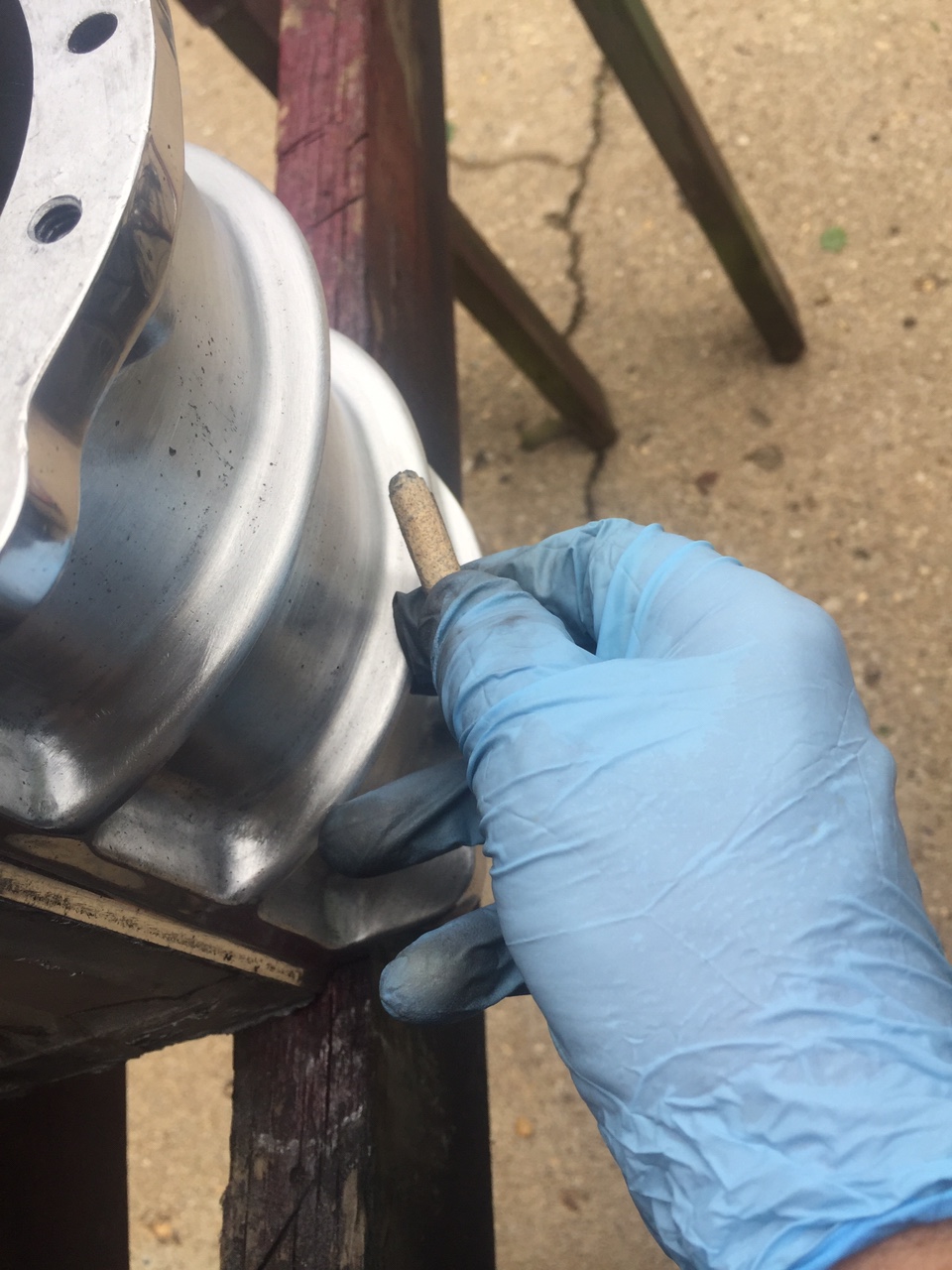

    Don’t you just hate in when you struggle with something for a long time. Then remember a good trick a the tail end of said project?
    Long 1/4” oak doll rod for sanding corners instead of killing your fingers getting nowhere. Angry face but happy face too.

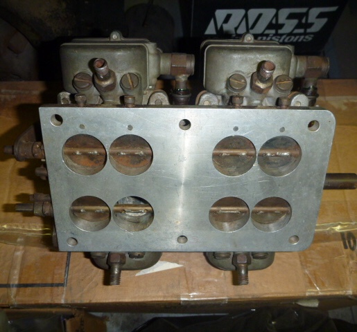

    I was just about to order the phenolic today for my carburetor mischief when I paused. Since I’m already ripping Navarro why not make it out of aluminum. Then plump it as a fuel log like he did for cooling(fight detonation) and get more power. The phenolic is a classic heat diffuser of sorts in racing and would do some good work too. Aluminum on the other hand you know I would just have to polish it, Lol.
  14. Runnin shine
    Joined: Apr 12, 2013
    Posts: 3,383
    Runnin shine
    There is a possibility I can’t get the carbs close enough together to flow straight down into the small 3-71 inlet. The Navarro fuel log/carb adapter has to angle the fuel air mixture towards the opening. I don’t think I would want to do this in the one piece carb base/throttle body part. So it might get a AL base then a phenolic adapter.
    The one I’ve shown you guys is meant to fit a 4-71.
    But check this cool detail out. Notice how there’s only mixture screws on one side.
    One good news is the carbs do fit over the inlet width wise. It’s just lengthwise that is gonna take work. But with the one piece base I can get them much closer than Barney had his 48s in the last post.
    It’s all gonna be so frick’n cool.

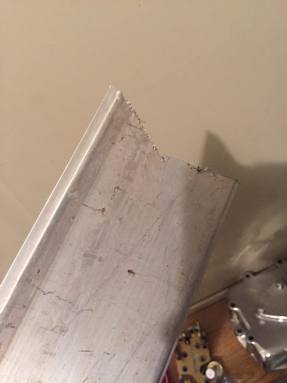

    Big long strip of extruded aluminum. Sharpie out a couple circles.
    Cut out then sanded to similar shape, it took a fair amount of work to get the beveled parts off on edges. Sorry they are not perfect circles.
    Spend a lot of time trying to put this 30ish degree chamfer. I thought it would make the parts look more refined and also hide that they are sloppy shapes.
    Sand, wet sand, polish by hand for the crappy look, drill holes, and try to imagine them on the machined down magnesium cover. The edge and the milled surface the bolts will go through will be shiny like these little guys. The inner cast webbing area will be the cool oxidized mag color.[emoji41]

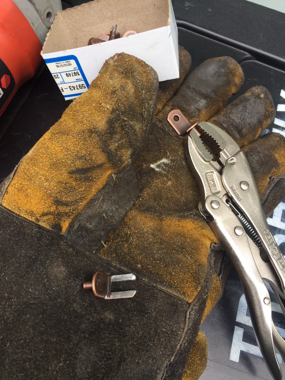

    Your suggestion works great but now I have to cut 32(seriously) of these little guys
    They hammer in nice and tight.
    Sweating them on the other hand is not got in a good groove yet.
    I paused to see if I should brush up on the proper steps. I’d like them to not come out so ugly.
    I am polishing all the shutters but then they will get a bleach treatment to turn them green and blue.
    These will most likely first thing to fail if I ever made it out to the salt flats.
  22. does it need to be soldered? maybe just prick punched to keep it from sliding out?
  23. Dick Stevens
    Joined: Aug 7, 2012
    Posts: 4,026
    Dick Stevens
    I would try tinning the angled pieces and apply flux in the smashed tube before installing the angled piece, then just enough heat to melt the solder that is on the angled piece so you can avoid having to clean up the solder on the outside

    I did put some liquid flux down in there but got so excited to try and forgot to tin the piece even after I read it on the bottle. So stupid, considering I do this constantly wiring my guitars and amplifiers.

    Yes, but its the price you gotta pay. BTW, your blower case looks awesome!

    That might ding or crush the Louver as there is no doubt a hollow space internally on either side.
    Now if that area is hidden behind the shell or trim it wouldn't matter.
    Looking back at that pic I suppose you could made a bucking bar that fit the dip in the front visible side so that you could punch the backside without deforming the visible side but then the center area of that clip is cut away to fit the louver so there is nothing to punch into...
    I know it's not as traditional as solder but what about epoxy or Ole JB? Obviously whatever the final fixing it with have to weather the elements and impacts under all driving conditions...Ahh walking a mile in a auto engineers shoes...it certainly can bring on some head scratching...

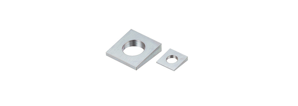

    :rolleyes:...Now in an aircraft situation if that Mismatch was encountered you would have to fabricate a contoured shim that fits both the curved surface and flat surface allowing you to torque things up without allowing distortion to either unit to maintain the component integrity. You could also fab or source out 2 separate contoured washers which would also work just fine and probably be easier to make...You don't want too small a washer/shim either due to the support it is in charge of and as close to the dia. of bolt is best to hold in position...by the way you can seal the washer to the latch or the seat and it will stay in one place of the other and that's a bonus...
    In machining they use a goop that is mixed up and put in between those two parts to form a profile of the gap we are seeing that may aid in making a washer/shim...
    Don't know how expensive that stuff is, probably not hugely expensive but it works pretty cool and you could use for one piece profile or trim it up for 2 individual...
    There is wood, plaster or a trusty eye as other options with the latter being probably the most common as it's just a Hotrod. Once you make the washers you combine with a gasket between the shiny paint and that's the name of that tune...
    One other thing that one may encounter is the bolts may not be 90 degrees to the face of the latch where they pass through keeping in mind you don't want the bolts protruding into your ass...:D...you can also use a tapered washer there if an off angle condition does in fact exist as tightening with things off put twists and bends throughout the stack up involved...:confused:...sorry I'm long winded...
